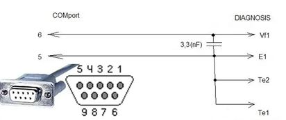

To diagnose issues like that, I would suggest you to use a diagnostics tool described below and a free software like Car Tester 8000; that will allow you to see and log live parameters of your engine. With that device connected, see if you can recreate a described issue, that should give you some useful information.
