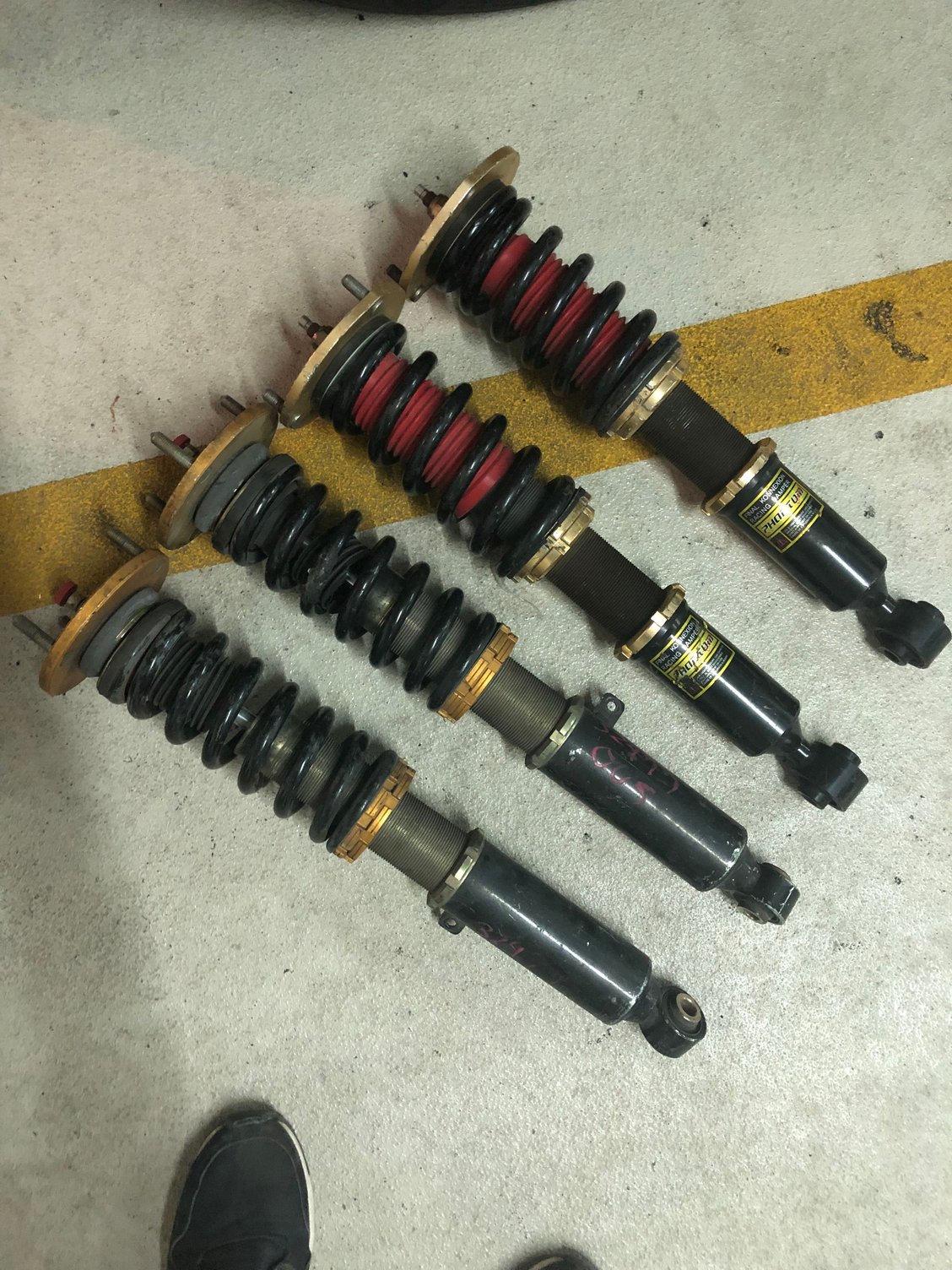

Lexy got some noname coilovers, as I managed to score them as a cheap alternative to bc racing or any other similar brand. In relation to bc racing (would have costed me about 1300usd) when shipped to Dubai, I got these pingpongs for just under 80usd, barely used. Wait did I tell that they also are 30ways adjustable?? Anyway so I bought them without adjustment tool hence I Couldn't adjust preload or height. Ride was horrible, also finally the knocking from shot rear suspension was audible, as low profile tires combined with wooden springs and shocks barely did any good to soften road obstacles. Dreamlike lexus comfort was gone.
The other day I went to market place which is about 50km away to look for coilover adjusment tool, and suspension parts. Luckily managed to find everything that I needed. Went back to garage on the same day, loosened all the springs. Someone “preloaded” all of them by like 7-8cm, so the springs were somewhat squished. I loosened them up completely and then tightened them back up by like 0,5cm. In no way this is accurate or right way of doing it. I just did something that I felt potentially could make that horrible ride better. And trust me when I say that it did, now it is tight and a little bumpy but actually pleasant on a highway. Car is so much more stable now. And I feel like I am actually in control. And yes the lexus comfort is surely gone. But this feels like a fair trade and I am happy with it (please keep in mind these are 80usd) I wouldn’t imagine better outcome from those.

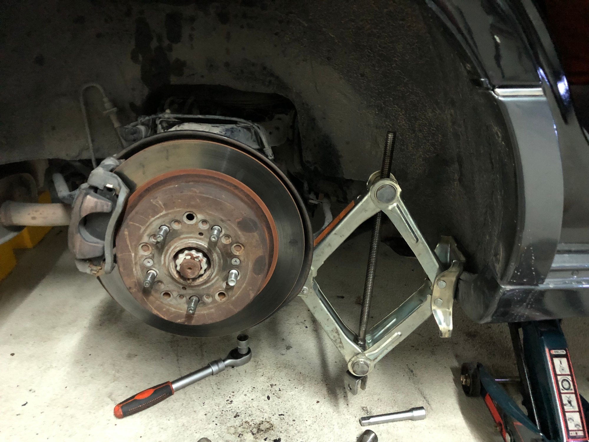

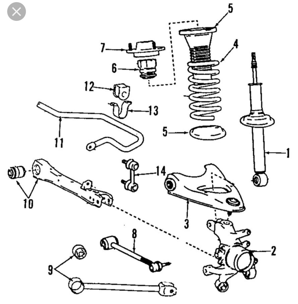

Also changed few suspension bits. Number 8 and 9 on both sides.
Previous bushings and balljoints were so shot it was actualy steering car right and left. Very unstable and super sketchy!!! While replacing part number 8, ball joint started to slip and I couldn’t tighten it up. Had to put some pressure on it therefore I had to use my scissor jack for that 🤫
When finished I noticed theres still some play when trying to move wheels inwards and outwards. Will have to change parts number 2 and 10 aswell. Silly me I could have done all that in one go... comes without saying I will have to do alignment after all this fun and games I did with rear suspension.
