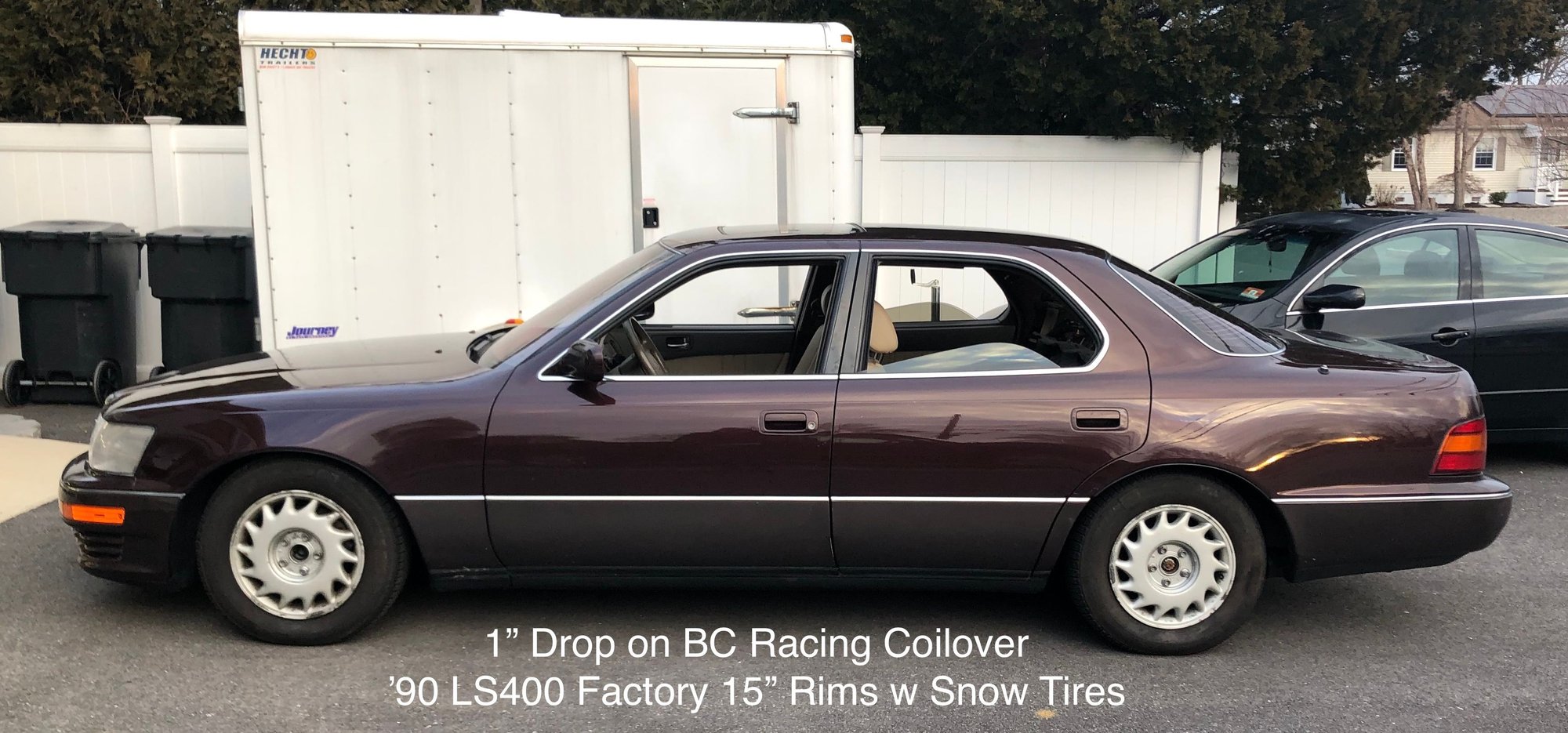

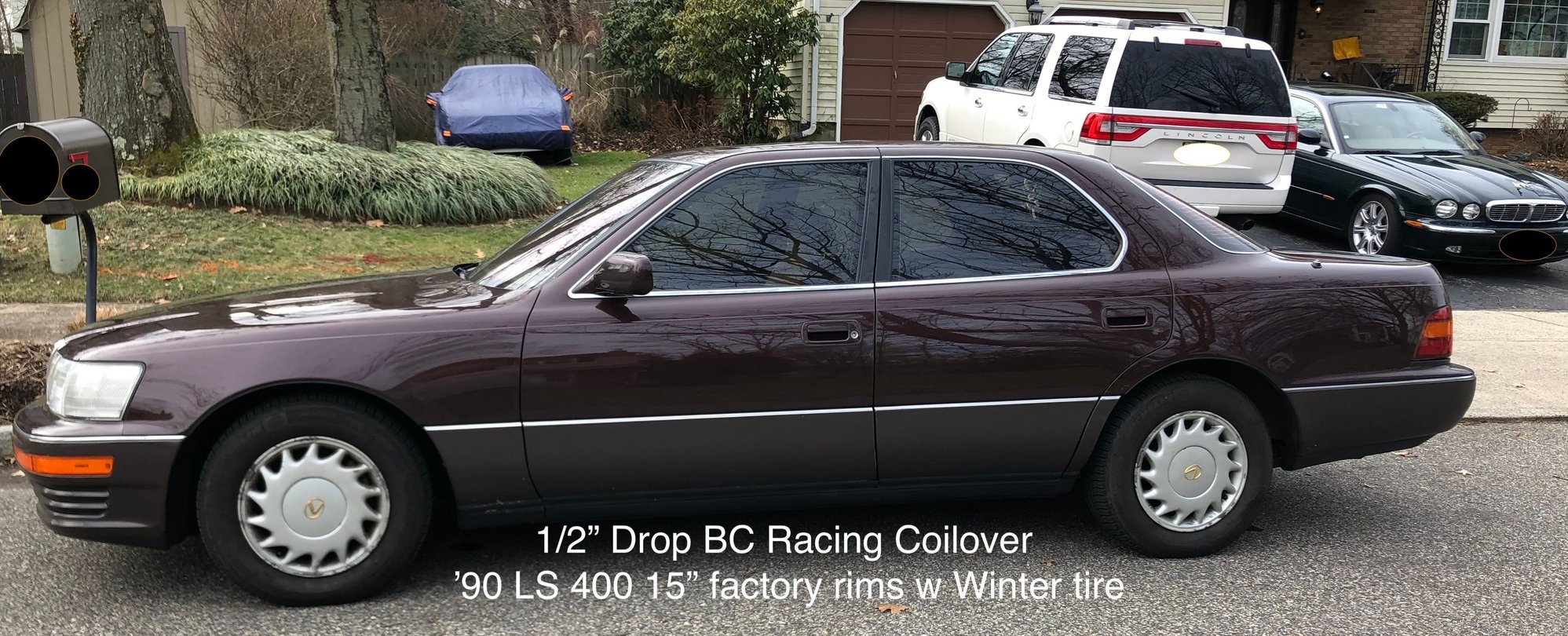

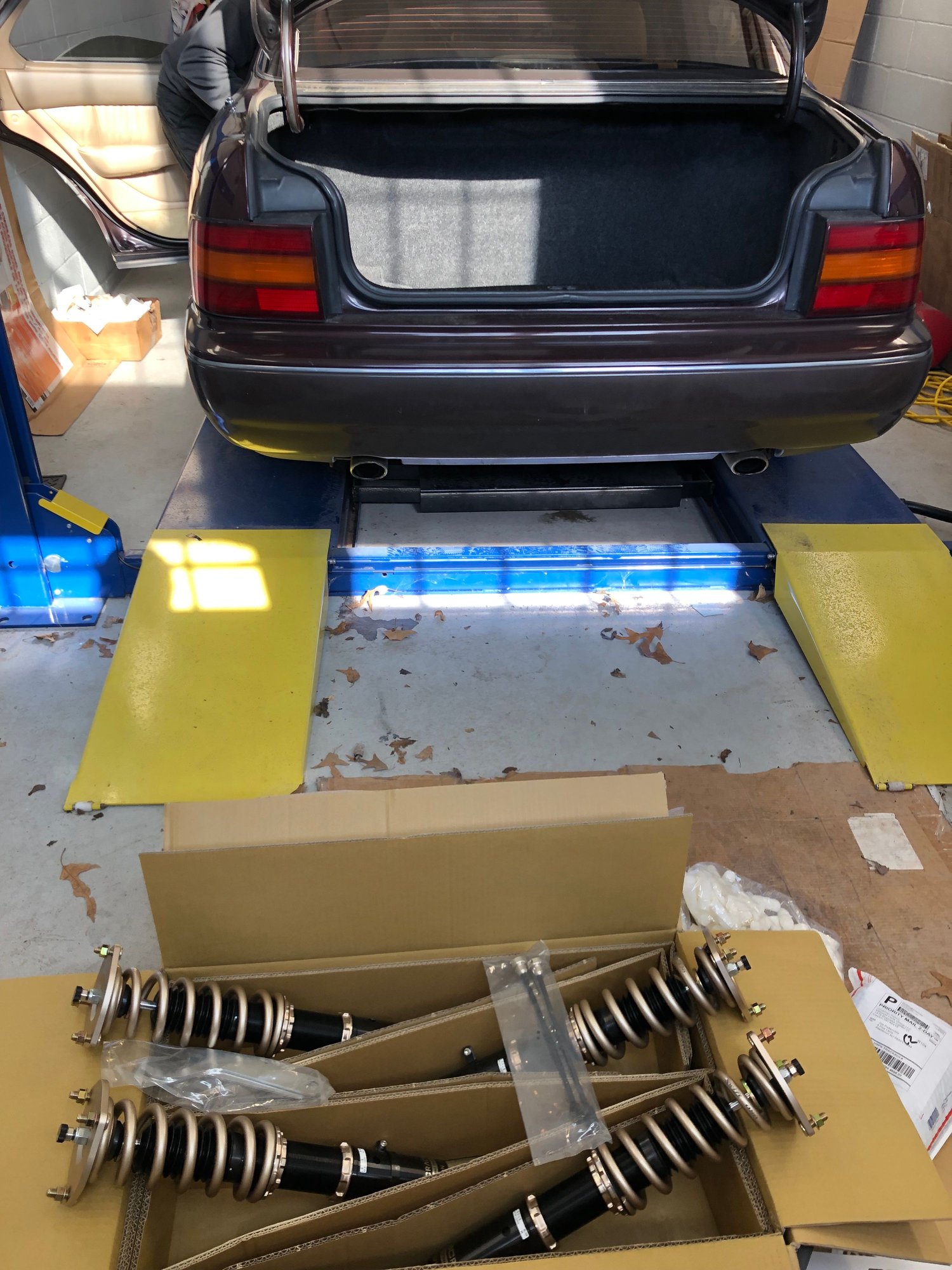

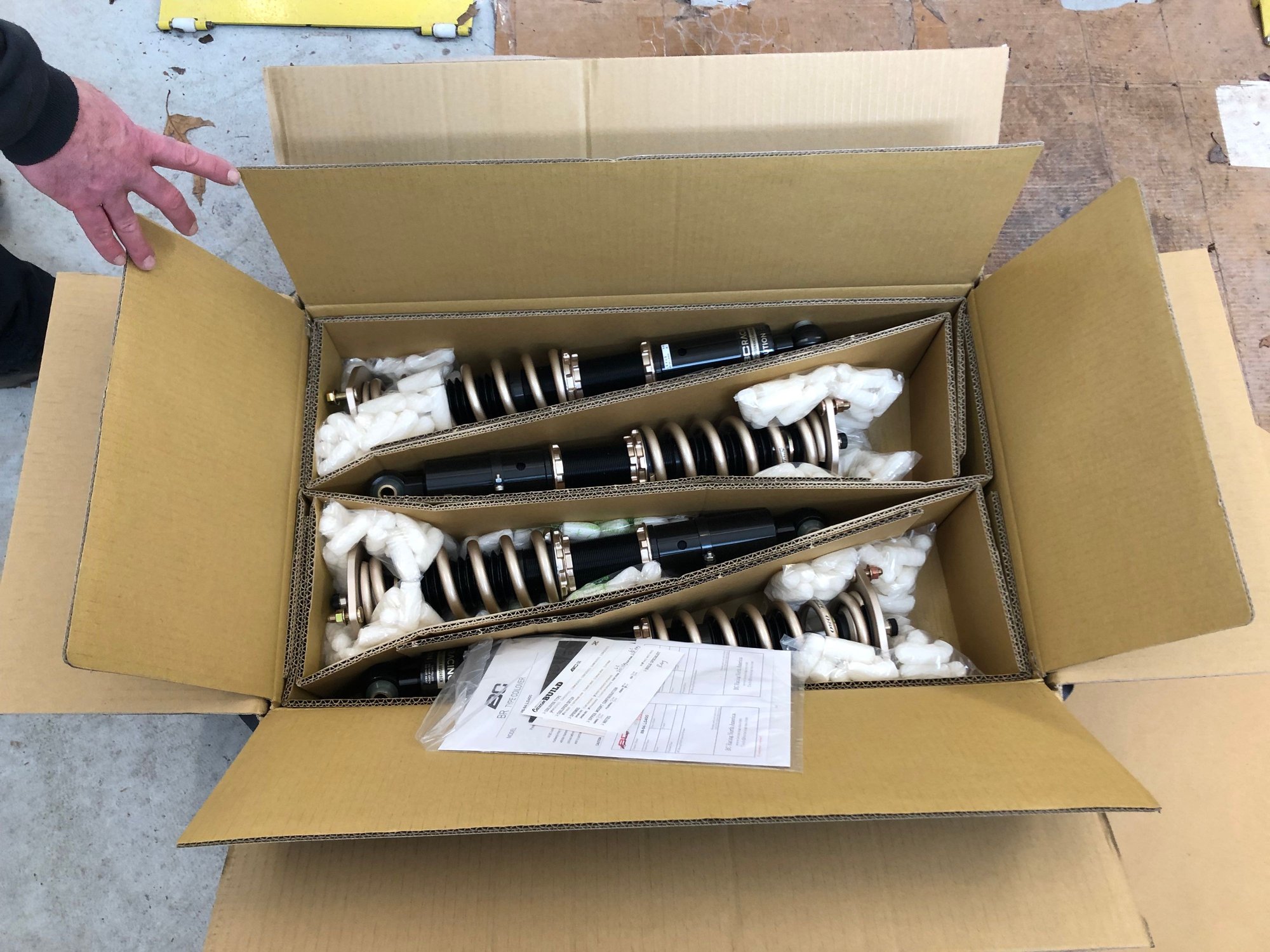

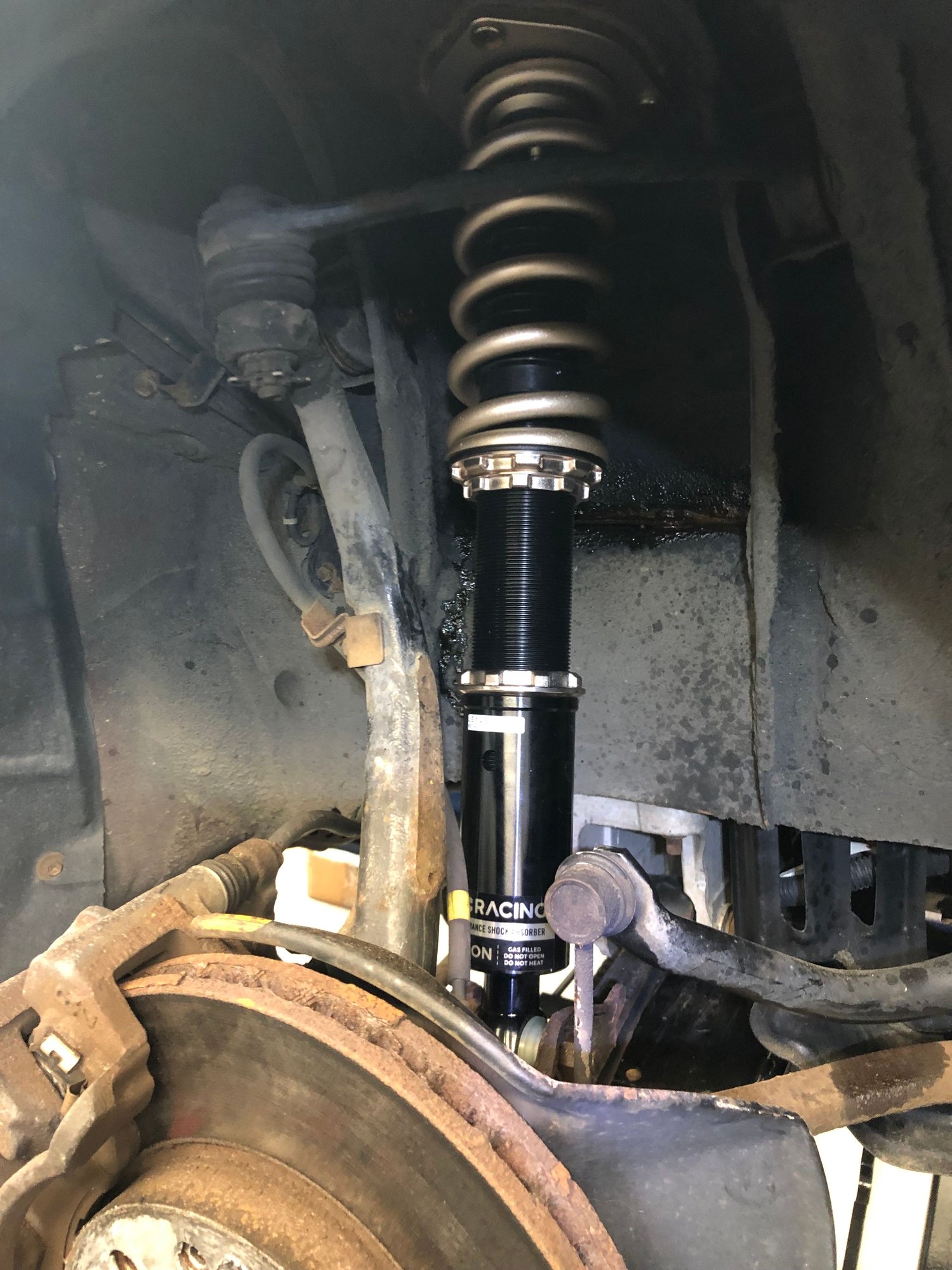

So I got the BCRacing coilovers on about 2 months with just under 1000 miles on the car. I love being able to adjust the height. My buddy who did most of the heavy work said he was really impressed as we unboxed. Out of the box they were too stiff and i almost wanted to cry, i thought i wasn't going to be able to adjust them soft enough. I'm sure the younger crowed wouldn't mind the ride at all. I driving on the absolute softest setting. But for me its kinda killed what I loved most about the car. It went from floating on heavy cream to driving on cold margin. I'm trying to get back in touch with BC and see if there are any options for softening up the ride more. It handles great but just miss the way it used to eat every bump without coming into the cabin. If what i was feeling was the coilovers w/ 17" wheels id be okay. Around town is fine, but heavier bumps at speed 60+ make me feel like I'm going to bottom out the seat spring. 80+ and it feels so sturdy compared to the float the old suspension had.
Didn't look quite right in person. Like wannabe boy racer.
Stuck with the 1/2 drop. Almost indiscernible compared to factory if you're not paying attention.
Reply 0

Quote: I'm trying to get back in touch with BC and see if there are any options for softening up the ride more. It handles great but just miss the way it used to eat every bump without coming into the cabin.
You need the Swift Spring upgrade (sport) in a lower spring rate (max 12K front, 8K rear) to get some of that cushy ride back. I plan to do the same with my FnF2's in the future.

coilovers are not meant for comfort, but for adjustability and lowering. if you wanted the softness of the ride back, you need to back to conventional strut/spring suspension.
while you still have the coilovers, have you tried to adjust the damping to "full soft" (turn the top **** counter clockwise until it stops)?

I'm saying you should still be able to use the struts you have, you simply need the sport springs instead of the coilover springs as they will provide a more linear spring rate.
HOWEVER, it still won't be as floaty as stock. If you want stock-like feel, sell the coilovers and get a stock replacement strut/spring setup.

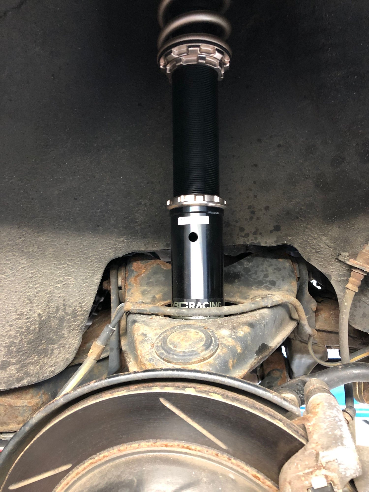

Quote: So I got the BCRacing coilovers on about 2 months with just under 1000 miles on the car. I love being able to adjust the height. My buddy who did most of the heavy work said he was really impressed as we unboxed. Out of the box they were too stiff and i almost wanted to cry, i thought i wasn't going to be able to adjust them soft enough. I'm sure the younger crowed wouldn't mind the ride at all. I driving on the absolute softest setting. But for me its kinda killed what I loved most about the car. It went from floating on heavy cream to driving on cold margin. I'm trying to get back in touch with BC and see if there are any options for softening up the ride more. It handles great but just miss the way it used to eat every bump without coming into the cabin. If what i was feeling was the coilovers w/ 17" wheels id be okay. Around town is fine, but heavier bumps at speed 60+ make me feel like I'm going to bottom out the seat spring. 80+ and it feels so sturdy compared to the float the old suspension had.
Just noticed something in the top pic above: You can't see any of the shock body in the hole, meaning you likely didn't leave enough of it in the bottom mount to be considered "safe". There should be a minimum of 1-1.5" of the shock bottom in the lower mount.
