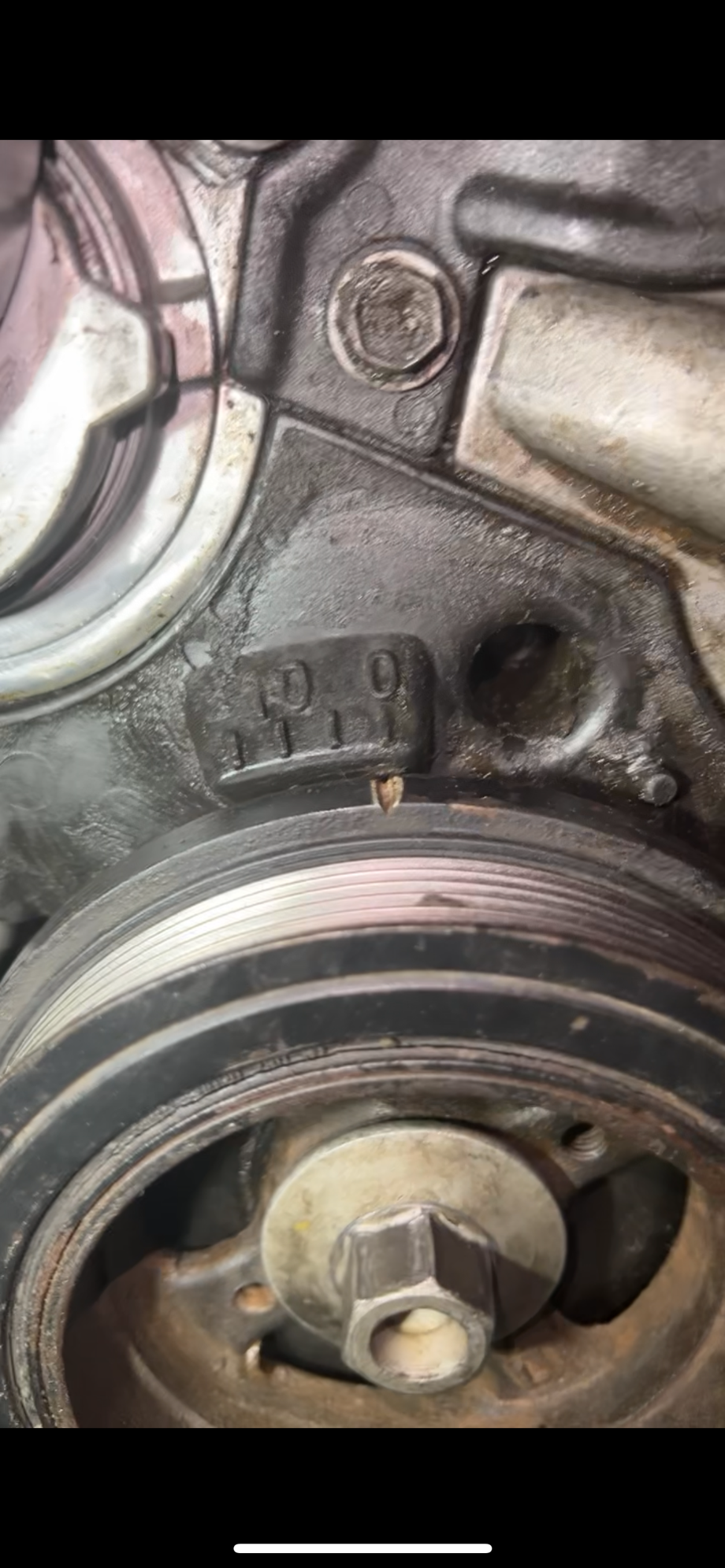

hello im gonna keep this short i recently did my timing on my 1999 ls400 not knowing it was an interference engine and i was individually moving the cams and when i try to get the timing right the cams move and when i get it right the belt gets a bubble in it and it’s tight one one side and has a lot of slack on the other i can’t find anyone having this same problem also i did not rotate the 50degrees before taking off the old belt

You want everything at top dead center (TDC) so you can install the new timing belt. Why would you turn the crank 50 degrees past TDC before removing the old belt?
I don't see the bubble you're referring to in your photos. Are you sure it's also timed correctly? There's no markings on that belt in your photos

The belt in your pics above does not appear to be new.
It’s color is somewhat faded and more importantly there are no markings on it for reference.
Its color is somewhat faded and more importantly there are no markings on it for reference.
i will get a new belt because these pictures are recent and the car has been sitting for about 3 months because i had to go out of town but i get a new timing belt and i still need help on how to get the timing correctly
