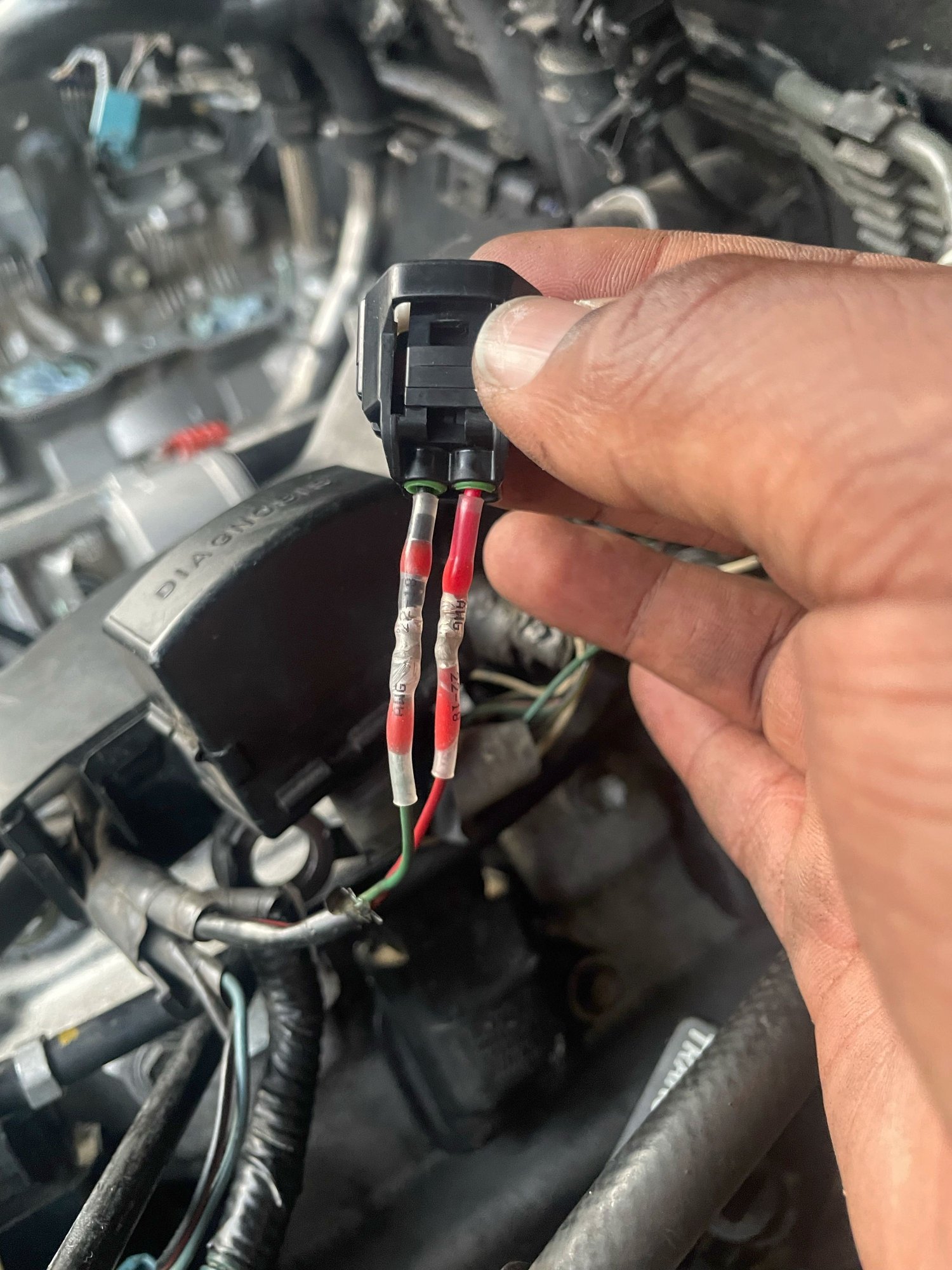

So, I bought a 2000 LS400 about a month ago and it has been misfiring on cylinders 1,3,5,6,&7 since I bought it. The transmission shifts great and the engine sounds good as well and I drove it about 30 miles back home when I bought it. Even with it misfiring, the car still performed exceptionally well. So far I've replaced spark plugs, valve cover gaskets and tube seals, intake manifold gasket, starter, knock sensors & harness and spliced some connections on other parts of the engine harness, the coolant bypass gaskets in the back, vvt solenoids, pcv valve & grommet, vacuum switching valve under the intake, vacuum hoses and every connector in all of these areas. It's still misfiring so I've ordered the proper caps from digikey and mouser and I'll have my friend who's been an electronics technician for 30 years look at the ECU and let me know what's the issue. I will update you all when I get the ECU back. Also the A/C doesn't work which could be because it has no freon, other A/C components are bad or it's related to the ECU. I believe the car also went into limp mode for a few seconds and when I'm near a complete stop the brakes seem like they're locking up then they unlock a second later. These are all my symptoms, what are yours?

as for your constant misfiring, are they the same cylinders you indicated? 1, 3, 5, 7 are all on one bank (driver side) so it might be a compromised wire on the harness. you mentioned "spliced some connections" - what are those?

Spliced connections are where I connect new wires where some have been frayed. Maybe I'm using the wrong term for it but I think you'll understand.

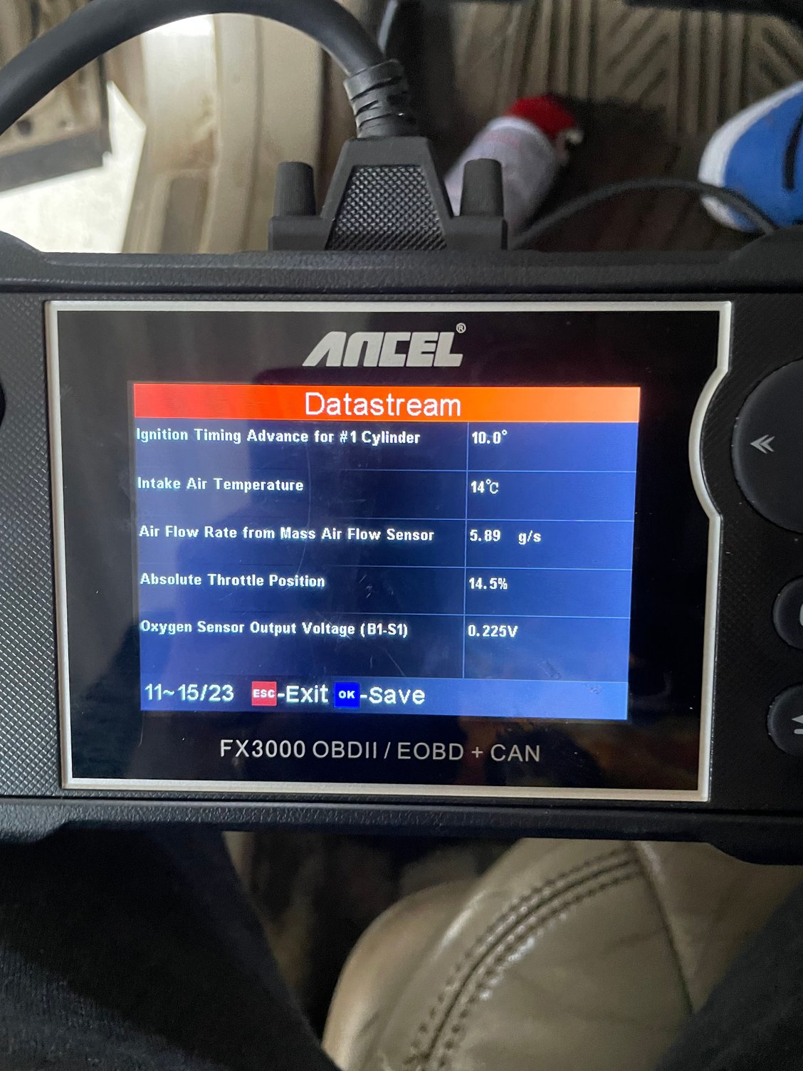

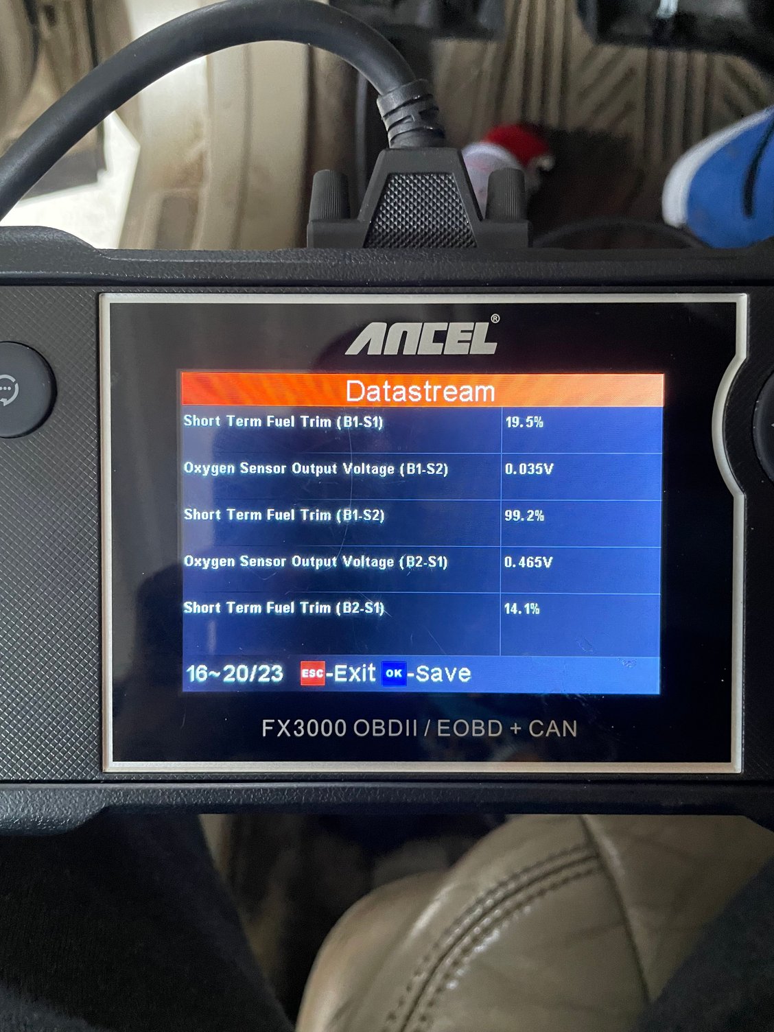

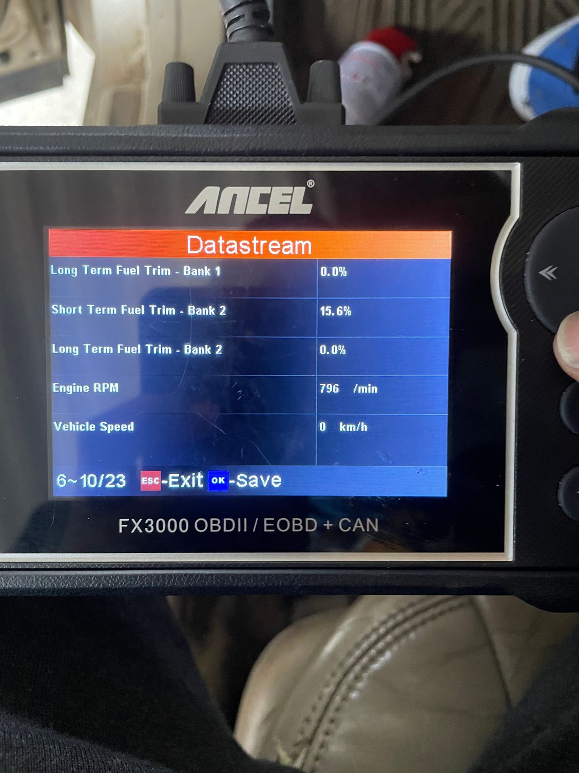

I will send the car off to let someone check that for me. In the meantime, are these numbers from my obd2 data stream ok? Do they indicate anything?

The temperature 58 degrees C is too low to judge.
