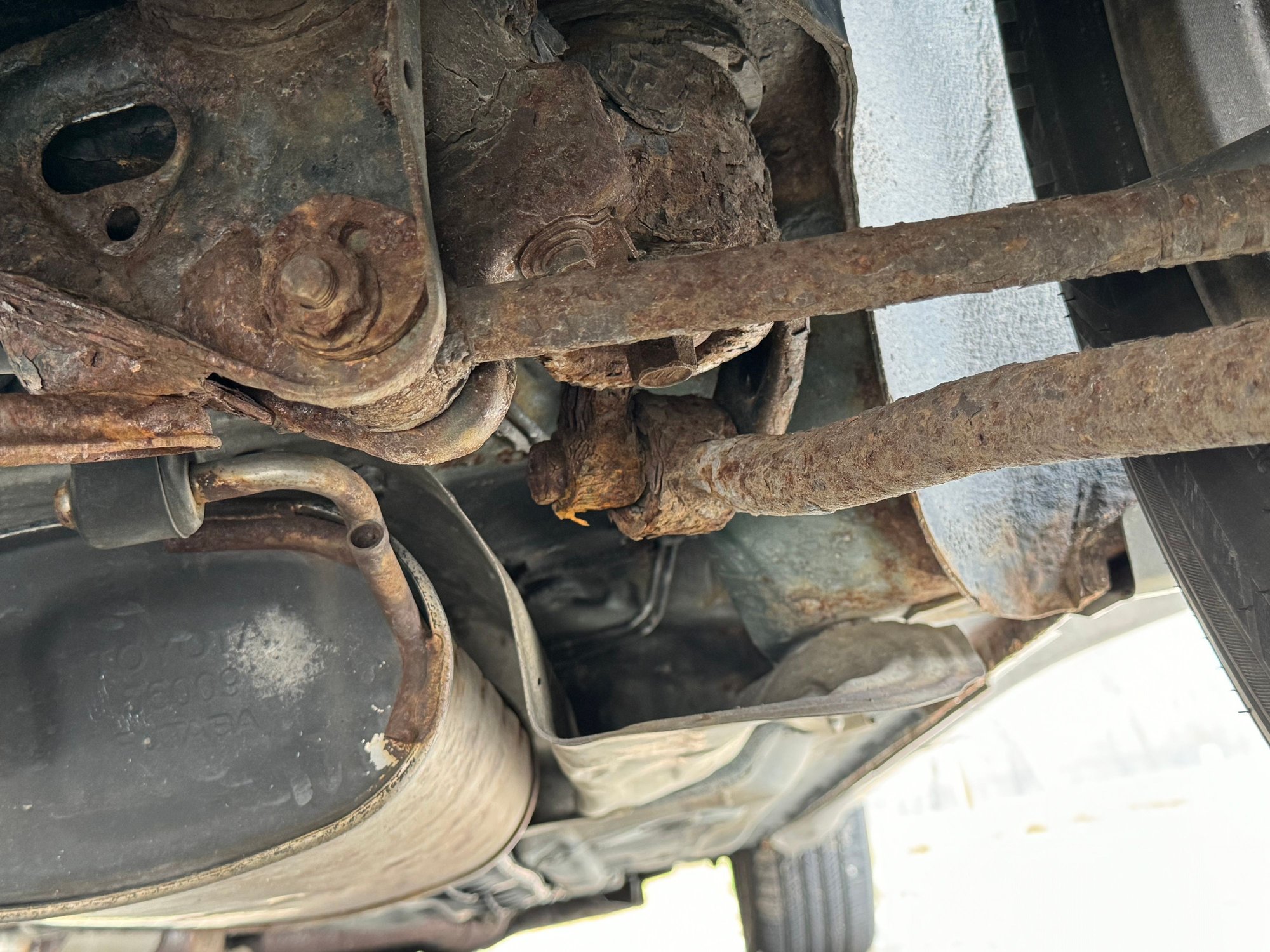

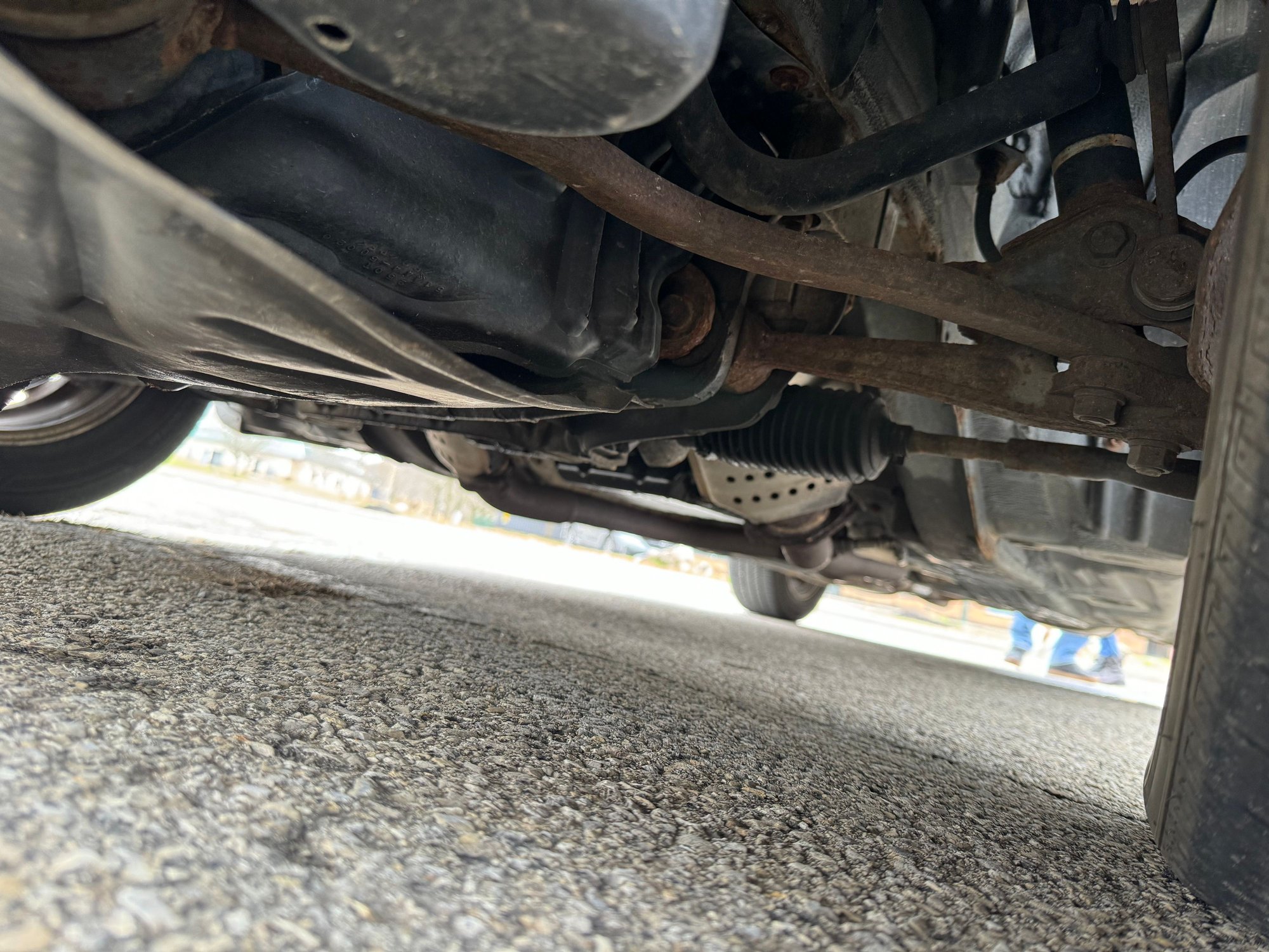

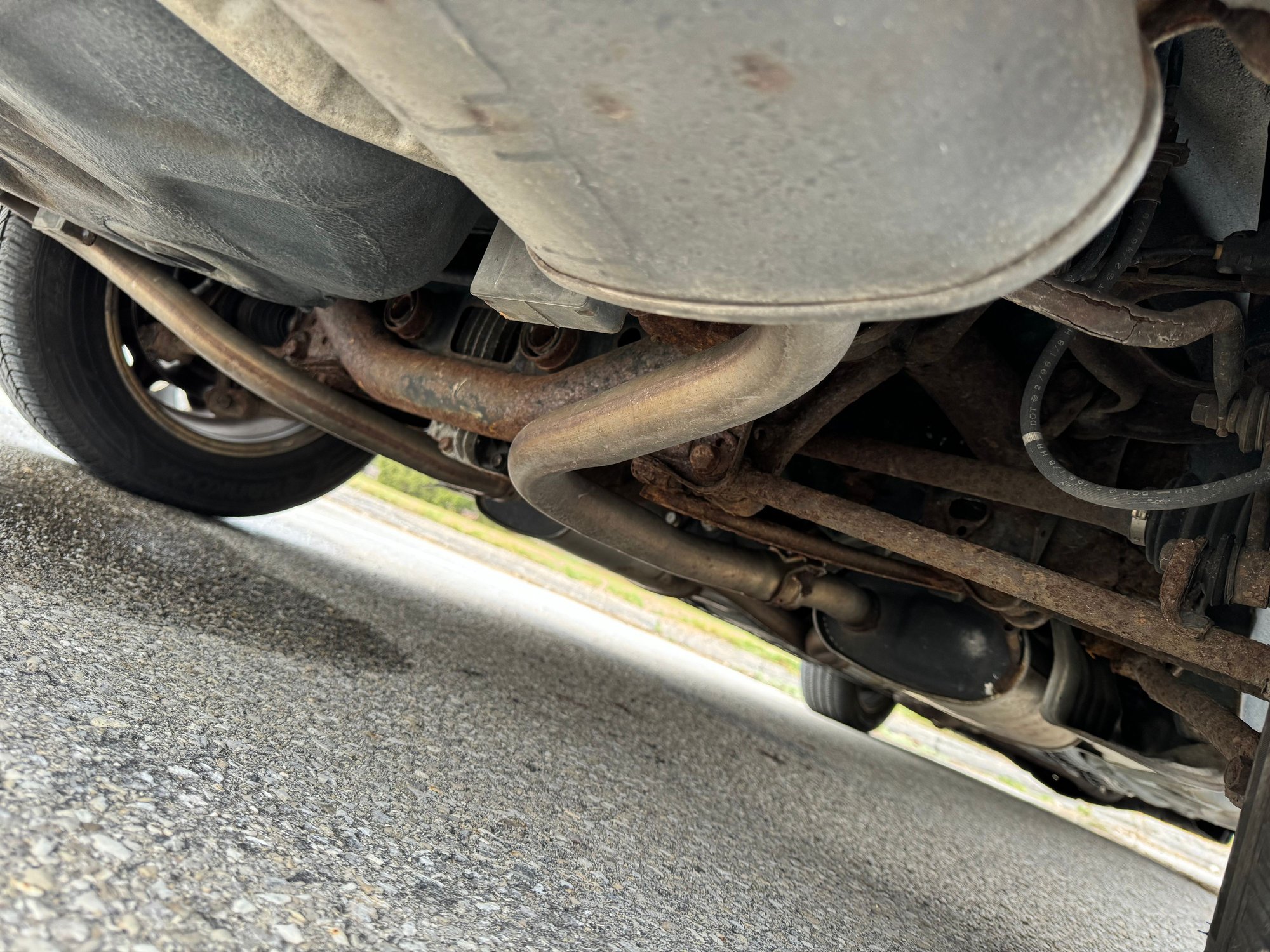

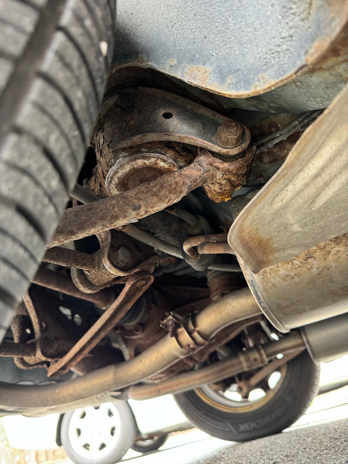

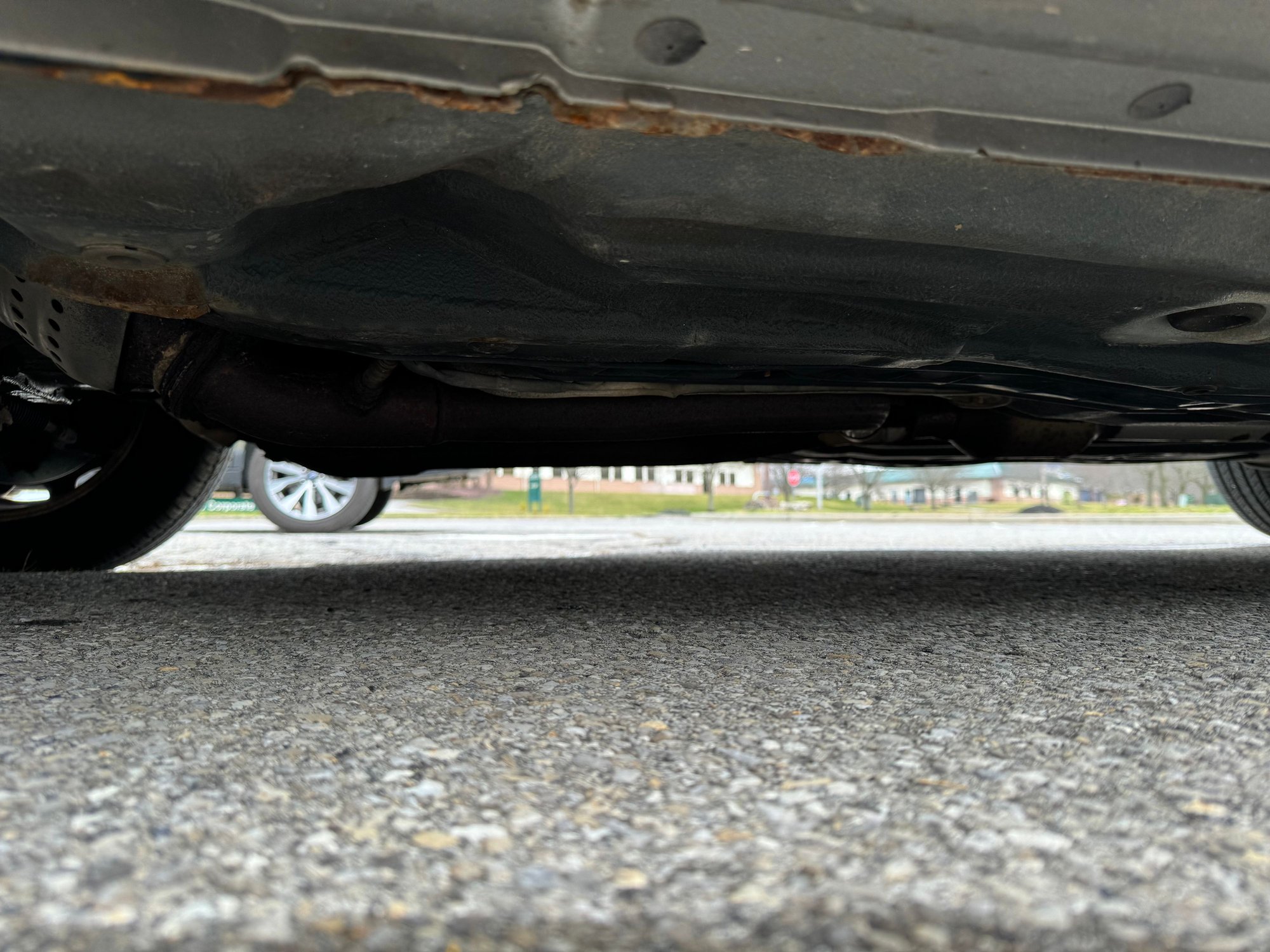

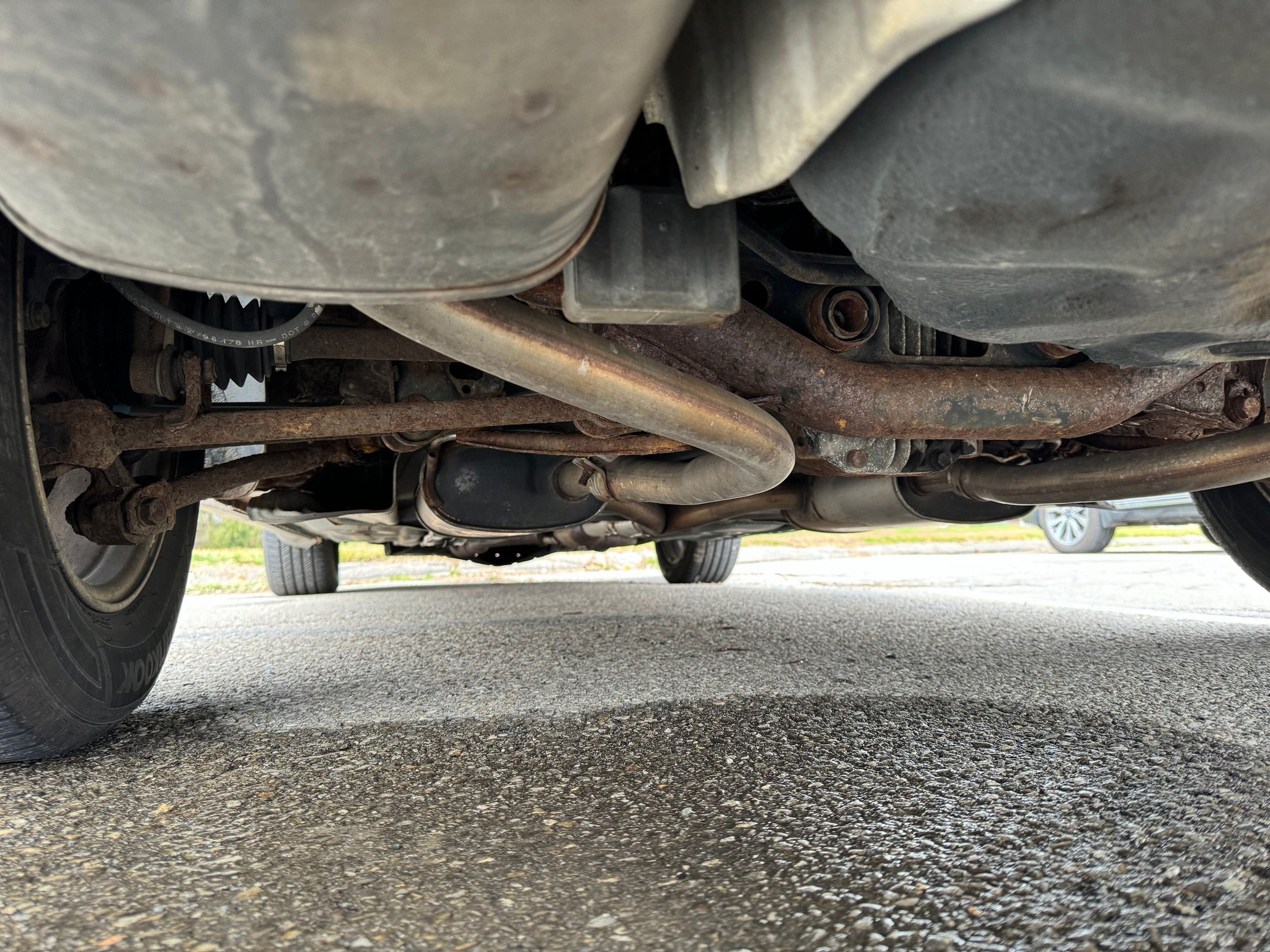

Cross posted on Facebook. Sorry in advance if you see in both places. Currently looking at buying a 1996 LS400 from the Northeast. How bad does this look? Not very experienced with rust. Thanks!!

Without being able to poke around at that rust, I would say just from the pictures it is horrible. Every single one of those bolts and nuts on the body, undercarriage, suspension etc. that is rusty will be frozen and a total pain to remove should you need to repair stuff like old suspension parts. I would not touch that car - but that is just me coming from an area (Pacific NW) were that kind of rust is only found in Canadian cars, and rarely if ever found in cars from WA, OR or CA. To my way of thinking, the only way a LS400 makes sense in 2024 is to purchase a rust free example and they do exist even today Rust never gets better, it only gets worse with time.

Thank you, Facebook confirmed very quickly I should run away from this car. Such a shame because body and paint are clean and in a rare color (green) that I happen to like. But not worth it.

What's curious to me is that the rear looks SO much worse than basically everything else. The exhaust, most of the pinch welds and front control arms and tie rods honestly look totally fine. It's just the rear multilink which is CAKED.
Overall? For a rust belt car? Not great, not terrible. I wouldn't be worried about structural rust, as it sits now. But Tom is right - some of those bolts will be a PITA to work on. But that's par for the course of any rust belt car.

Thanks and totally agree. I had a look under the front when I was checking out the engine and thought well I’m probably buying this car today. Then I got to the back and was like WTF!!!

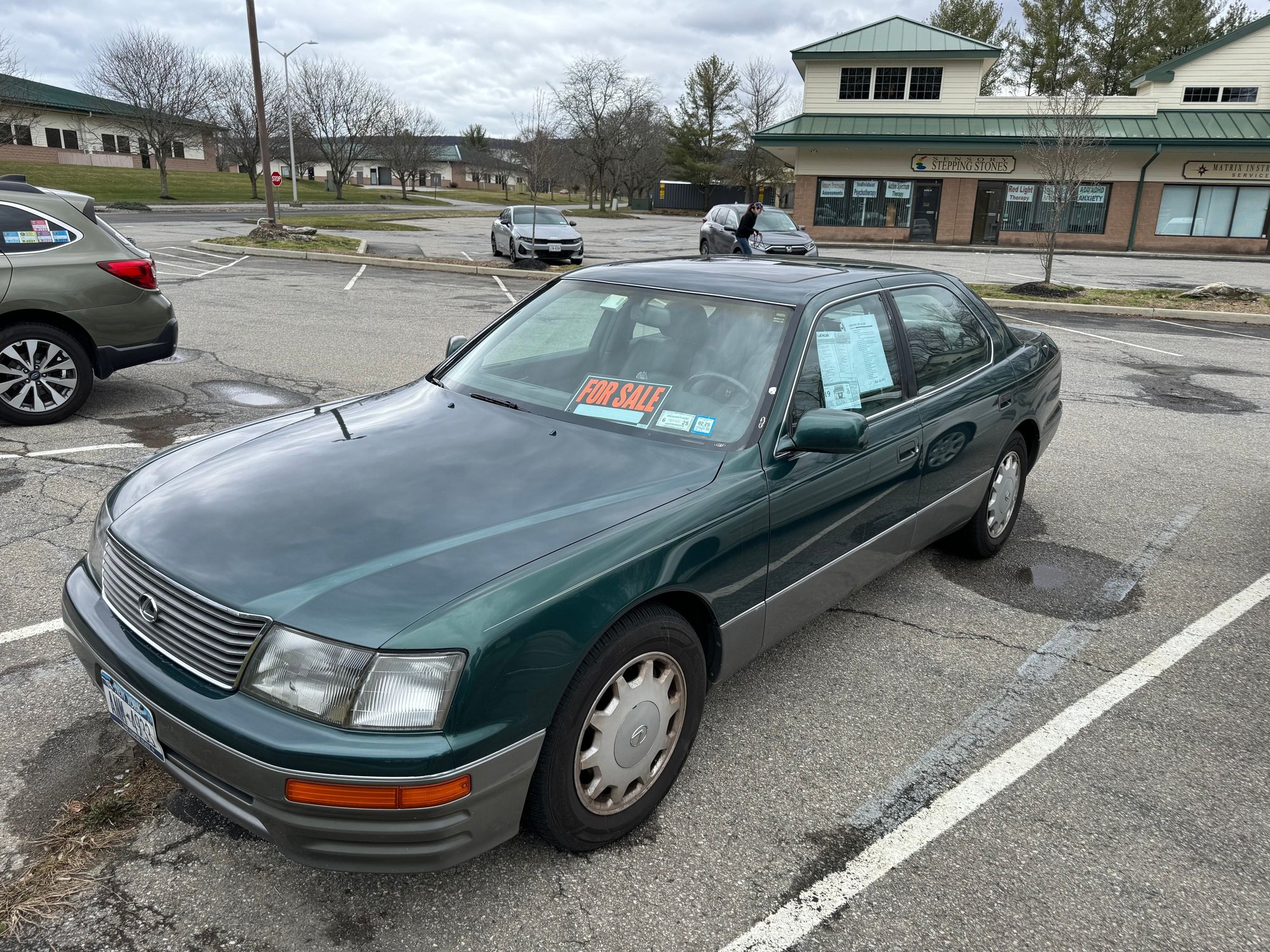

Oh you're right about the color, it indeed is rare. Just curious, what are the specs on the sale? Miles\condition\asking?

190k, timing belt due, engine bay filthy, body decent, wheels need reconditioning, interior like a 6.5 out of 10, cluster fully working though (who knows for how long obviously), all suspension original / nothing refreshed so have that to look forward to, drove and shifted ok but felt some minor vibrations at speed so definitely some things to be sorted out. Original window asking price $7k, then had listed on eBay with OPENING BID of $6250 . Received zero bids in the auction as expected.

Oh and some clear coat failure on trunk too and fading on lower cladding. Not gonna lie though that green paint overall was looking but I know it’s a matter of personal taste. And the rear underside was a house of horrors at least for someone originally from the south like me.

Yeah that price is steep for what sounds like a rough type 1 car (depreciated car driven with deferred maintenance as if it's just a normal whatever car). Plus rust belt and mid interior, I'd spot it at "needs a lot of love" for $4-5k max.
ECU probably hasn't been repaired either. Wouldn't surprise me if the tires are about to age out as well. PS pump is probably old enough to have been fixed before, but I'd have questions if it was done properly. Motor\trans mount probably not done. Lower ball joints too. etc etc etc
7k is that car, except with 140k miles and not rusty. Maybe with a slightly fresher timing belt.
11k brings you that car, except with 100k miles, not rusty, some pieces repaired, interior a 8\10.
10-15k brings you that car, except mechanically restored, interior a 8\10. Or a 60k mile car with a 10\10 interior, no rust.
