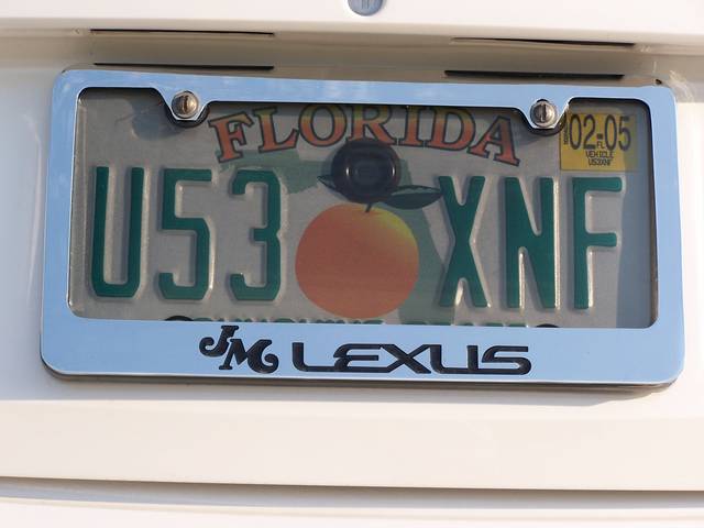

Here is another idea, only had to drill one hole and the cam is protected by the license plate cover.
