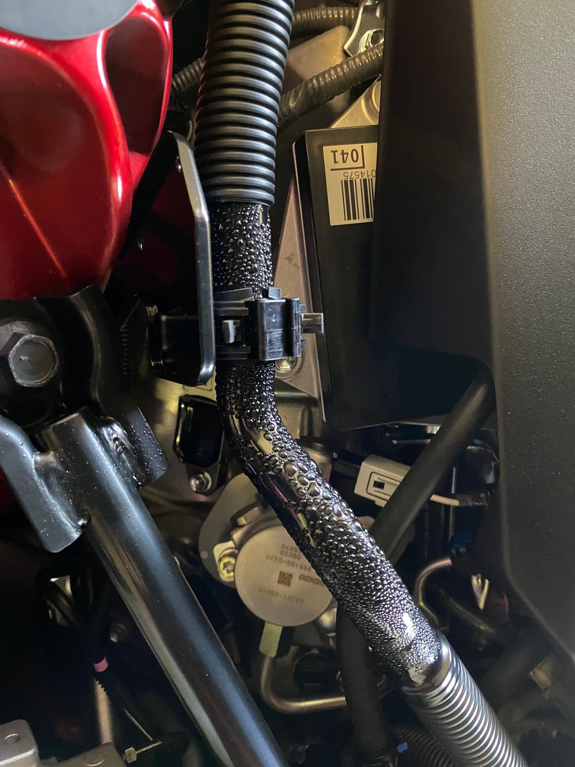

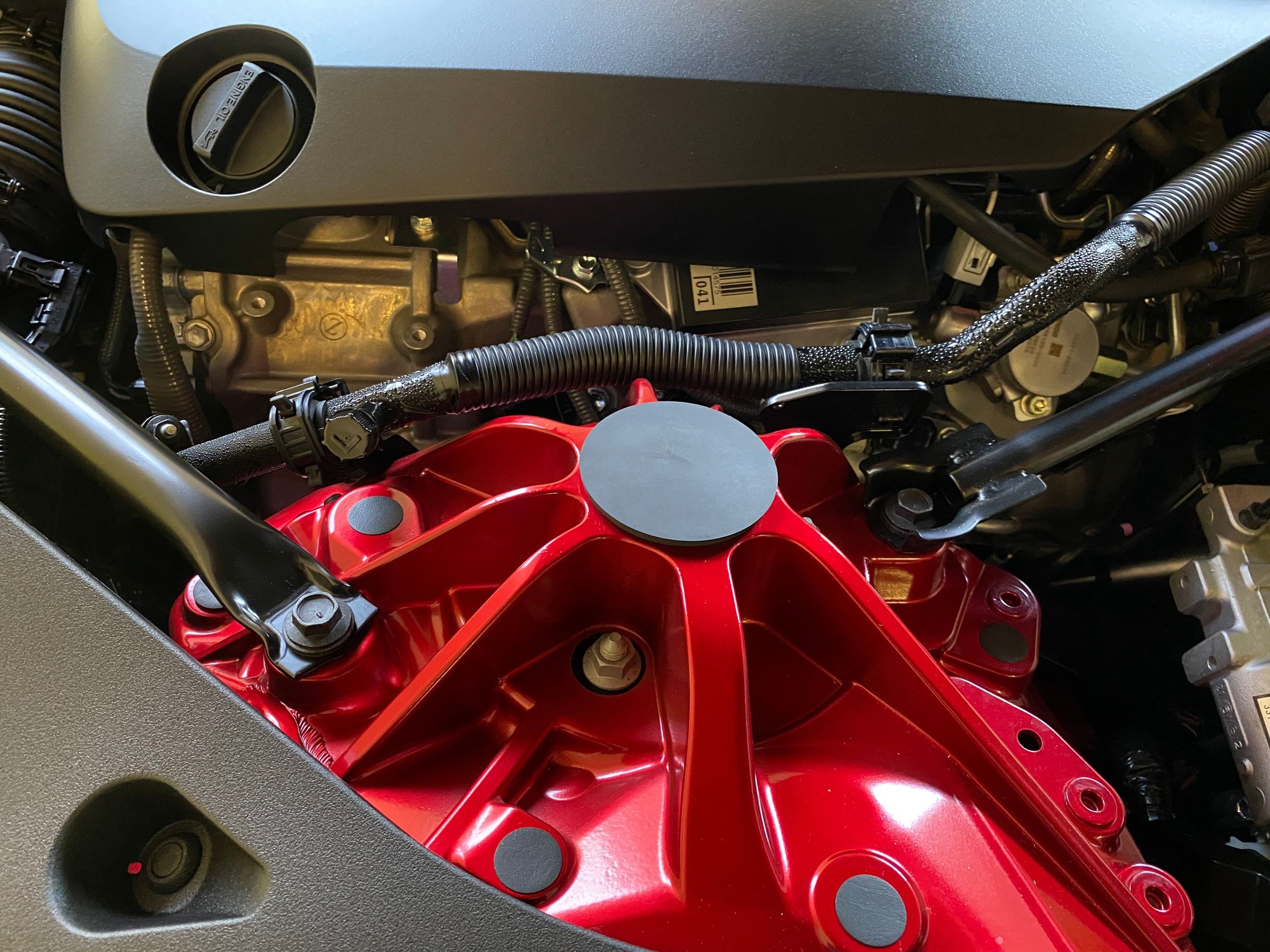

I was hoping someone may be able to please provide some feedback as to what they feel may be contributing to the issue in the posted pictures. There had been at times a few drops of water on the ground underneath the vehicle after driving, but this was in the garage today after a morning cruise. The metal lines with the water droplets on them were cool to the touch. Air conditioning was not in use if that is relevant.

A/C must have been in use otherwise how would droplets only appear on the A/C line and nothing else. I'm surprised how much there is though. Water on the garage floor is from the condenser drain tube.

Yes, It was dripping from the drain tube underneath the vehicle. I made a point of checking in the climate settings before my drive this morning that the AC was turned off.

Your AC must have been on. Either that or the car keeps the compressor running even when it's switched off? but i doubt it. I live in a hot tropical country with AC running hard 365 days a year and this does happen to me quite a bit. I reported it to my dealer during service to be safe and they confirmed this is normal from AC operation

The LC is equipped with automatic climate control. No matter the ambiant temperature the AC always operates to condition the air and provide de-humidified, comfortable air. If the outsude humidity is high that is very normal.
