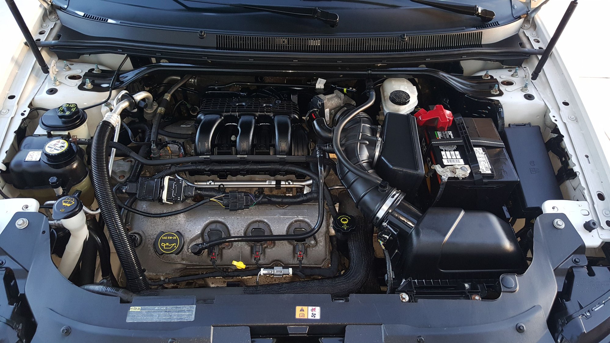

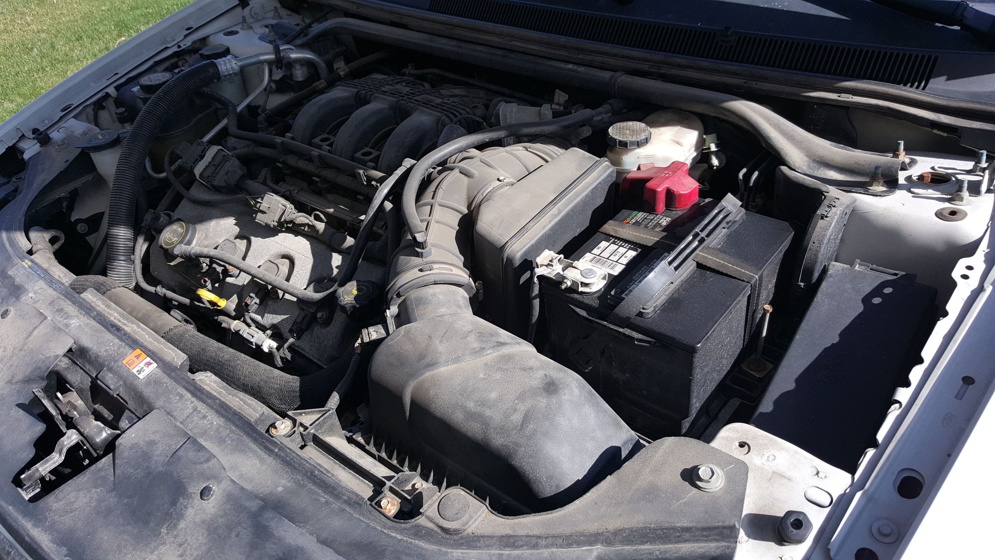

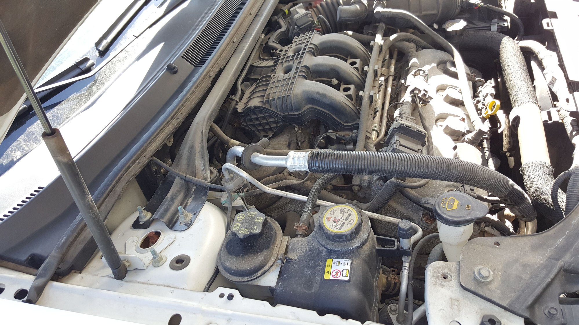

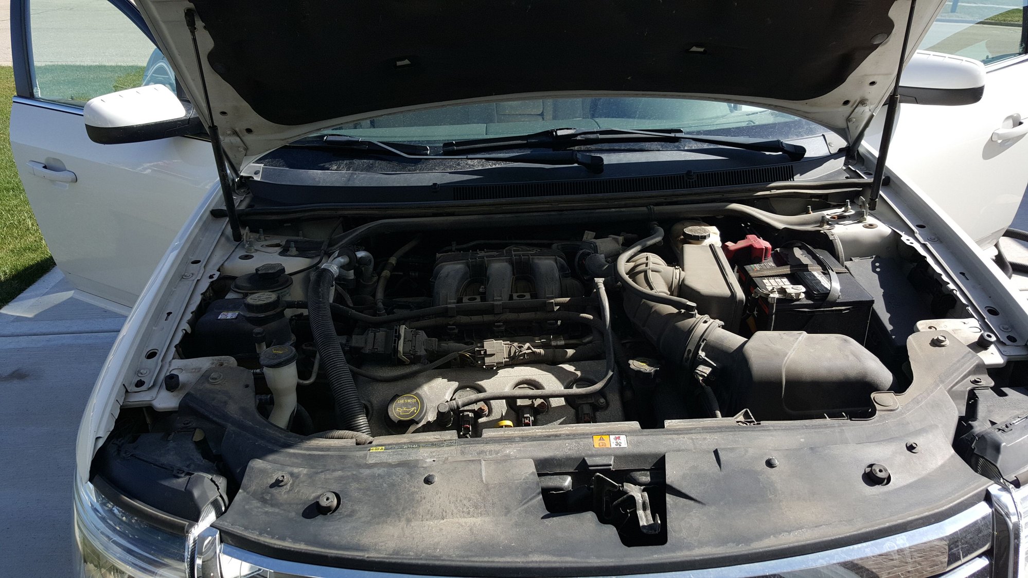

Thought I would try to clean my engine bay in the Ford before moving onto the Lexus.

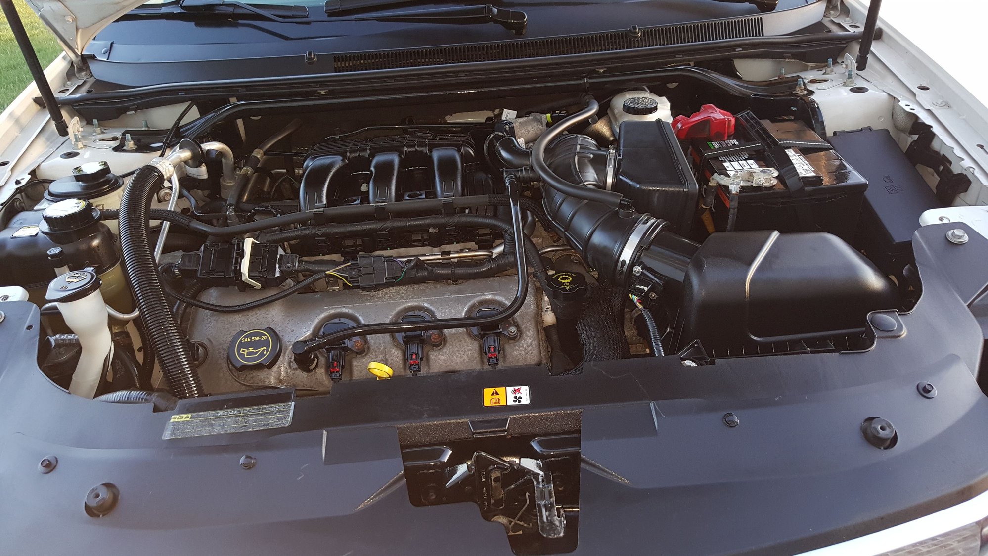

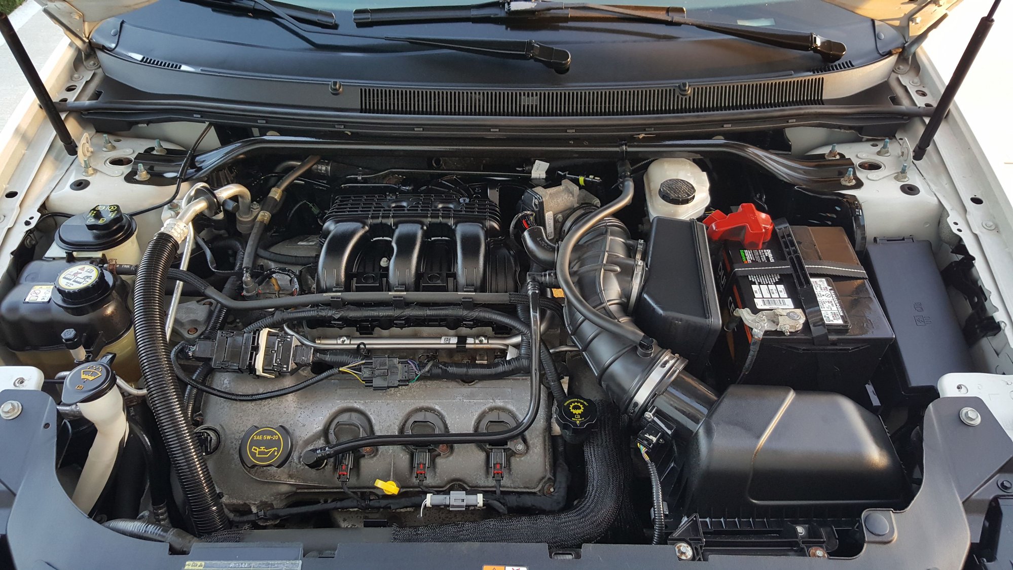

I used a mixture of 50/50 Simple green and water applied with a weed sprayer. Le it set for about 5 minutes or more making sure it did not dry. Then I rinsed it off with a water hose, blew it all off with a leaf blower and then let it dry for a couple hours. I then applied a heavy coat of 303 protectrant. I think it came out pretty nice. Definitely going to treat the Lexus the same way. Before and after photos showing how well it looks. Wish I would have been treating the engine bay this way from the beginning.
Before Photo
Before Photo 2008 Ford Taurus with 145k, engine bay never cleaned.
Before
After Cleaning with 50/50 simple green/water set 5 minutes and rinse with clear water hose off, dry with leaf blower and let it set for hour then apply 303 protection and let dry.
After
After

I have an LS and an RX that need to be cleaned. I agree with your concern to some extent. I understand that when we drive in the rain, the engine bay gets wet. The electronics, connections, etc., are sealed against that type of water intrusion as they have to operate under those conditions. I don't think they are designed to resist high pressure water or steam applications and you certainly do not want to do any of this with a hot engine bay. The rinse off with water is a gentle stream, not much different than rain. I don't believe that will compromise any electrical installations especially if the engine is cold and the vehicle is left to completely dry out before operating.
I did not think this process up myself, not that smart, but read about it on several detailing forums. Key elements, cold engine bay, no pressurized water applications and let it dry after application of 303.
