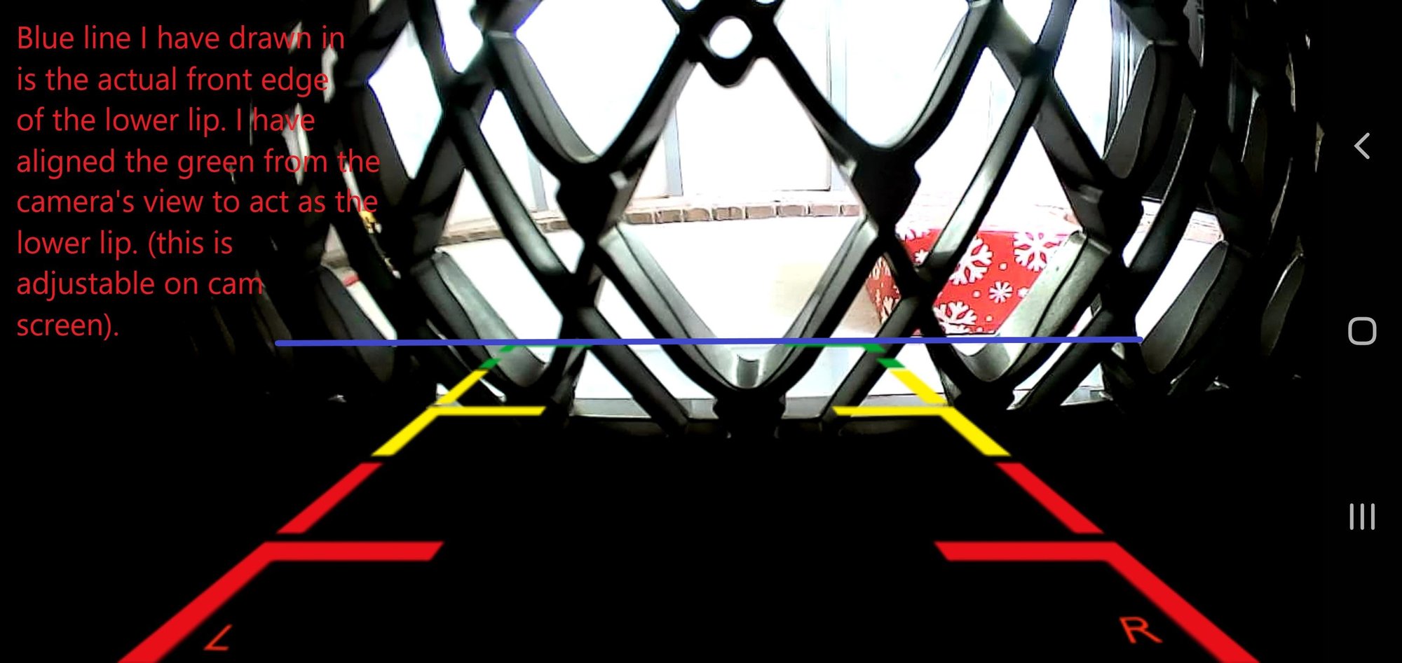

A few pics of how the front cam cable is run.

Final cam pics: fuse box connection with fuse tap, actual cam view in action, and distance I've set from objects.
