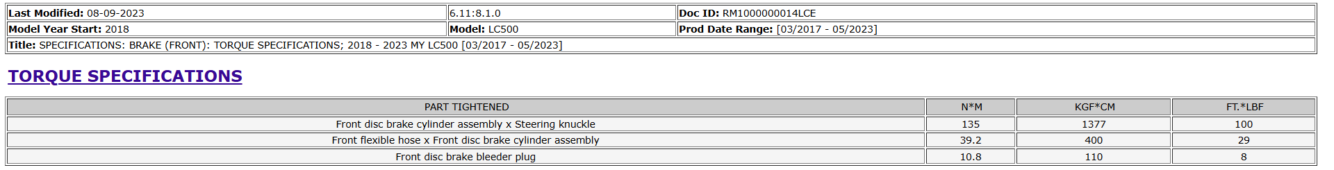

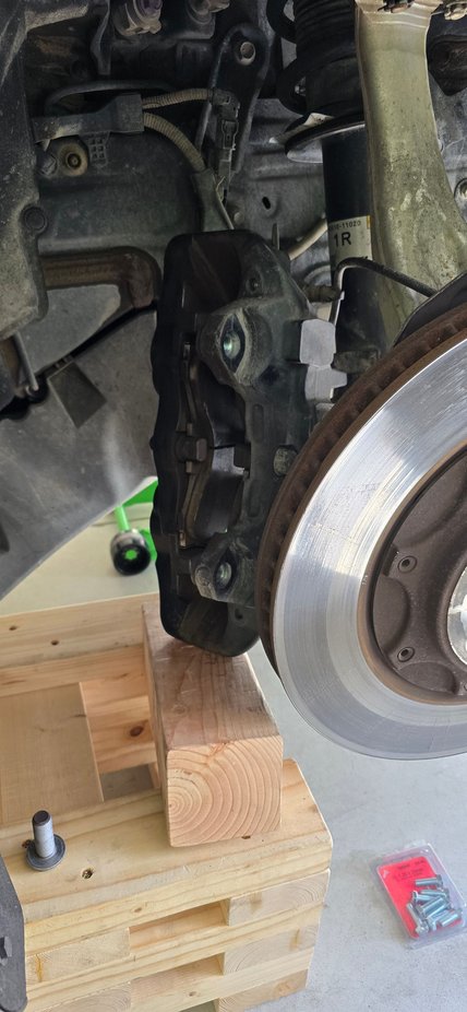

Doing my rotors, anyone have the caliper bolt torque for the fronts?
I'm thinking 100 ft lbs???

Front and rear.

Originally Posted by tecman
Front and rear.
Thank you, kind sir... I was pretty close, for the fronts. 😛

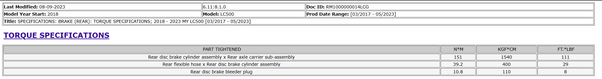

Old Oct 25, 2025 | 11:28 AM
  #315
Timado404's Avatar
Timado404
Veteran: Marine Corps
Joined: Nov 2024
Posts: 778
Likes: 602
From: ATL
Doing the rears today...so odd that the rear caliper is torqued to 111 ft lbs. and the front caliper is 100 ft lbs.
Anyway, thanks again tecman. 👍🏾
