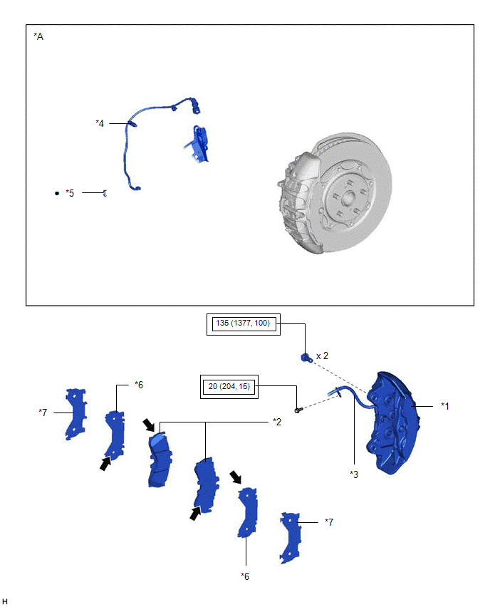

1. Clicking noise during low speed turning
This bugged me for a while. I initially thought it was the whole two piece caliper explanation, but it kept happening whether it was cold or hot. I took the brakes apart and found that it was the anti-squeal shim (which wasn't doing its job at all, lmao). It was covered in some black elastic thing which may have been grease at some point. Anyway, I removed it (NOT the brake pad shim. The anti-squeal shim is a separate shim on top of that). Bam, clicking noise gone. Hilariously, it didn't increase squealing. I eventually switched out the pads to Powerstop Z26s for the brake dust issue.

For 1. Clicking noise during low speed turning, do you happen to have a picture of the exact shim/part you removed? Also, did you remove it only on the side where the noise was coming from, or on all four corners?

For the brake shim, it's #7 in the image. I took out all four corners because... I don't remember why, haha. But it didn't affect squealing at all.
