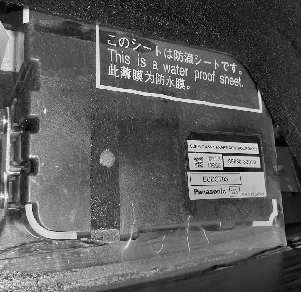

If you're talking about this power supply in the trunk I would guess it bit the big green weiner being under water that long.

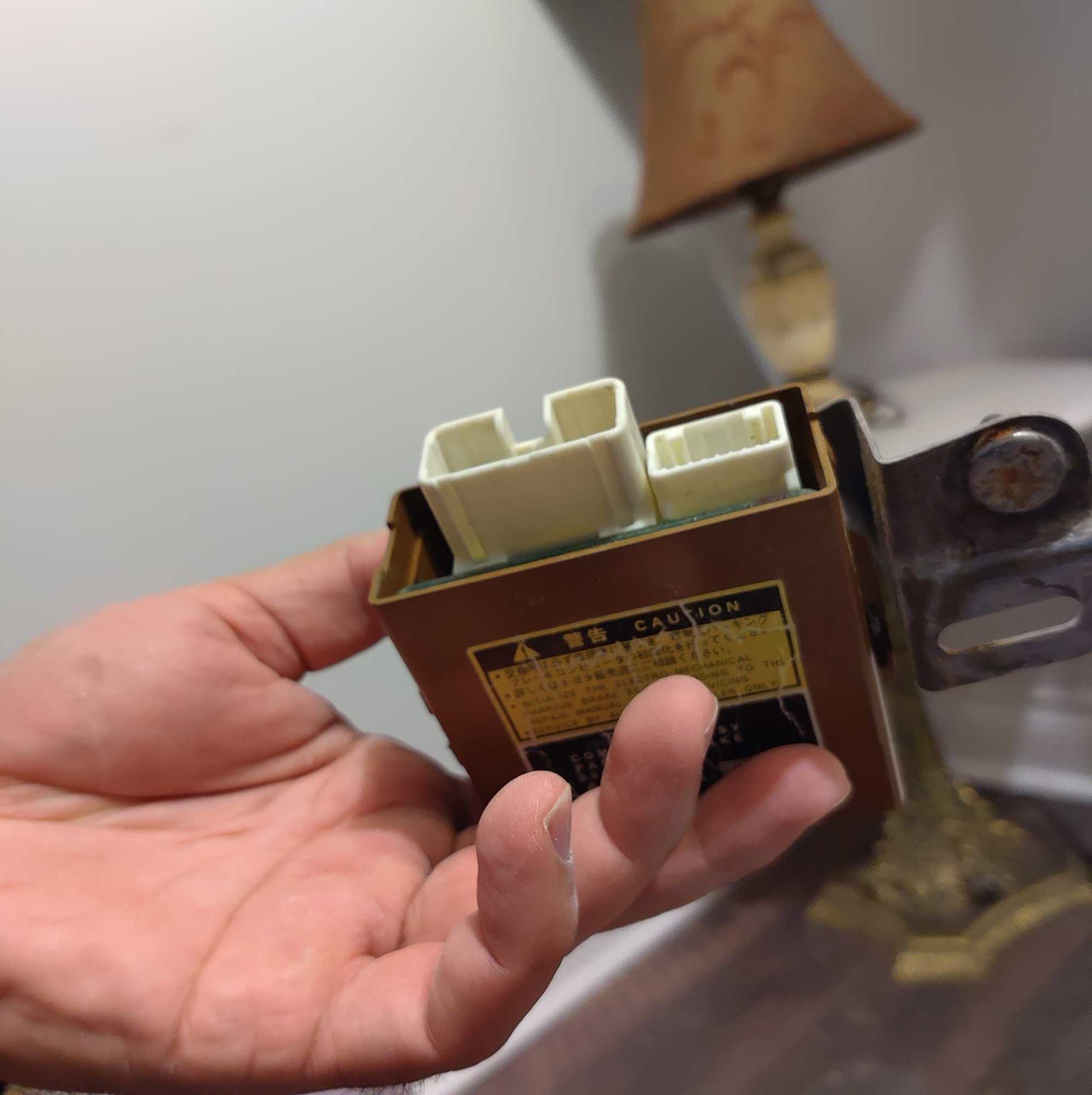

So, that module was completely undamaged. That is the main braking system, and no issues. It had some water around it but not flooded. I may be exagerating that it was fully underwater, but the EPB circuit board defo was in some water for some time. It cleaned up perfectly, but I am guessing it may have chewed on that fat green hotdog. I hope it's not the wiring harness itself....
Pre-clean
Pre-clean
EPB ECU which was the one that got the water boarding treatment.

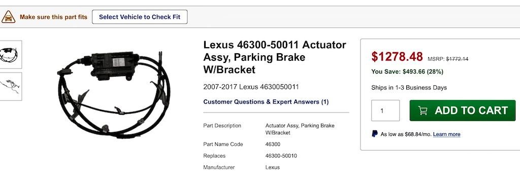

The picture of the board looks like it's burnt ? Hopefully it's not the actuator cuz it's kinda pricey and the rear sub frame has to come off to replace it. A diagnosis flow chart would be nice to have for those 2 codes, the sensor zero point is just the cable adjustment and I don't think that's your problem.
The epb module part# is 8905050020 if it comes down to swapping used or new parts.

The main fuse blew out and I was thinking it saved the damage to the board, but I am also leaning to the board being out. First impression was this is toast, but it cleaned up so nicely and I saw no burn marks or broken connections. I'll bite the bullet and try a used one from Ebay.
