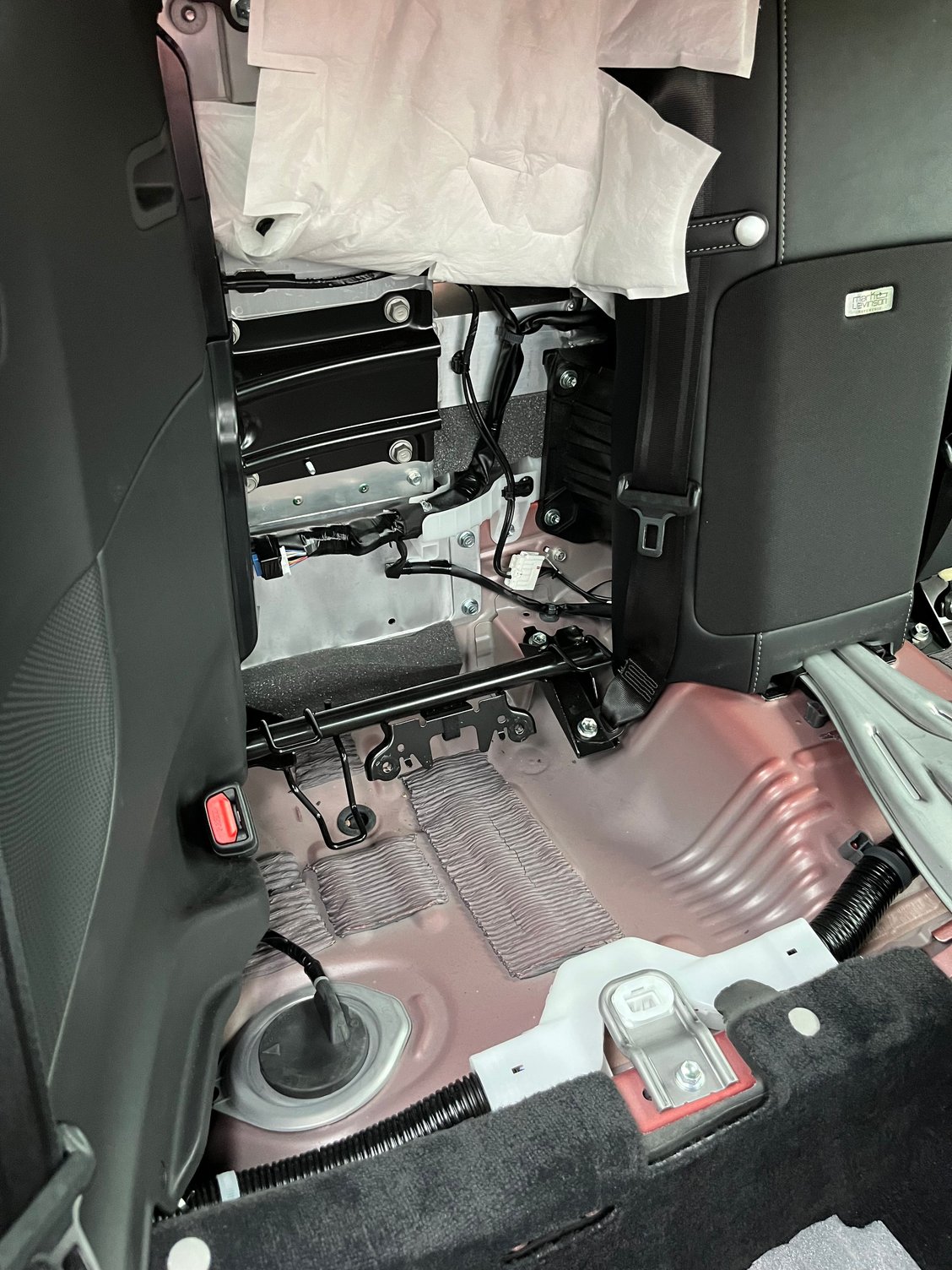

Hi all,
I am trying to run a wire from the cabin to trunk. However, I'm having a hard time looking for an opening. Also, the rear seats cannot be folded down. I'm trying to put the rear camera on top of the license plate. So there have to drill two holes.If anyone have any instructions or information, please let me know thank you.

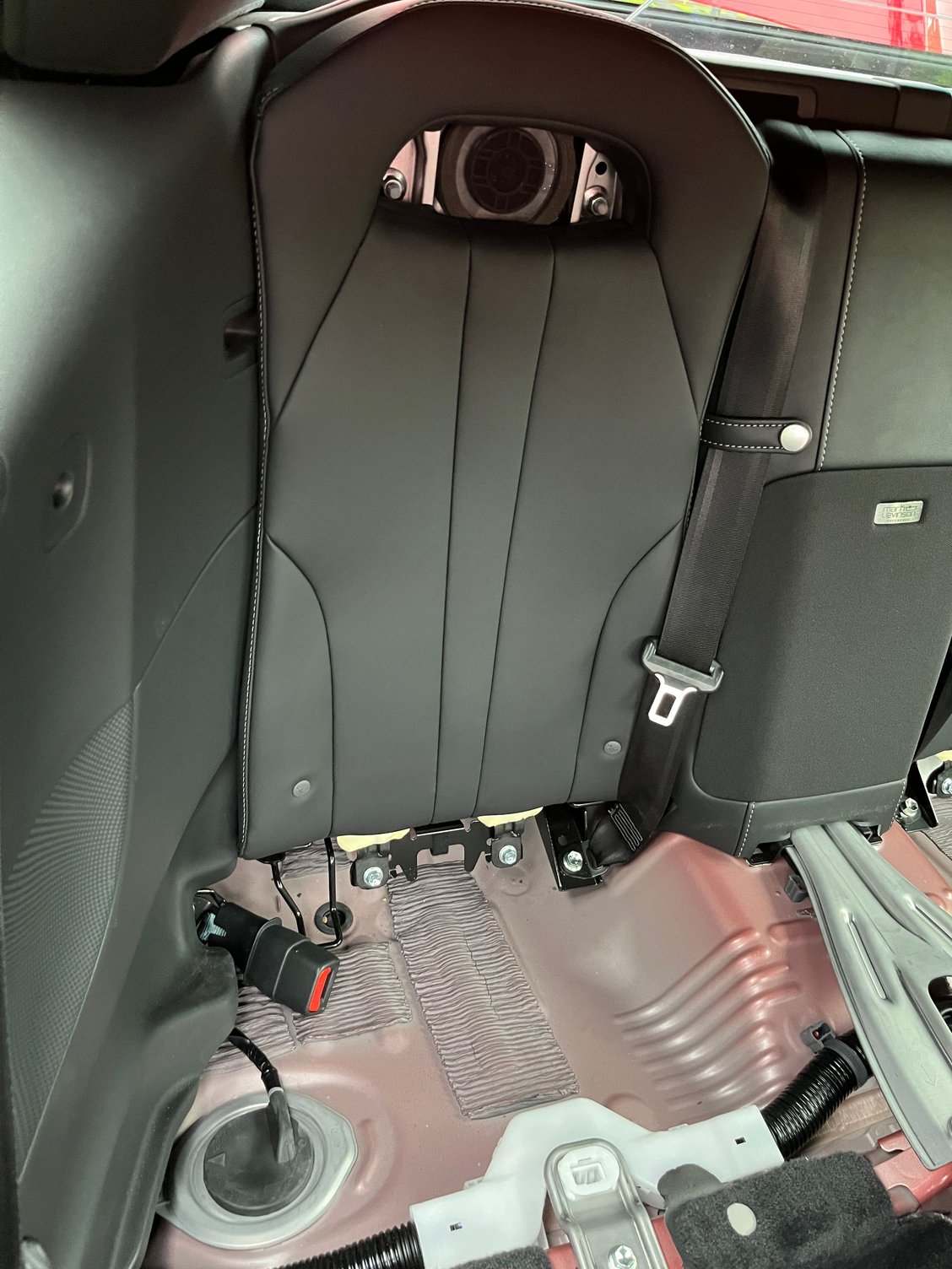

it's part of the Wolfbox Mirrow Dash Mount.
I got part of the back seat off after removing the bolt behind the headrest and was able to do that.

From memory the seat base pulls out upwards then you can unbolt the lower bit of the seat backs. The base clips are easy to break. Mines a convertible and I did get a cable from boot to footwell ok but it was a PITA. Think I took the centre console out too but I’m not sure I needed to. I got some conduit through the rear bulkhead low down - that was the hardest bit.
