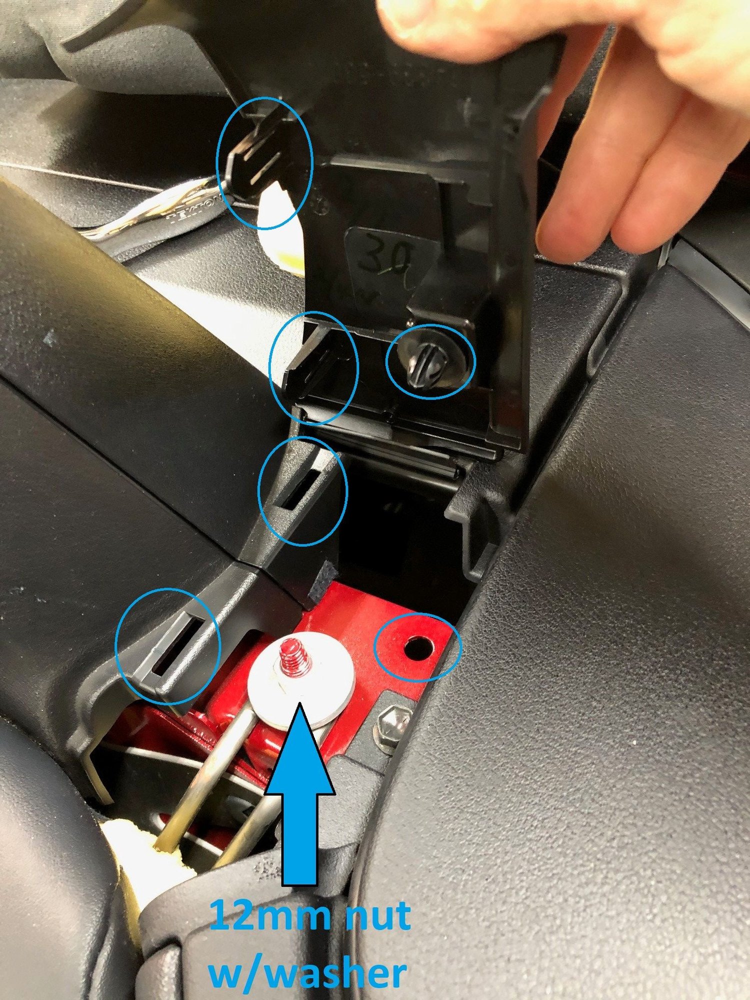

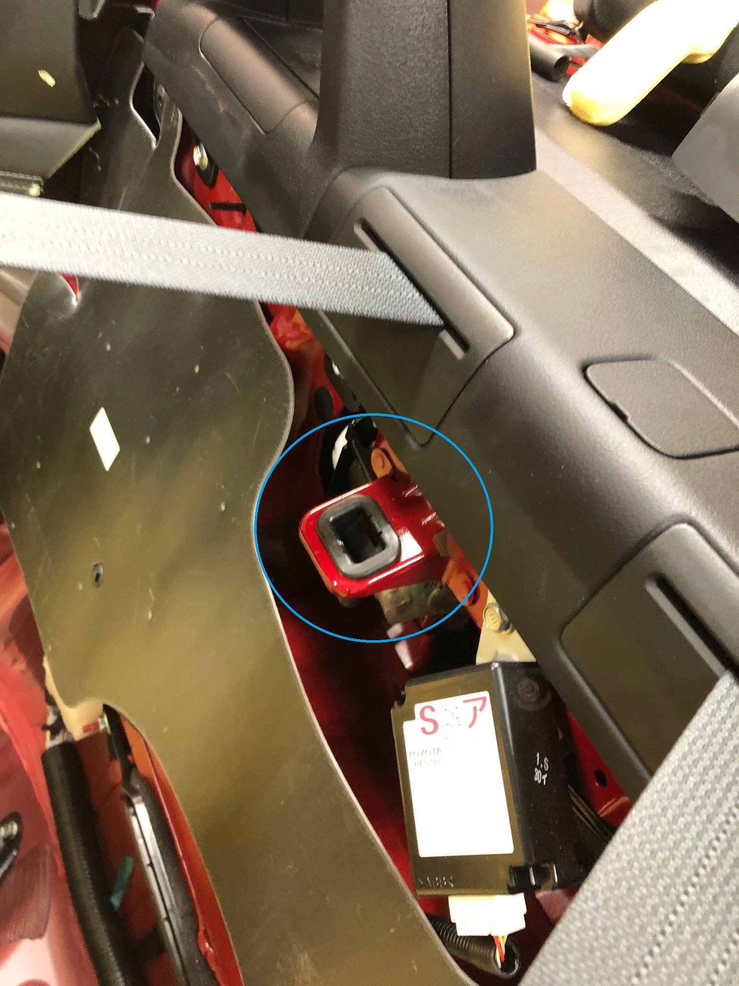

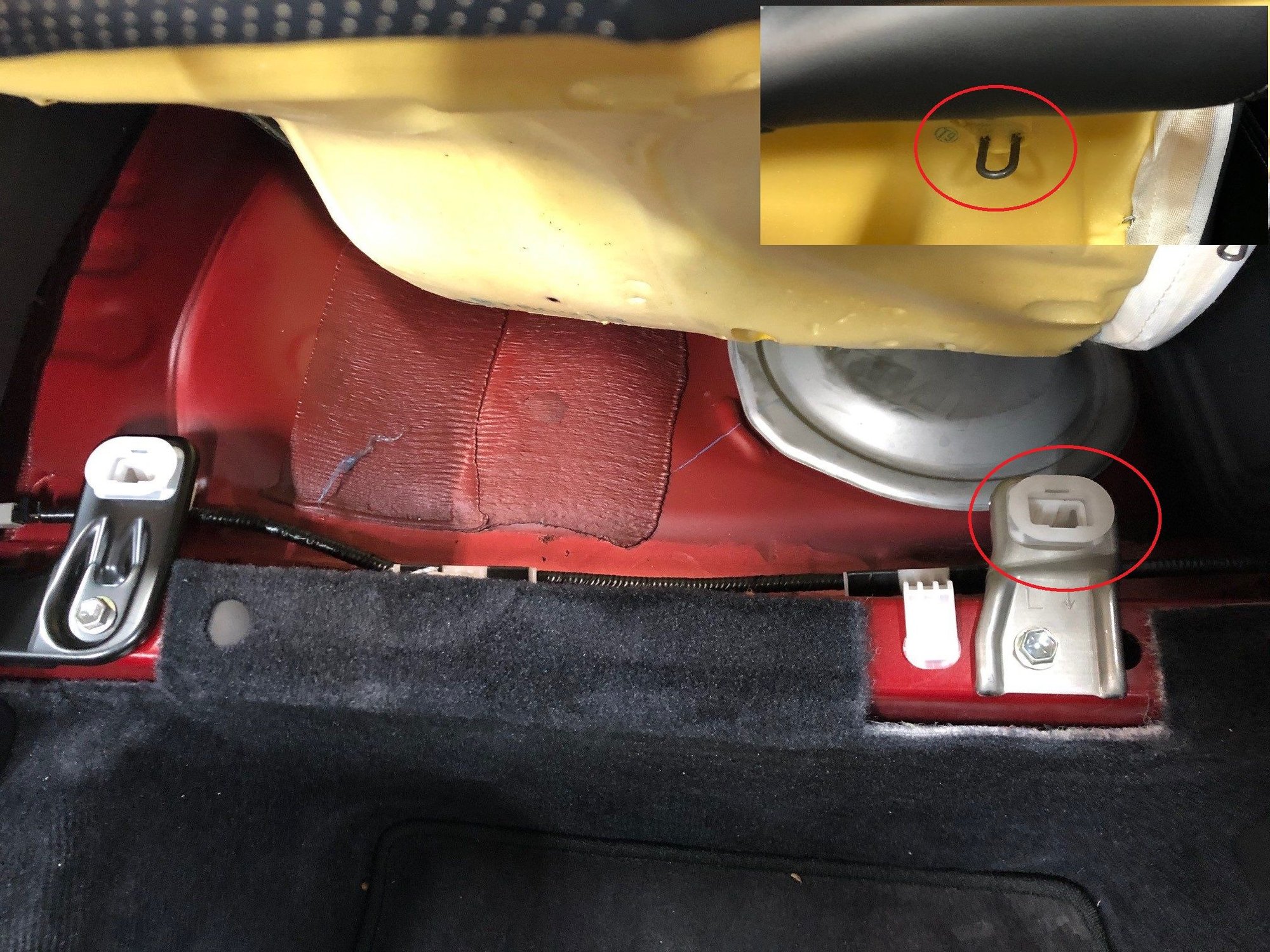

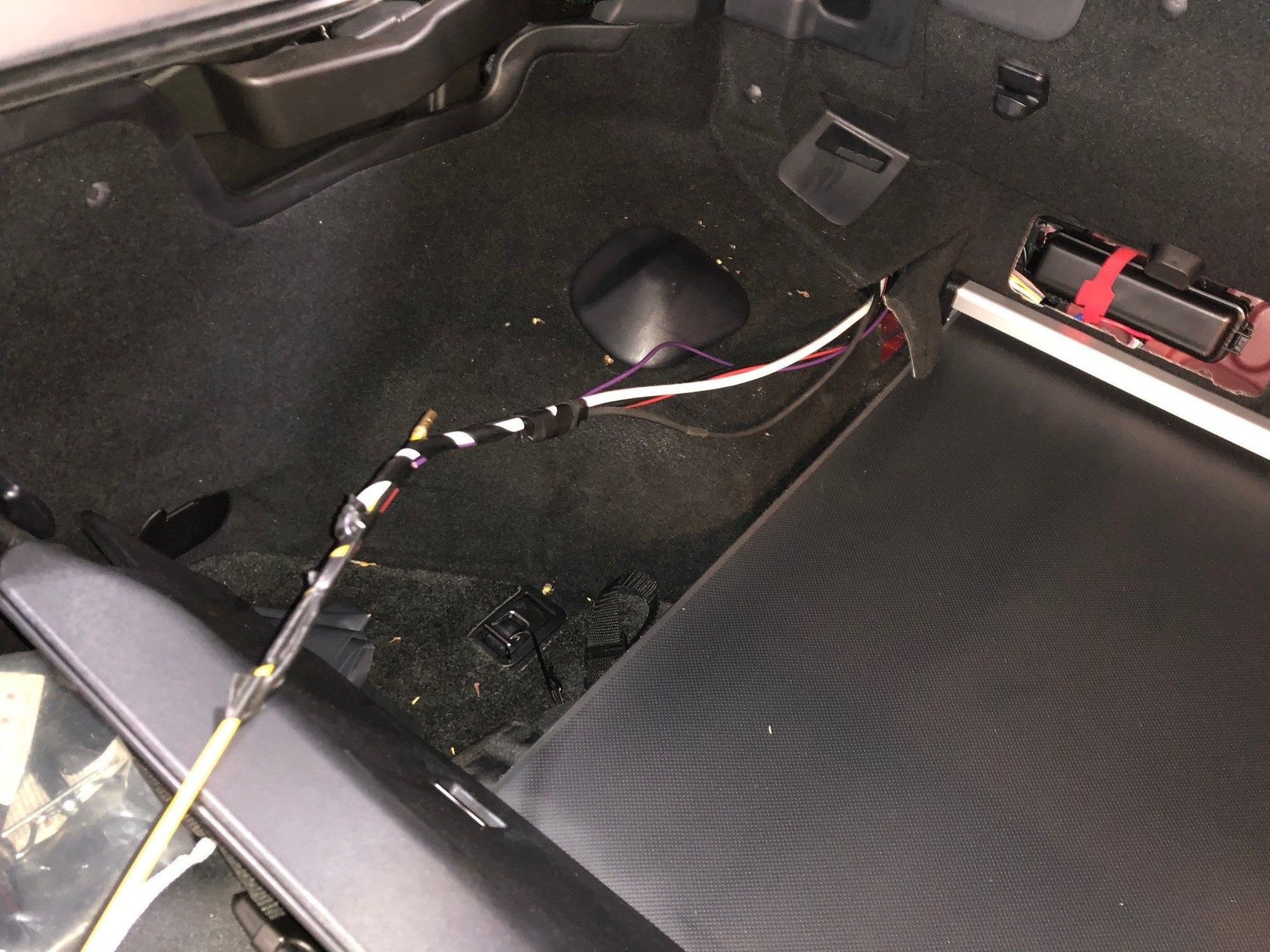

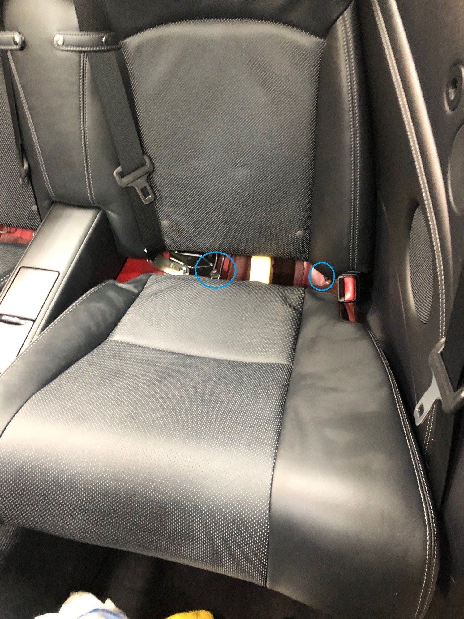

I just ran mine...DennisMik and WylieKylie are spot on. Only tool needed is a deep 12mm socket. Fairly easy on the convertible as you can put the top down and have plenty of room to remove the back seat. Then put the top up to run the wire.
Here are some pics in case you decide to try it:
Lift up on each rear seat cushion-no bolts, just hooked in. Back of seat has two 12mm bolts on each side as shown.
Seat cushions are held down with these steel hooks. They take a fair amount of jerking to get them loose. I broke one of the plastic receivers somehow but ordered a replacement. I suspect you should start from the inner most first.
Top of rear seat on each side has plastic cover that is held down with 3 plastic tabs. There are 12mm nut/washers--careful not to drop or loose these.
Rear seat also has steel hook in center which has a landing spot shown here.

Here's a view from the trunk. Note the convertible top fuse panel on the left--you could route wires there. (I have a piece of velcro around mine as I'm currently tapping power for another need.)
A closeup of the wires going through. I fished extra wires for potential future needs so I only have to do this once. I've coiled them up and left them under the seat cushion.
