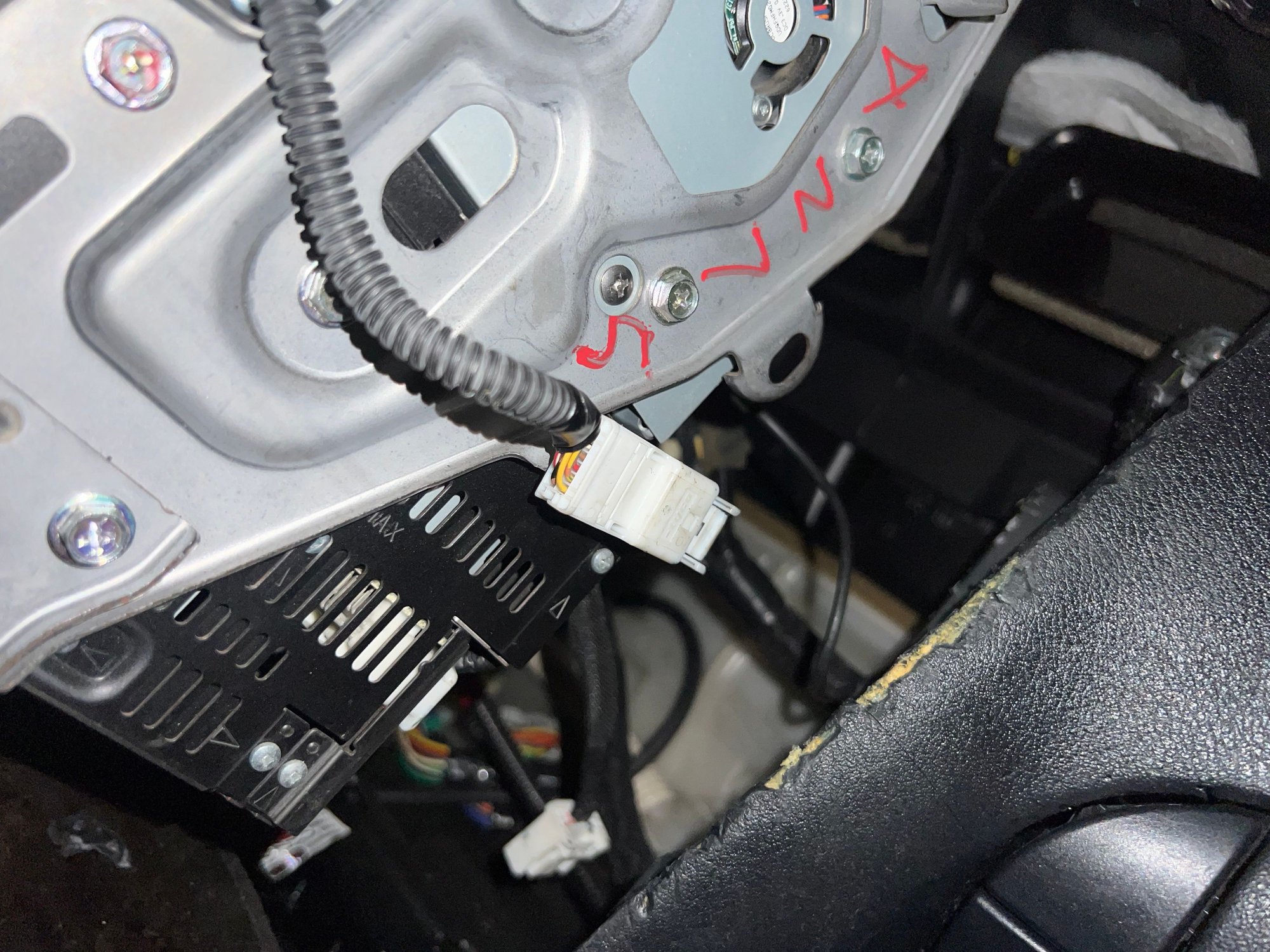

after replacing my DVD changer w the beatsonix kit and meticulously plugging what was leftover back in, I have no clock and the hazard button doesn't work
Everything else works flawlessly
Any clue of a wire and or fuse that controls this?

or if anyone can confirm this is the power to that portion of the factory head unit. (this plug is plugged in which is why this is so confusing)

After reading through multiple threads on the 2is pages,
I believe someone had mentioned that there was 2 plugs with the identical sizes and they possibly were switched
I haven't had a chance to take back apart the radio area yet but will confirm hopefully this weekend.
If this is true, I will post confirmation for any future questions someone might have with the same problem.
Def weird that toyota would have done this w the same size plugs in the same general area though.

Finally confirmed this weekend after having time to re-pull radio. There was in fact exact same size plugs. Switched them out and all is well now.

Hey man, having the same issue but can’t solve it. Did you have 2 plugs that fit into the same size slot? I only have one, similar to this video near the end
. He says that the bottom slot should be empty and i’m assuming the right slot is the power for the clock/hazard display. If i plug it into the right slot I get no clock display and the hazards don’t work. To clarify, I only have 1 plug available that fits into the bottom slot or the side slot, my blinkers work fine as well.
Thanks.

There are 2 white plugs exactly the same size
one fits in the side bottom area and one is supposed to go further up behind the unit area best I can remember
You should have both.
It looks like I can even see it in the 1st picture dangling in the back ground
try that one where you have the other and or reverse them to the other area.
If it worked before it should work again unless you blew a fuse of some sort.

Weird, only have one plug. That plug in the back doesn’t fit anywhere but I’ll take a look again to make sure, it is for sure too wide for the side plug. Was also stumped on why there was just an extra plug yesterday lol. Bought this car used private party and it came like this.
