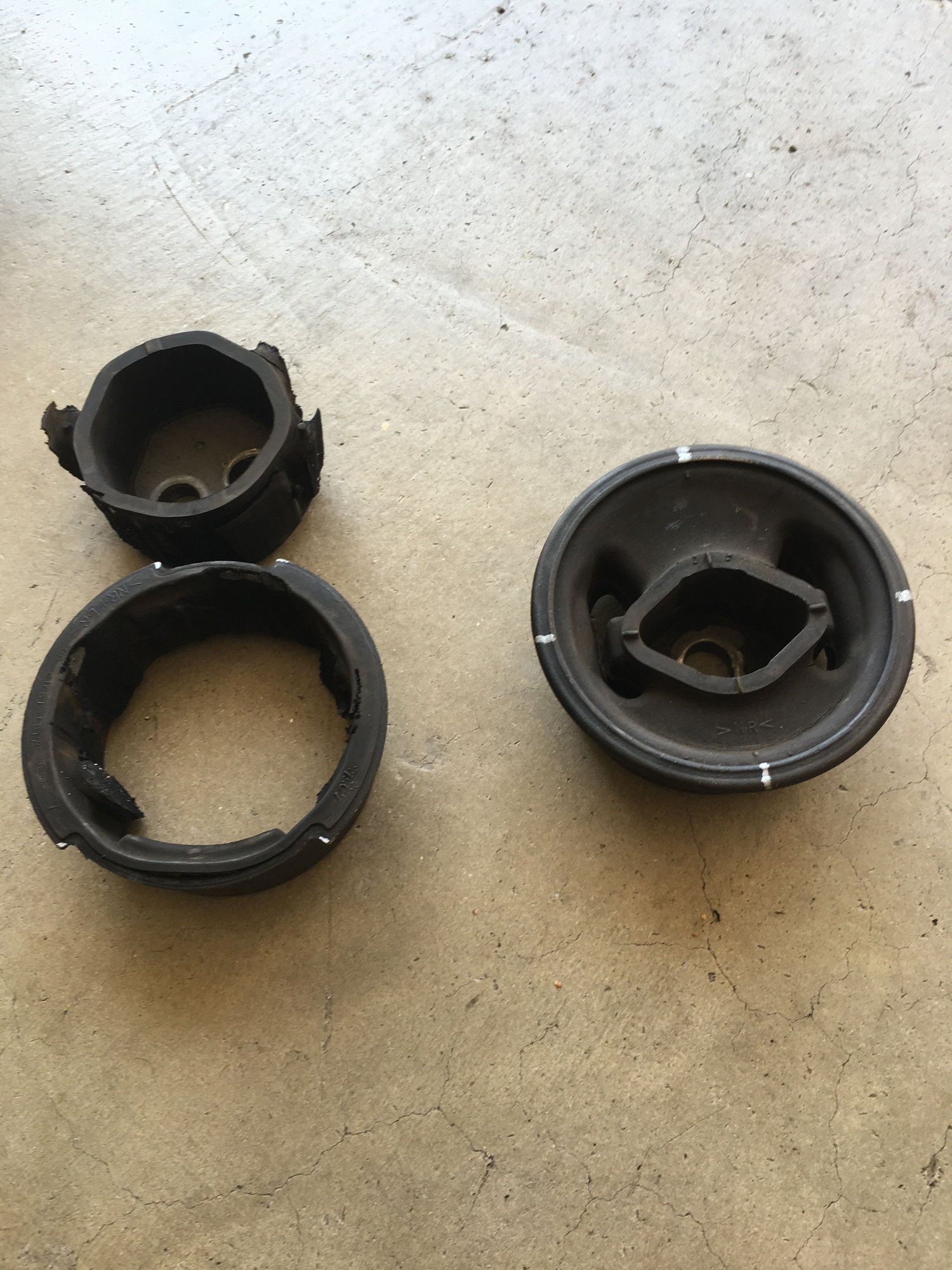

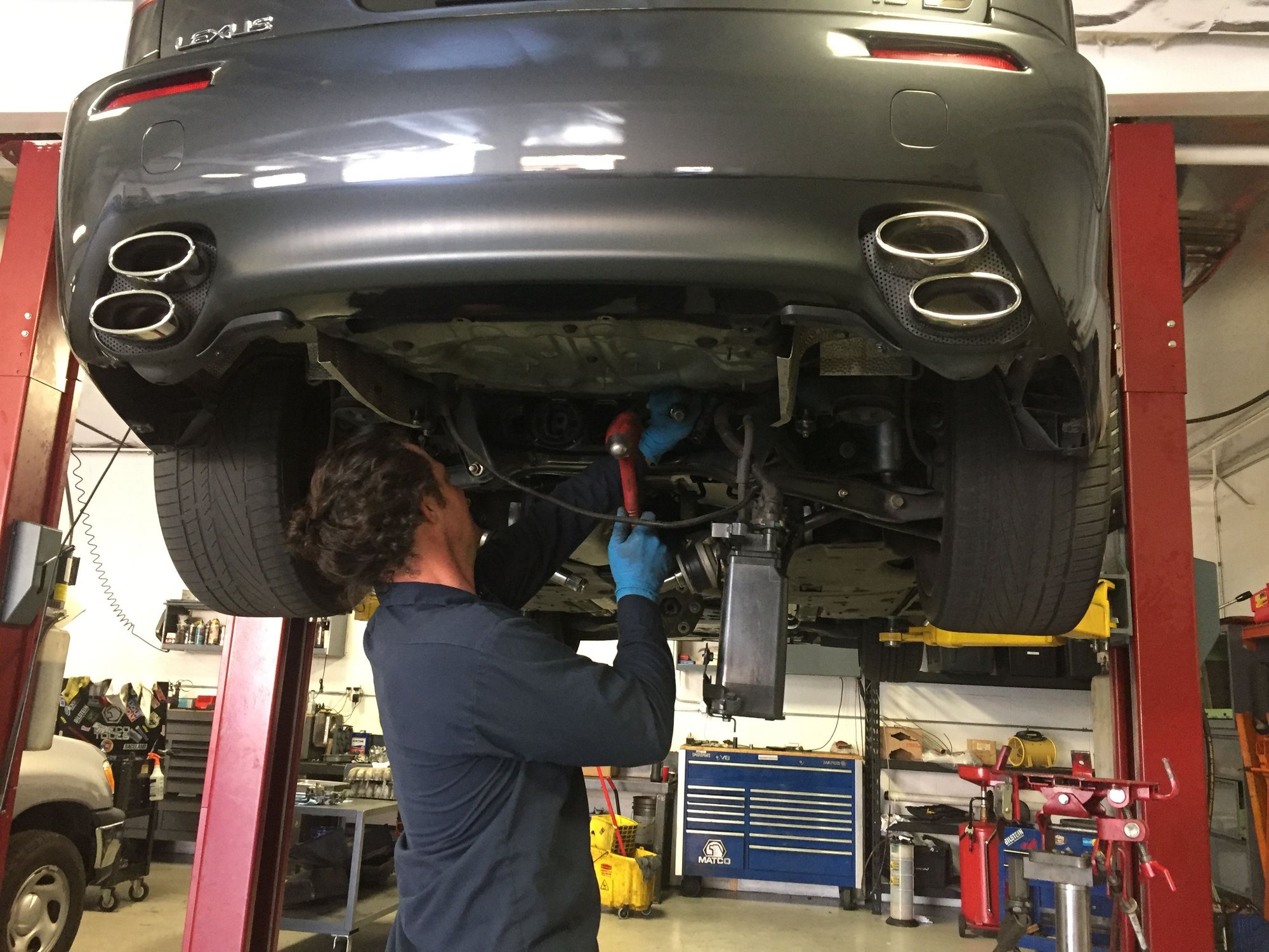

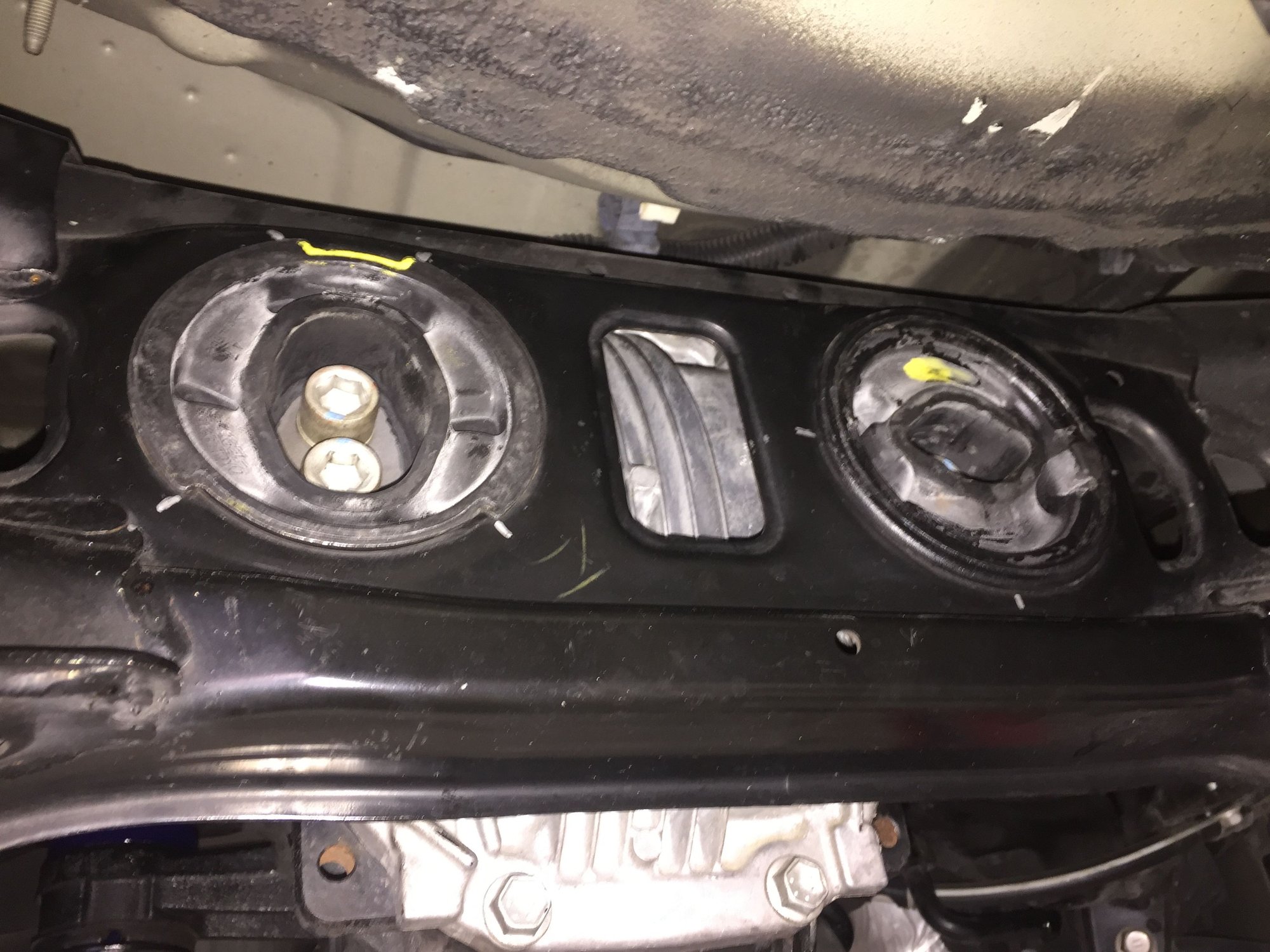

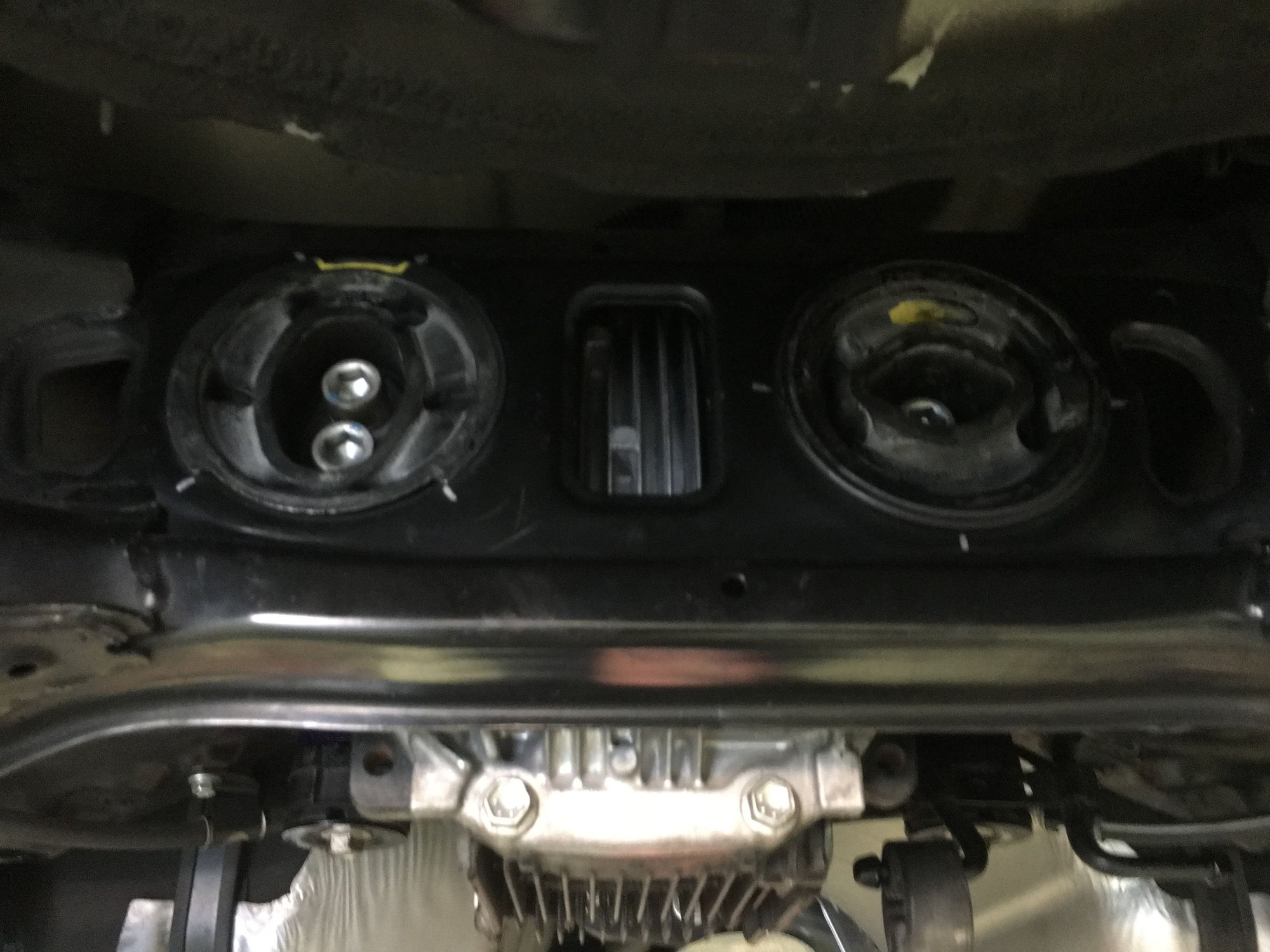

The by the book usually recommends a press system to slide them out..
Mine got whacked out with a bearing sized perfectly..!!
Old / aged 2008 diff mounts..
Removed / cut out
Install
Installed new RC F - units L & R
