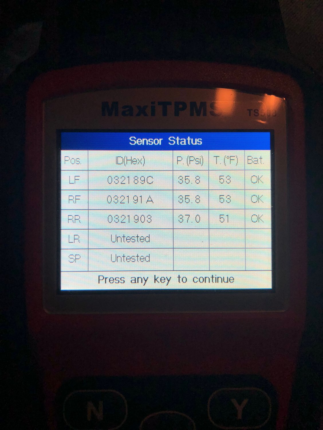

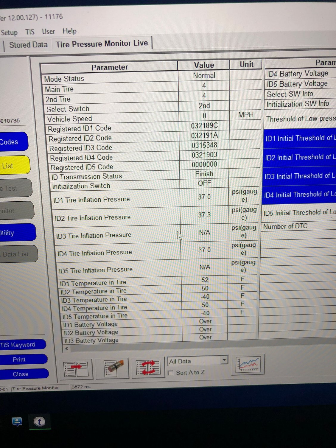

so it looks like one of the brand new tpms sensors i got is messed up. according to techstream there's a problem with the car reading sensor id3 and according to my reader it is unable to read the sensor from my RL tire. i will try to get a new one and see what happens after

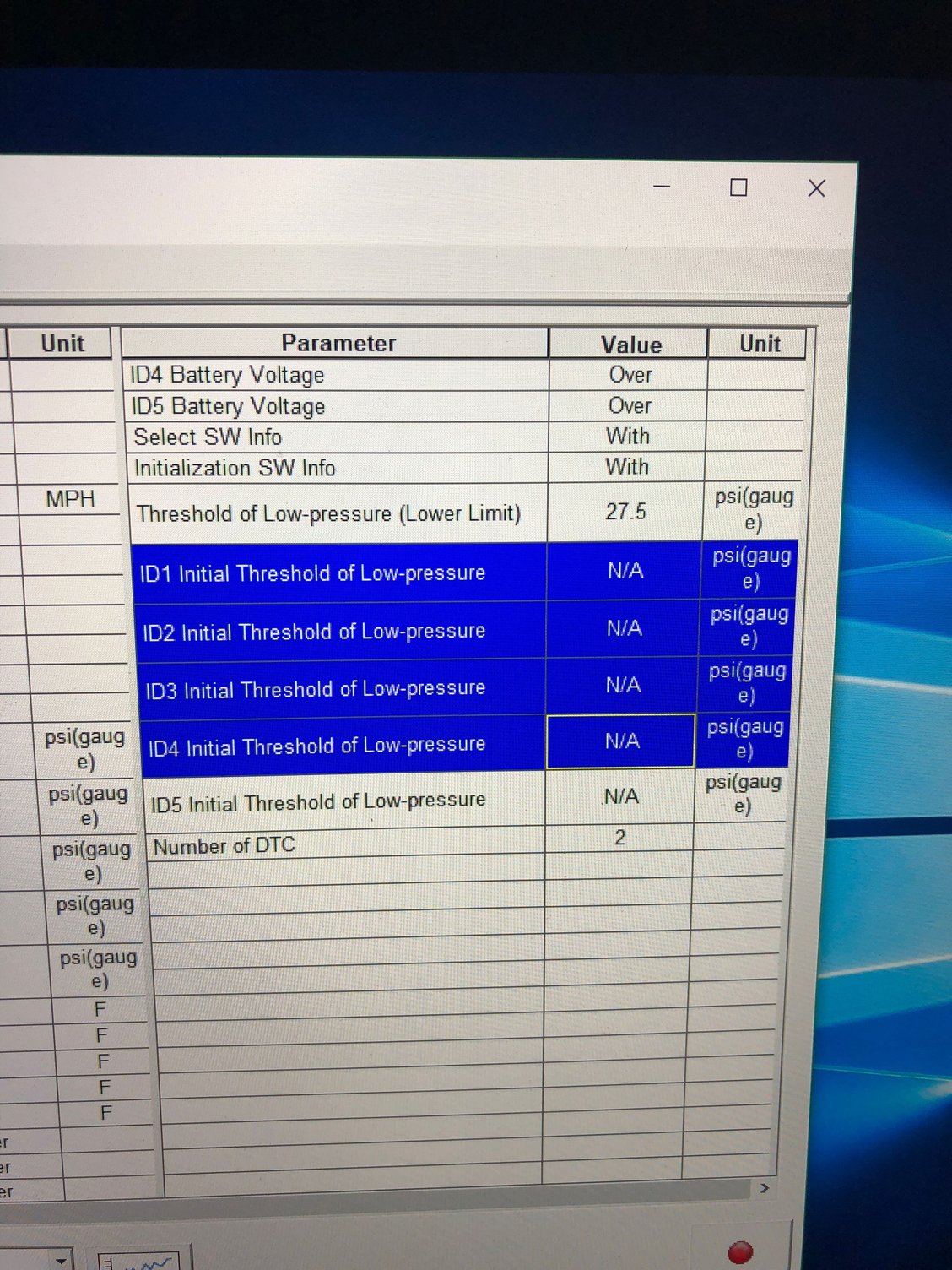

quick update: i was having a hard time triggering the LR sensor so i replaced and had discount tire program them again but still didn't work. i grabbed my programming tool and did the programming again but did it twice this time, idrove for 10 mins but same result. 1st it was giving me two dtc's for sensors and after programming it i had a dtc error for main sensor. i parked the car without turning it off and switch to main sensor, then while looking at techstream i looked back and it had gone away
so far it looks like everything is working
