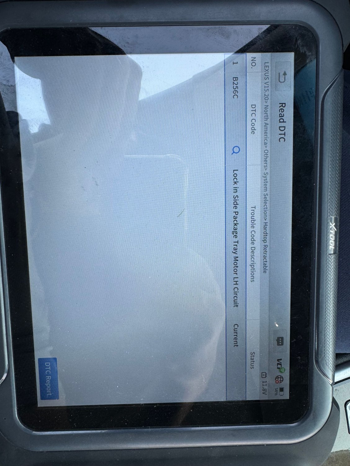

Hi Guys, I had a similar issue, didn't fix it before I sold it last week. My issue was when opening the top, it would complete the operation, error out when I try to close it. It said to "Check retractable top system". To solve for my car, I would open the trunk, use the Yellow pull latches to unlock the trunk from it's latches next to the scissor looking arms. Pull and lift on both sides then push it back down to reseat it into the latch. Close the trunk and pull battery terminal. Reattach battery and was able to close my top every time.
After a few times, I realized I could just pull the battery terminal and it worked for me.
fwiw, I found this link in the SC forums. This could help with that code from the Xtool
https://www.clublexus.com/forums/sc4...our-motor.html
Totally missed this, nice! Wish I found this and that thread before I sold my car
