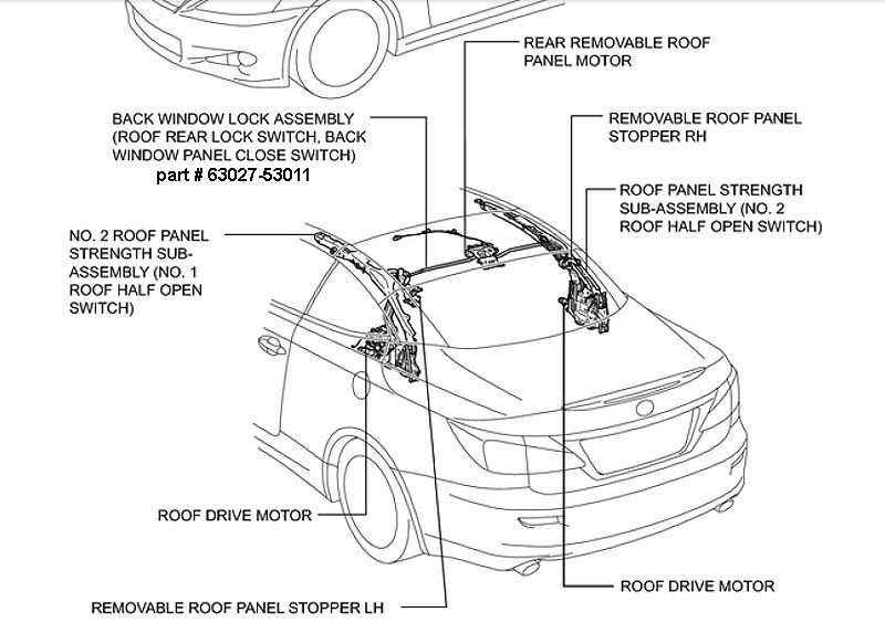

schematics, diagrams, pictures and procedures known to fix any issues concerning the retracting hardtop. there is very little information on this topic. hopefully together we can make it possible for owners to fix top problems themselves efficiently.

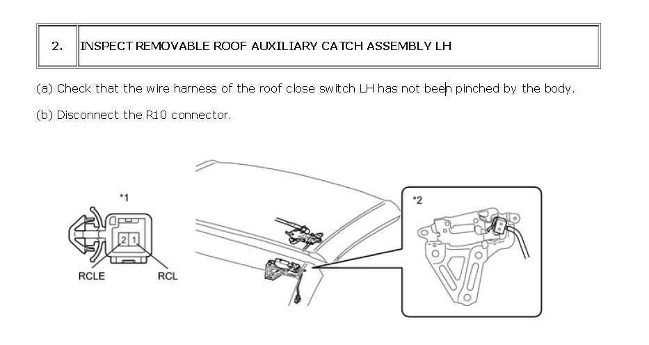

common issue when hitting the top button with no response, the main switch comes unplugged. remove side panel and plug wires back into the switch. if this does not work replace the switch.
