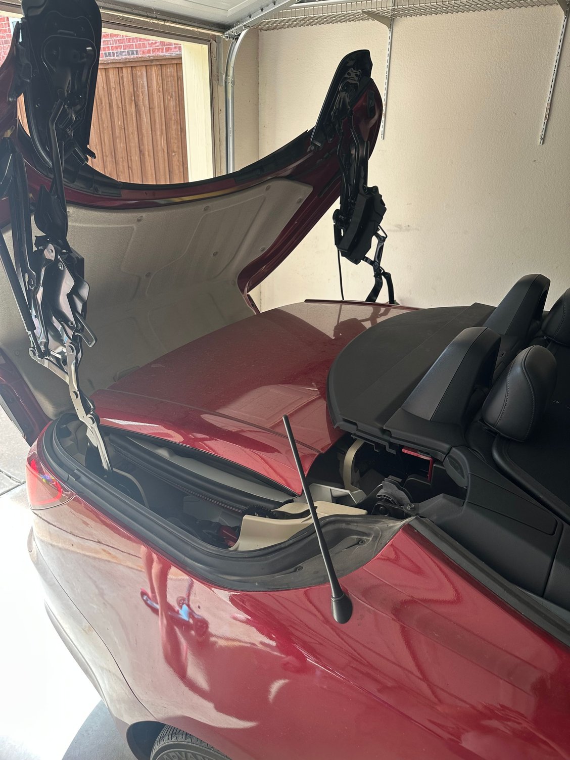

Default Top stuck open
Hi all
The weather stripping on the package tray slipped and got wedged between the bottom of the tray and one of the folded down roof pieces.
I was able to remove the weather stripping but the top won’t continue operation up or down.
When I attempt to operate, the package tray makes a small movement before stopping and I get the operation suspended notice.
I am not mechanically inclined outside of brake jobs and oil changes. Any ideas or should I bite the bullet and take it to the dealership?
