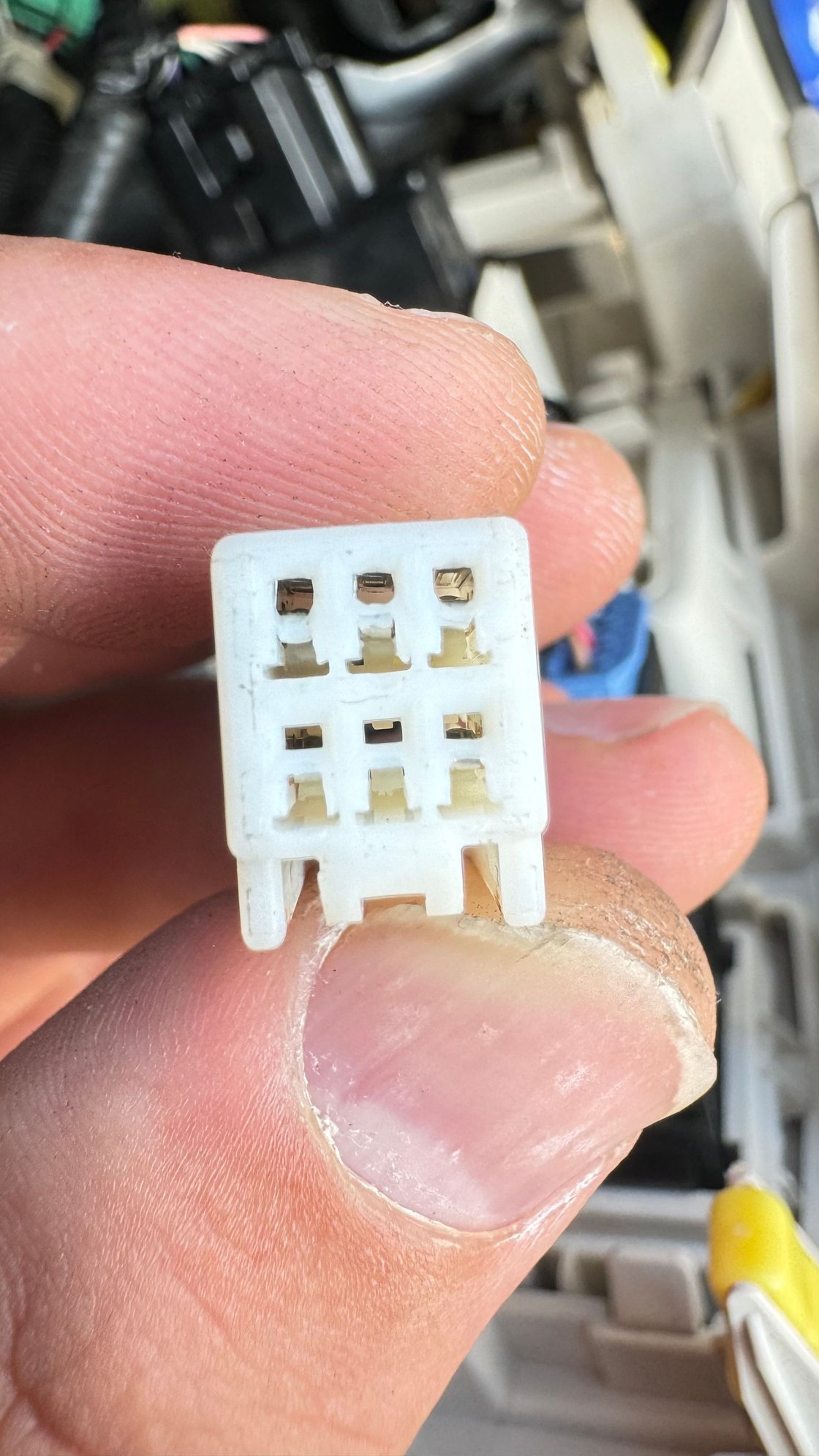

Default 6 pin switch in Lexus is250c
Originally Posted by cfauvel
Thanks for the TechStream advice....been reading some scary reviews on what is found on ebay....sounds like they are pirated versions and some laced with spyware (at best), ransomware (at worst). I think I'm going to get a cheap laptop and run a Virtual Machine for the software.
On a positive note..after cleaning the main switch at the dash with CRC Electrical cleaner (took the switch out and took it apart, ridiculously simple and ridiculously expensive (there IS a circuit board in there with just 2 contacts)), the top has been going up and down consistently (knock on wood).
UPDATE: well the fix didn't last long. However, a new switch did, in fact, fix it for a longer period than previous fix and, knock on wood, is still working.
Anyone know where I can get another 6 pin connector that looks like this for my 2009 lexus is250c
