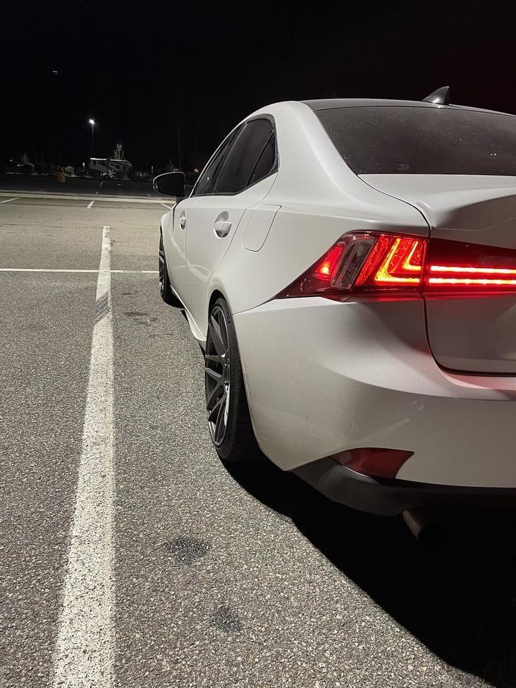

I wanted the most concave / flush fitment I could get on 19" wheels. Looking back at it now, I think I should've maybe went 18's because I think 19's might look too big on the car because my OEM wheels look fine too. I think if I can get a thicker tire on in the back I'll be happy. I'm just worried about bending a wheel or messing up a tire more now than before. I have a lip coming in so hopefully that makes the car look better

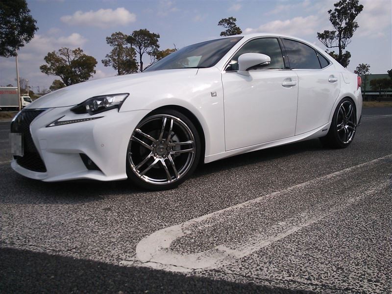

Not black, but this should give you an idea of what those look like on the car...
Website said these were 19x8.5 +45 in front. Keep in mind this appears to be an IS250 (smaller brakes up front).
