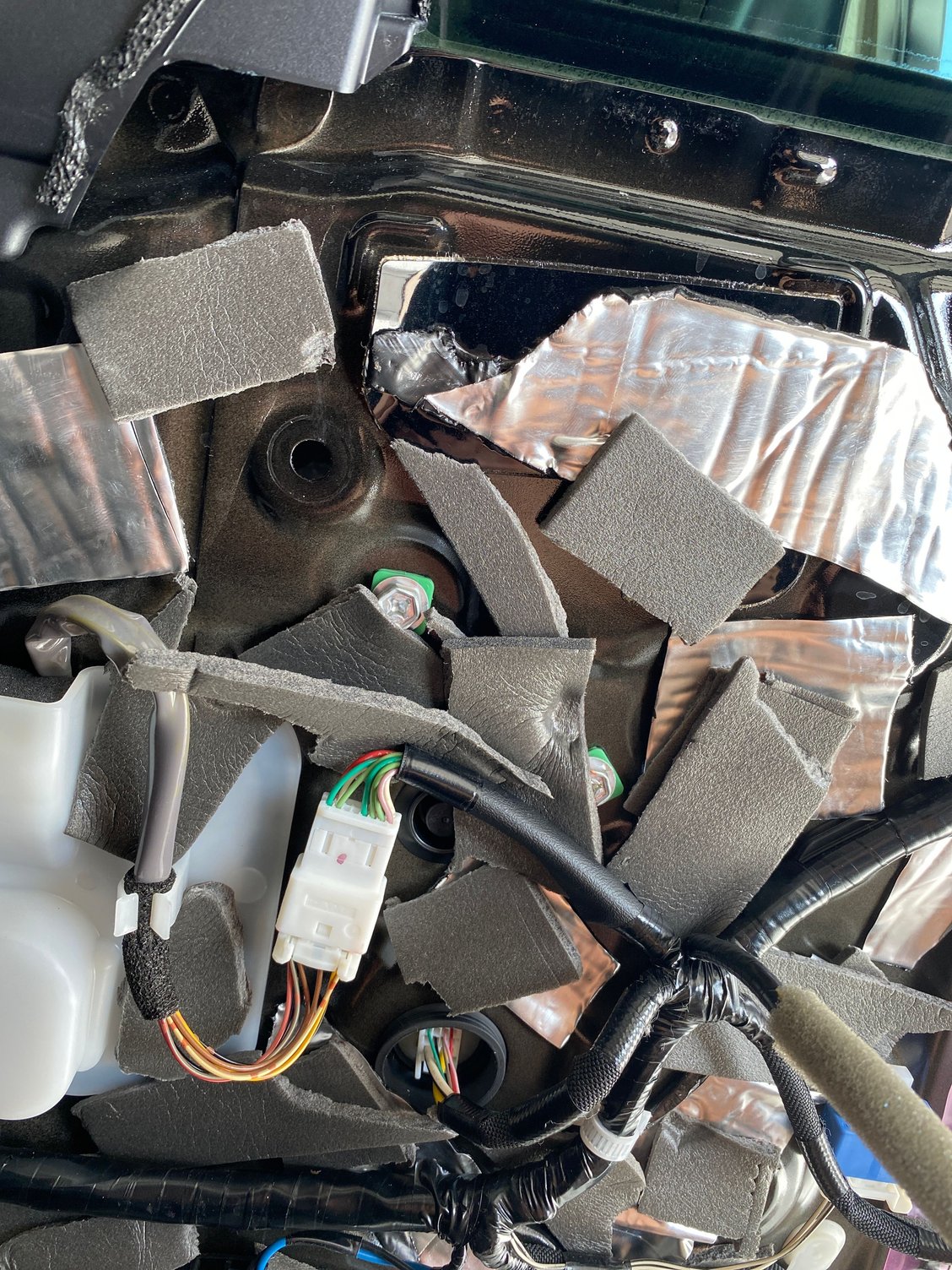

Ok...assuming you don't have Memory Seats, the car is likely prewired for them, meaning there is a connector in the Driver's door with Ignition power that would have went to the Outer Mirror Control ECU.
The Ignition source is fused to the 10A ECU-IG1 NO. 1 fuse.
Don't ask me to explain the relation between the Memory Seats and Mirror ECU lol!
The connector is White and has 14 cavities for wires...I believe there is a wire in each cavity.
Pin number 5 of the connector is a Black wire, and that is the Ignition source. The same connector also has a Black wire in Pin 8 position, so don't mix them up.
Pin 8 is at the corner of the connector as it's 2 rows of 7 cavities...which leaves Pin 5 a little closer to the middle of the connector.
As it's likely not plugged into a component (the Outer Mirror ECU), then it's either taped to the harness or plugged into a dummy connector as a placeholder.

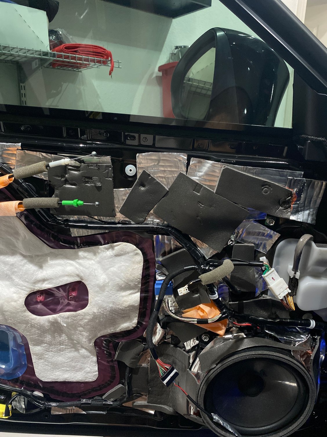

Likely the connector in the pic you uploaded just above the speaker area.

is this the connector you are talking about this is the only one that would make sense. sorry i’m completely new to this world so bare with me

If you don't have Memory Seats, then if the connector was present (if) it wouldn't be plugged into anything.
It would either be taped to the harness, or plugged into a dummy plug...basically the dummy plug would look like a cap on the connector.
Of course I'm assuming the car is prewired for the Memory Seats, which I could be wrong. A lot of 2014's are prewired for Fog lights even if the car doesn't have them.
Your door is pretty busy...I'm looking at all the stuff in the pic trying to help find the connector, but man there's a lot of foam/insulation everywhere!!
I could be staring right at it and not even know. lol!
For reference, the plug in the pic is 16 cavities from what I can see, even though there isn't a wire in each cavity.

ah gotchu to be honest i don’t think i have the memory seat connecter, i’ll look out for it. is there any other way going about it? yea i know i made it super messy good thing it’s hidden i guess😂😂
