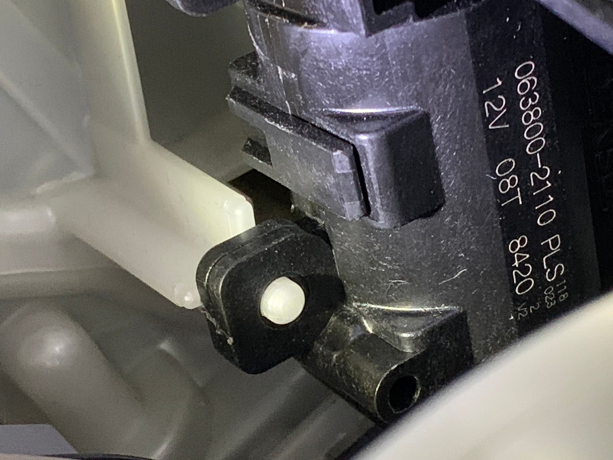

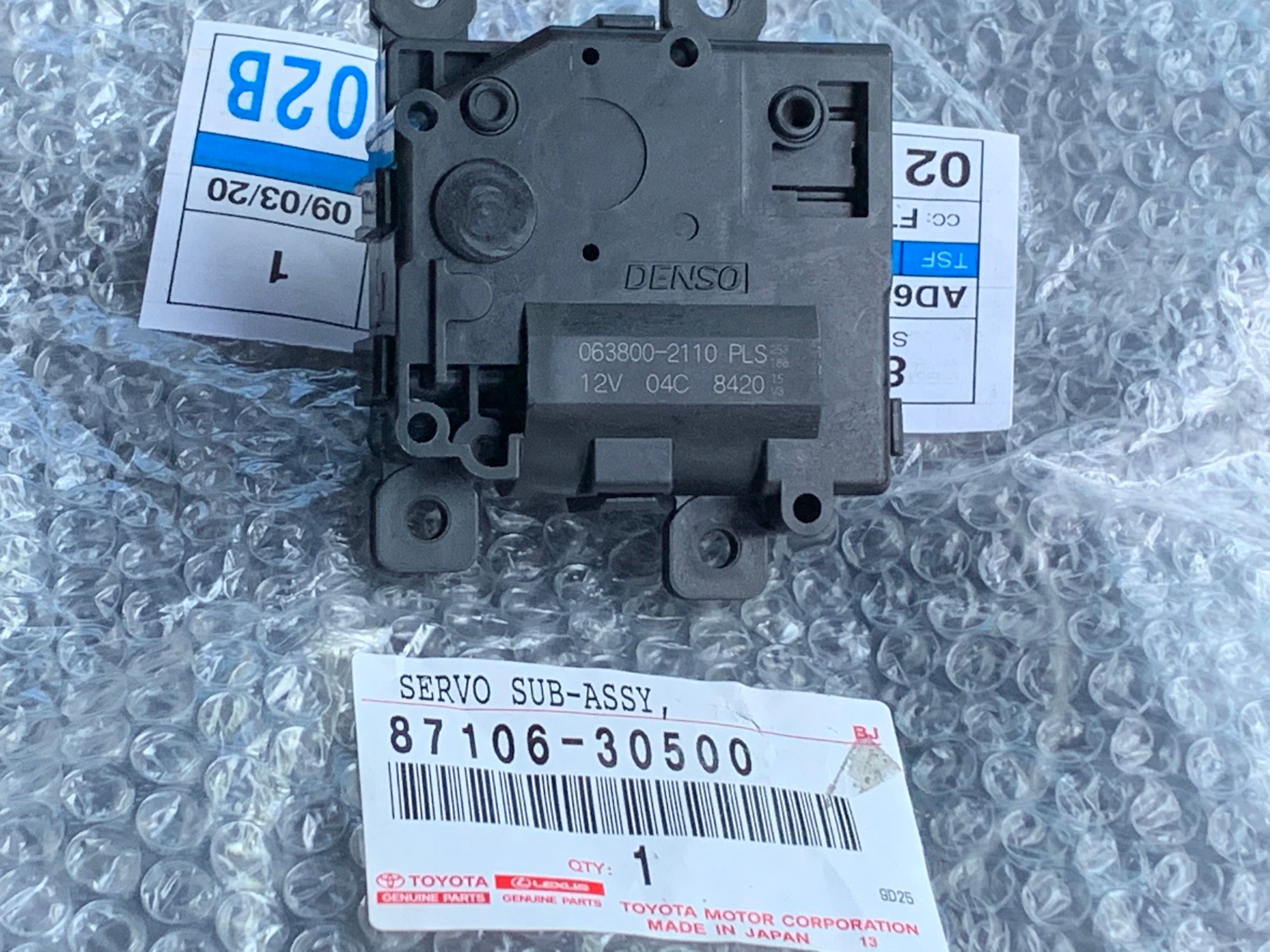

Hello, thanks for that.
Is there anyway to remove the 87050C without removing the entire Dash? Dealer quoted me it will take more than 13 hours and will charge me more than $3,000 to do it.
Also, I order the part to try to do it myself but the word pri ted on the bottom is different than the one they send me, does this still the right part?
The one in the car currently, bottom read 12V 08T 8420.
One from lexus dealer they send me. The bottom read 12V 04C 8420.

The part number is not printed on the servo anywhere so it looks correct. You have to remove the whole dash, crappy job. The only way around it is if you can remove enough things in the way and squeeze your hands in there to remove the servo. Happens on a lot of GS and LS as well.
