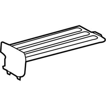

I have a suggestion it might help, try to remove the retainer piece from the glove box and see

I also have a rattle somewhere around or behind my glovebox! One time I removed all the contents and I thought it stopped, but I think it mightve still been faint. I have not tried removing that tray.

I’ve tried and remove every single movable items but still no luck.
