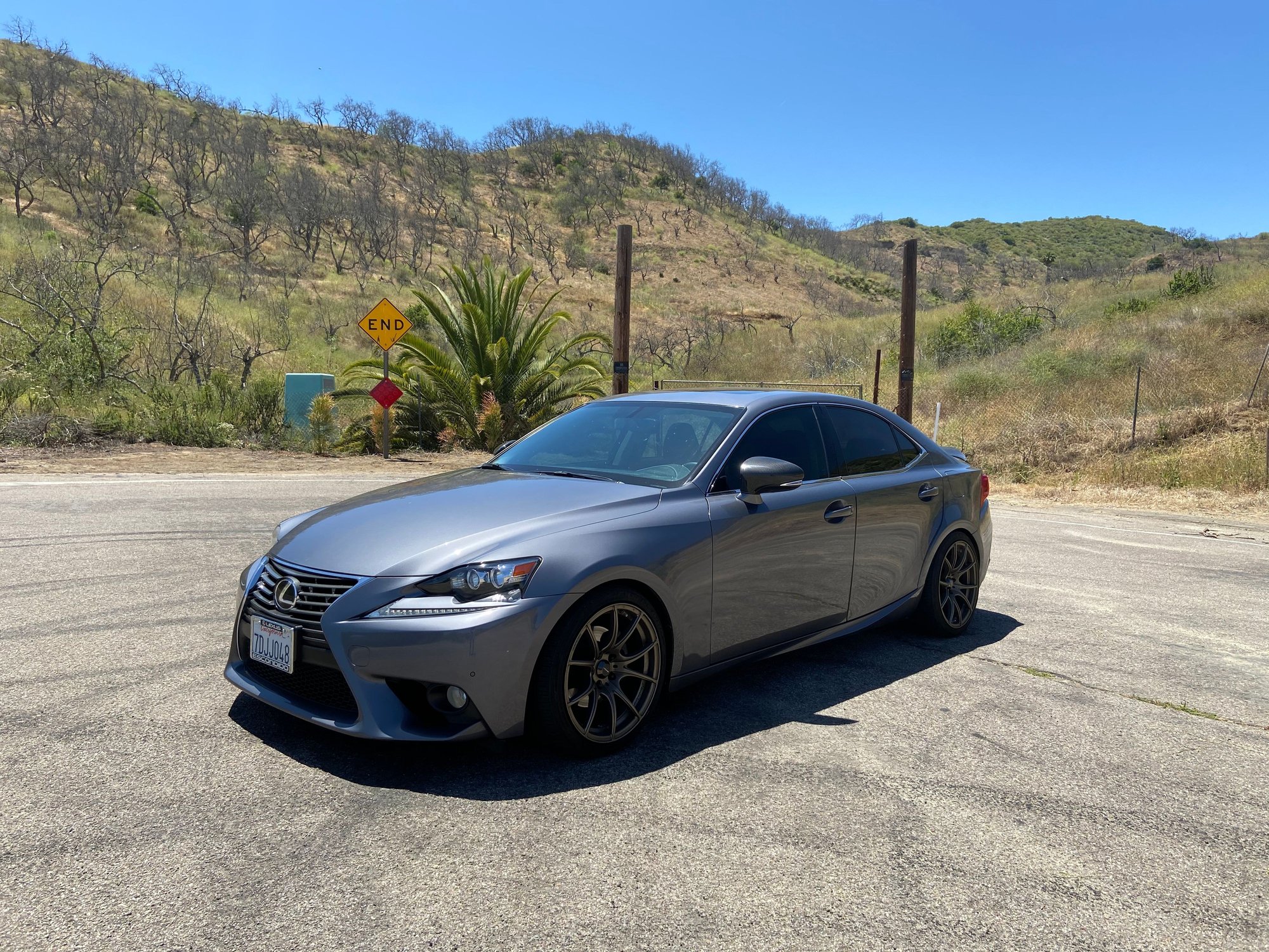

I’m running this setup with a 255/35 all around and haven’t had any fitment issues at all. I’m also lowered on tein springs
