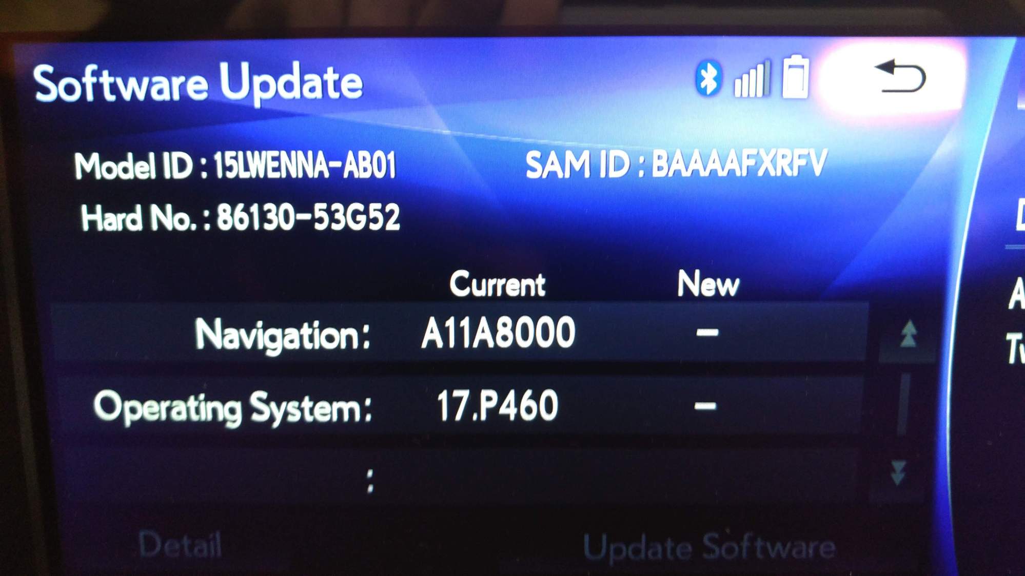

Thank you for posting these pics. What year and model is yours? Called Lexus of Winter park and they stated no updates.🤔

Quote: Thank you for posting these pics. What year and model is yours? Called Lexus of Winter park and they stated no updates.🤔
I have a 2014 IS250 F-sport, it’s the same model and hard number.
when you take it to the dealer, you have to say it’s glitching, they won’t bother any other way. The only thing they offered to update was the GPS.

My 2018 300 AWD currently has:
Nav: A11A8000
OS: 17.P460
Gracenote: 08367
Reply 0
Nov 2, 2019 | 12:25 AM
Quote: My 2018 300 AWD currently has:
Nav: A11A8000
OS: 17.P460
Gracenote: 08367
It’s been a while since they updated mine so version 17 might be available for 2014 or it might not, what’s your model and hard number in the same screen?
