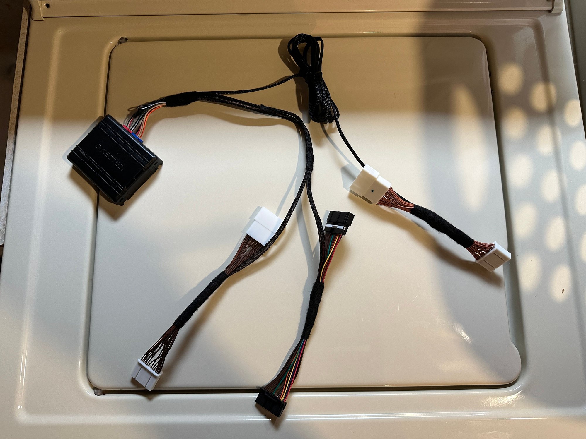

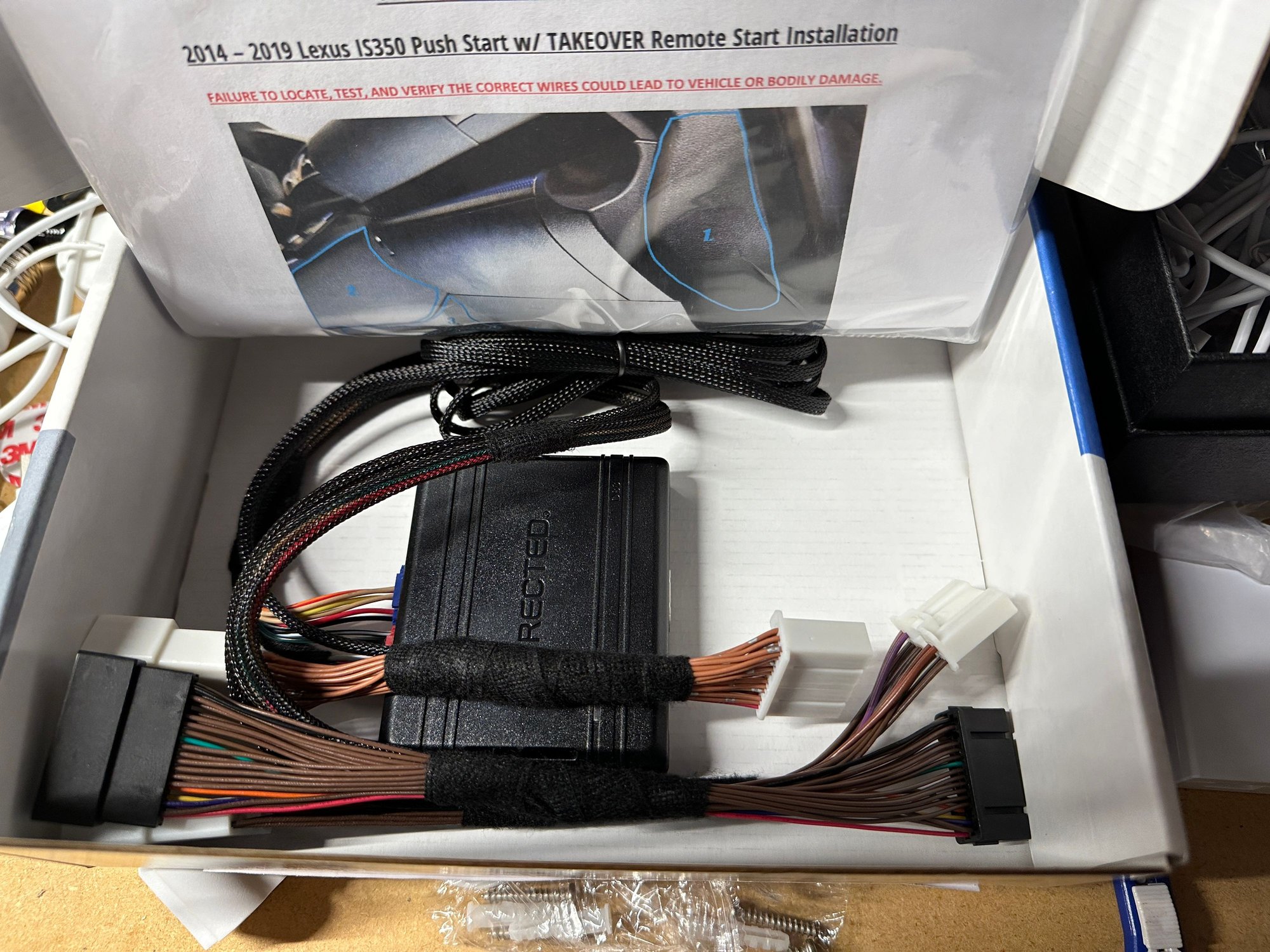

Kit arrived today, hope to get a chance to install it Sunday afternoon.
Components are to be installed behind the glove box (need to drop the airbag and glove box for access) and plug into a couple of ECU connectors.
Haven’t checked yet to see who this ‘directechs’ is yet.

Ok, installed the kit this afternoon, works as advertised!

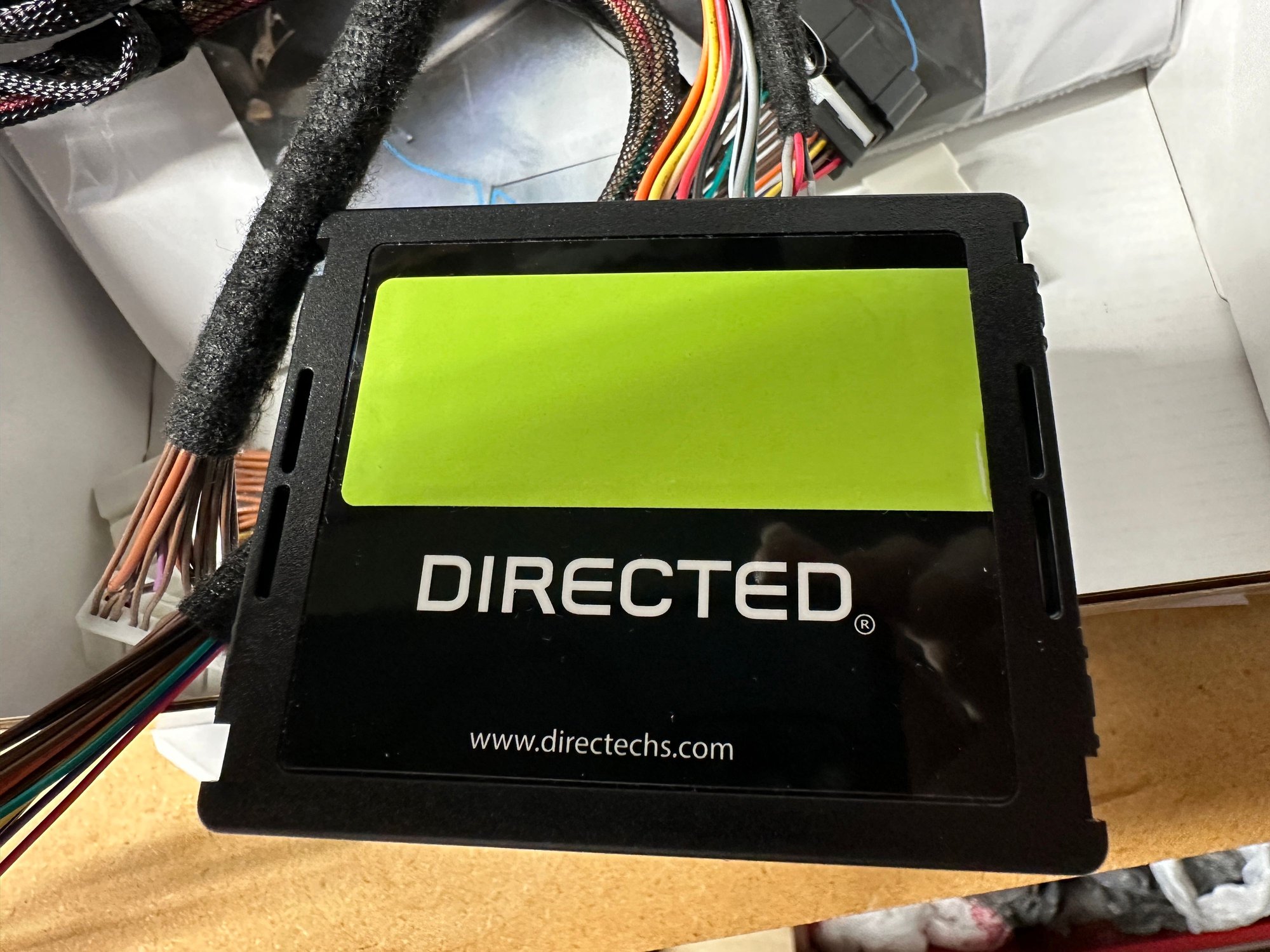

Actually it appears that Accessorides is just a dealer/reseller, not the manufacturer. Directechs would be the maker. I went to that website, but it requires a dealer login to get any useful info.
