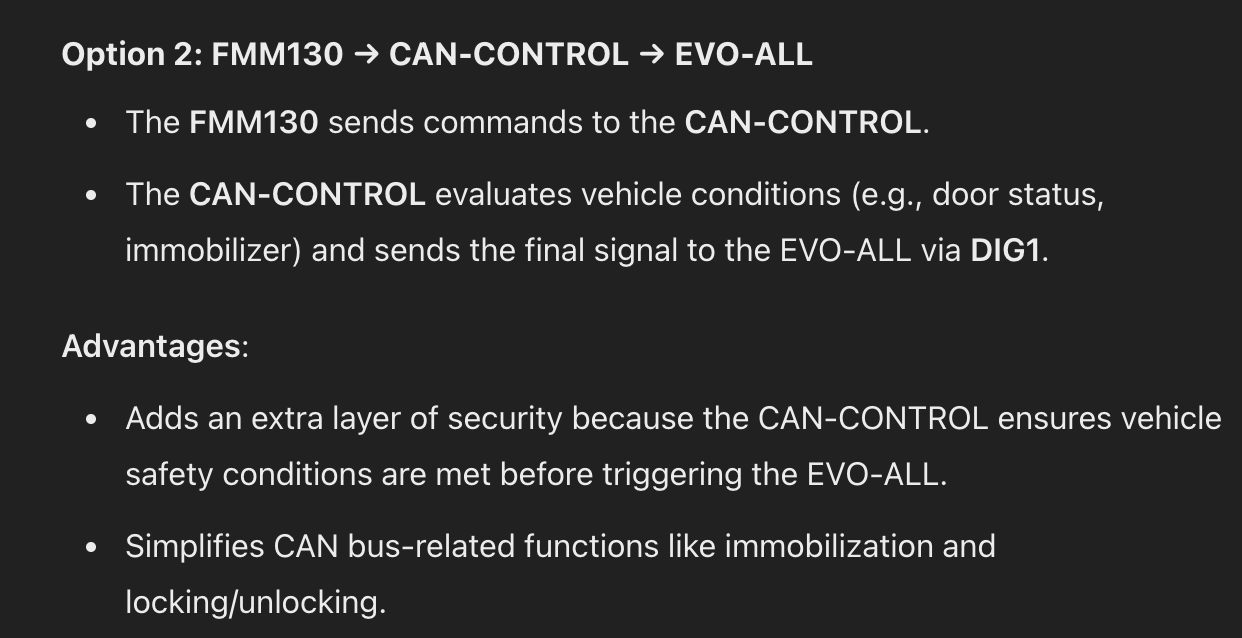

I have a GPS tracking, remote start commands, and vehicle telemetry device along with an immobilizer, door locking/unlocking, and window control via CAN bus. This has yet to be set up.
FMM130
CAN-CONTROL
I need to figure out how to set it up so that I can send a remote command to the FMM130 that would start the car via the aftermarket remote start kit. I have no clue about what I need to do but at this point after speaking with electronic guys I may just buy the tools and do this myself. The GPS and CAN-CONTROL tool do seem a bit complicated so I might have him do that setup since I found one who is experienced but he told me he stays away from remote start kits
ChatGPT says:
