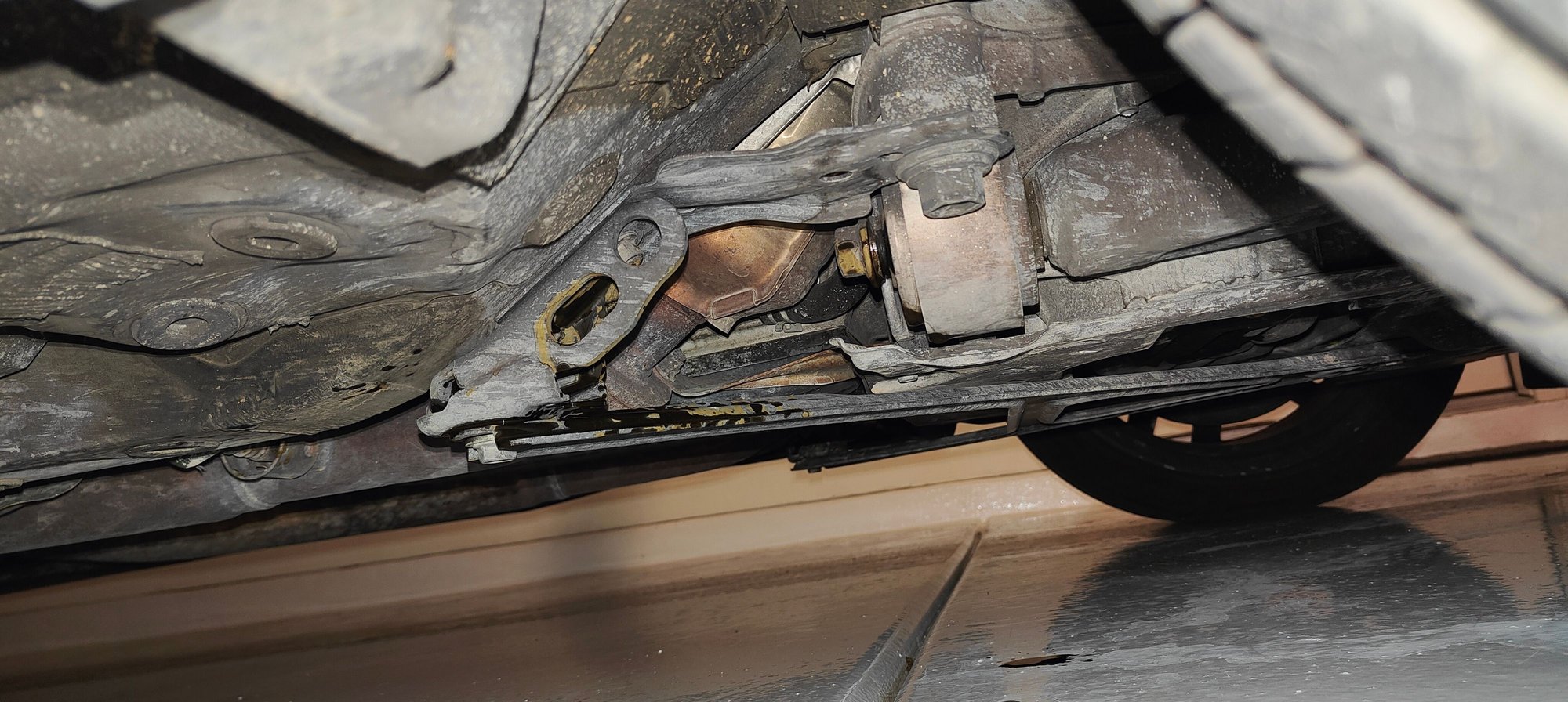

Hello could someone help me identify what this slow leak is coming from? Thank you.

If the top of the lower control arm bushing is dry, I would say that chances are that it is the bushing itself that is leaking.
Can you look upward from that to see if there is a "source" of the drip?
Didn’t think any bushings on this car were liquid filled. Haven’t read of bushing leaks here before.
The first picture seems to show oil on the hex part of the bolt, not what I would expect if that bushing were leaking. Maybe oil was applied to address a squeak?
I agree with looking for signs of leakage above this point.

looks like bushing to me. It also doesn t look like motor oil. Don t think there s a source above that and also it would have to drip right onto that nut, unlikely IMO.
Wipe it down and watch it.
several people told me that stock LCA bushings for IS were fluid filled.

looks more like rusty water.
Hmm. Someday, when I’ve got nothing better to do, I’ll drill some holes into my stock bushings (never gonna put them back on the car) and see if I strike oil (or anything other than rubber).

Hey everyone, just got back from the mechanic. He said he couldn't identify any issue aside from the bushing rubber piece having signs of wear(cracks). The liquid that was present has dried, and is not oil. He also stated that the bushings for this model are not fluid filled(dry). He said that perhaps it was water that seeped into the cracks and it just leaking out, from washing or driving over puddles. I haven't washed my car in a couple weeks and there hasn't been any water that I've run over. Still not clear on the leaking fluid. I will monitor for now. I'll be ordering 2 new front lower control arms, left and right. I figure replace the whole assembly instead of just the bushings. Current mileage is at 167k. I've included photos of the bushings. Let me know what you think. Thank you.
Front left bushing
Front right bushing (issue)

Yup, looks like rusty water.

Buy RCF/GSF Bushings instead of stock ones...your front tires and wallet will thank you
Front left bushing
Unless your LCAs are damaged, you dont need new LCAs themselves. You just need the bushings (either stock or from rcf for slightly more stiff ride and better steering control ).
