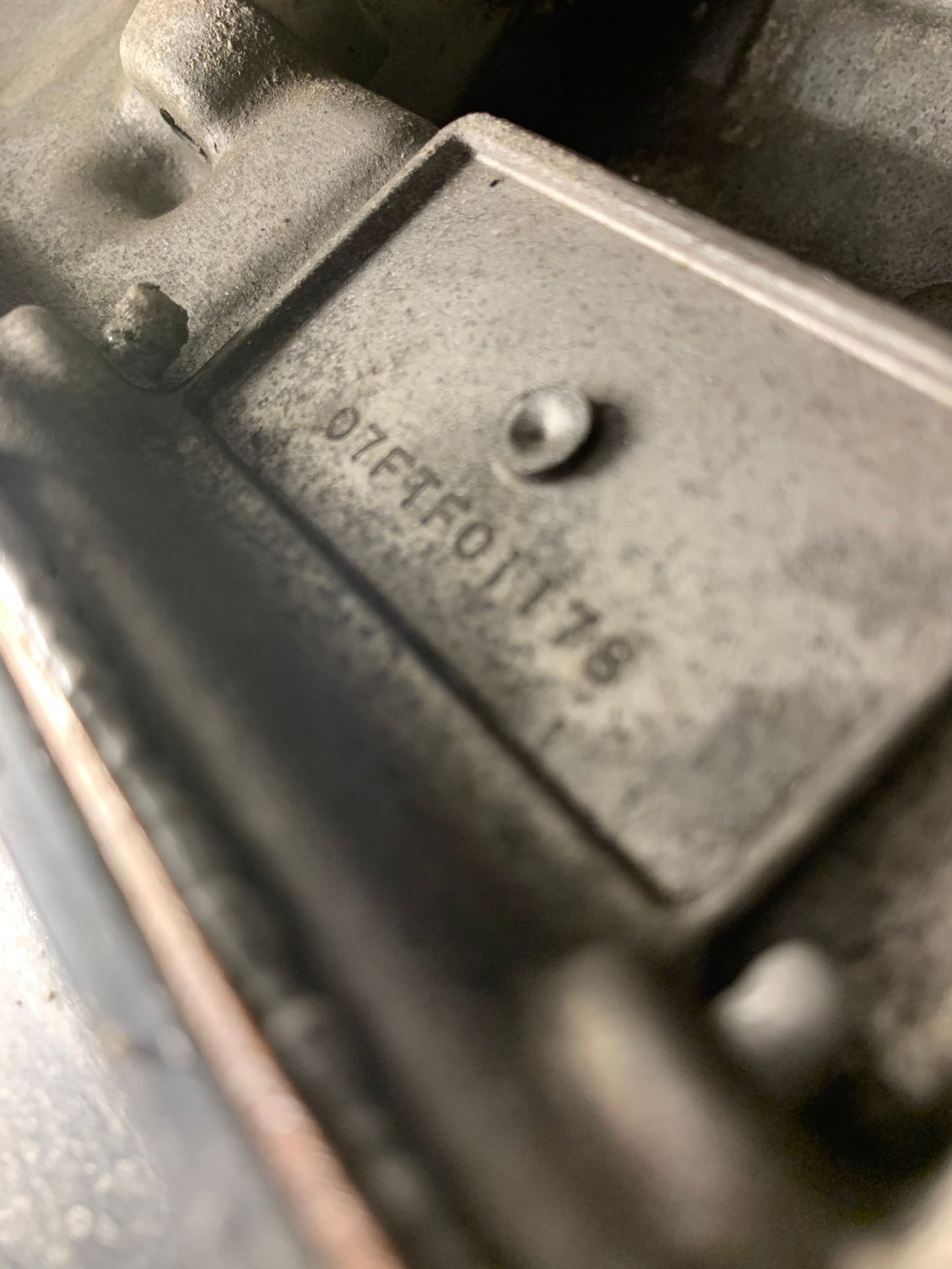

So last week I had my car in to replace my original transmission with a used one from a yard, I’m a bit of a paranoid guy who believes the guy who did the work on my car didn’t replace the unit but instead fixed the issue. Did some digging and was able to find the serial number on the left side of the transmission right on top of the oil pan.
Is there a way I can decode this serial number or figure out if it’s the same transmission or another unit?
below I will attach 2 photos 1 of the serial number and 1 of the EPA sticker. Any help or advice will be greatly appreciated.
Serial Number On Current Transmission Mounted On vehicle
Lexus Transmission Serial Number Decoding Manual ForMy Specific Model (2007 Lexus Is350 RWD)

Didn't you say it supposedly had 30k mi on it? How dirty is the case compared to the cross member and rear transmission mount? If its the same amount of grime you may have your answer.
If you think they rebuilt it vs replacing it, look at bell housing bolts, pan bolts, tailshaft bolts for signs they've been in and out. Most places would clean the case if it were rebuilt, however a slight of hand shop could make repairs and give zero sh/ts about clean and shove it back it. The complication is if the fault was isolated to the valve body and all the did was pull the pan to fix it.
This seems highly suspicious that the trans has the same date code as the cars production release date. And for it to have 35k on it, be that date code, and be that dirty. Fishy....

You might create an account with Lexus and see if when that VIN is put in, you can get some details...

I'd agree check the bolts to see some fresh wear and tear. On the bell housing, and transmission pan. Maybe they just dropped the pan to switch out a solenoid.

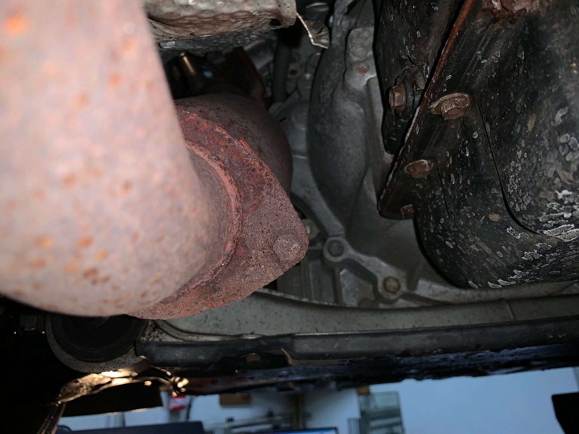

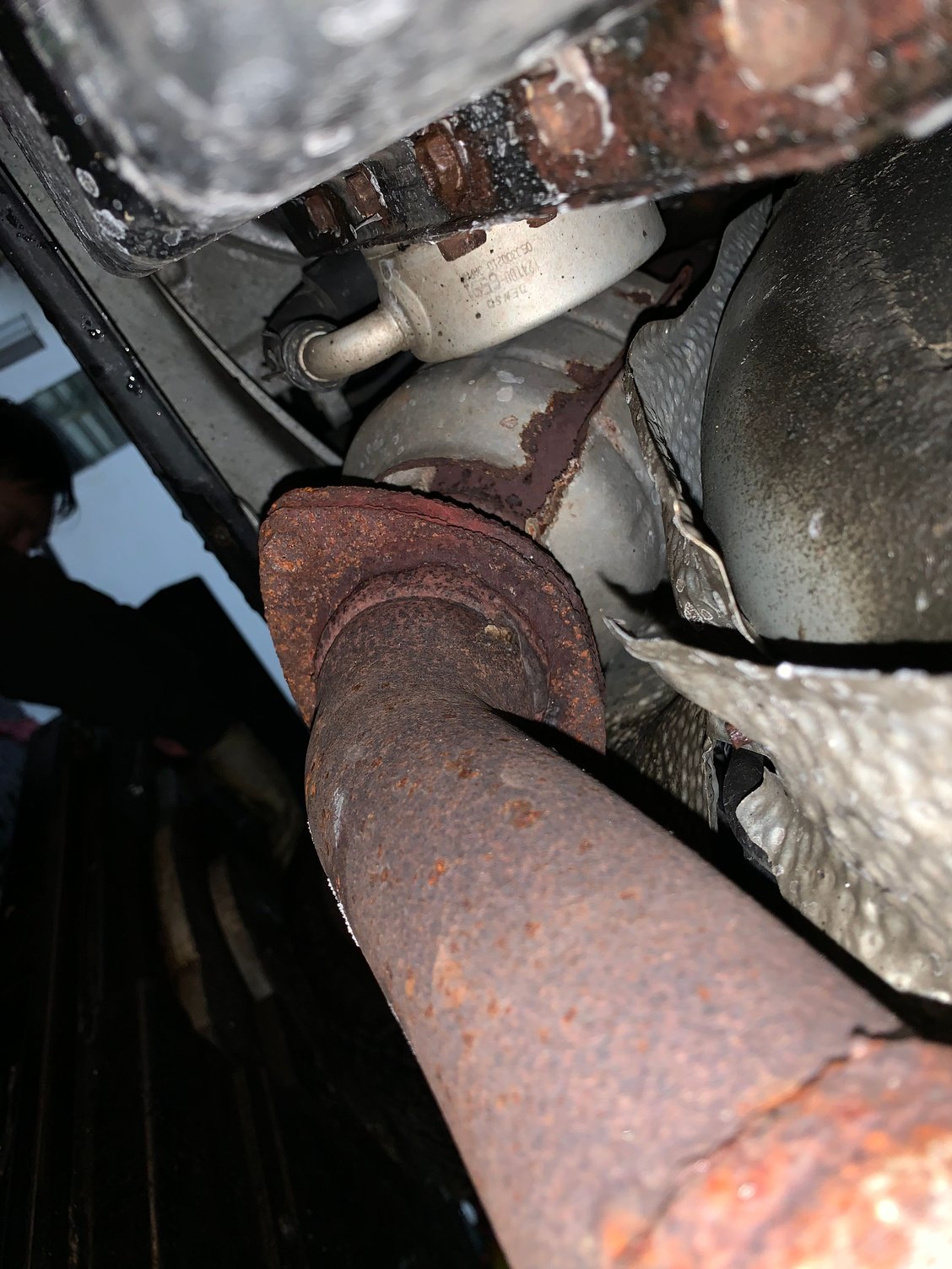

Left exhaust pipe by cats bolts very rusted look unopened

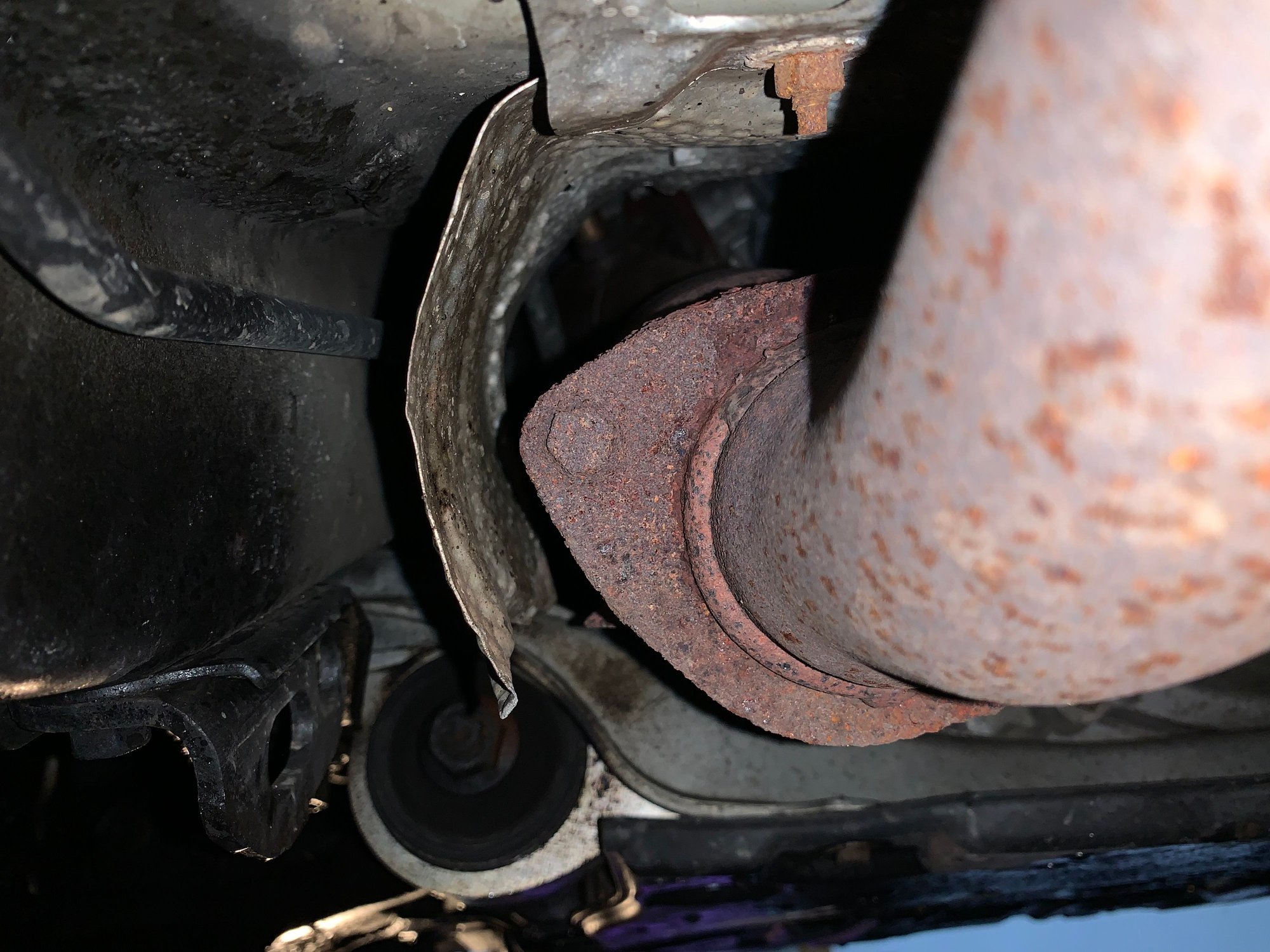

Right exhaust pipe by cats again very rusted definitely never opened would’ve left marks of possibly even snapped

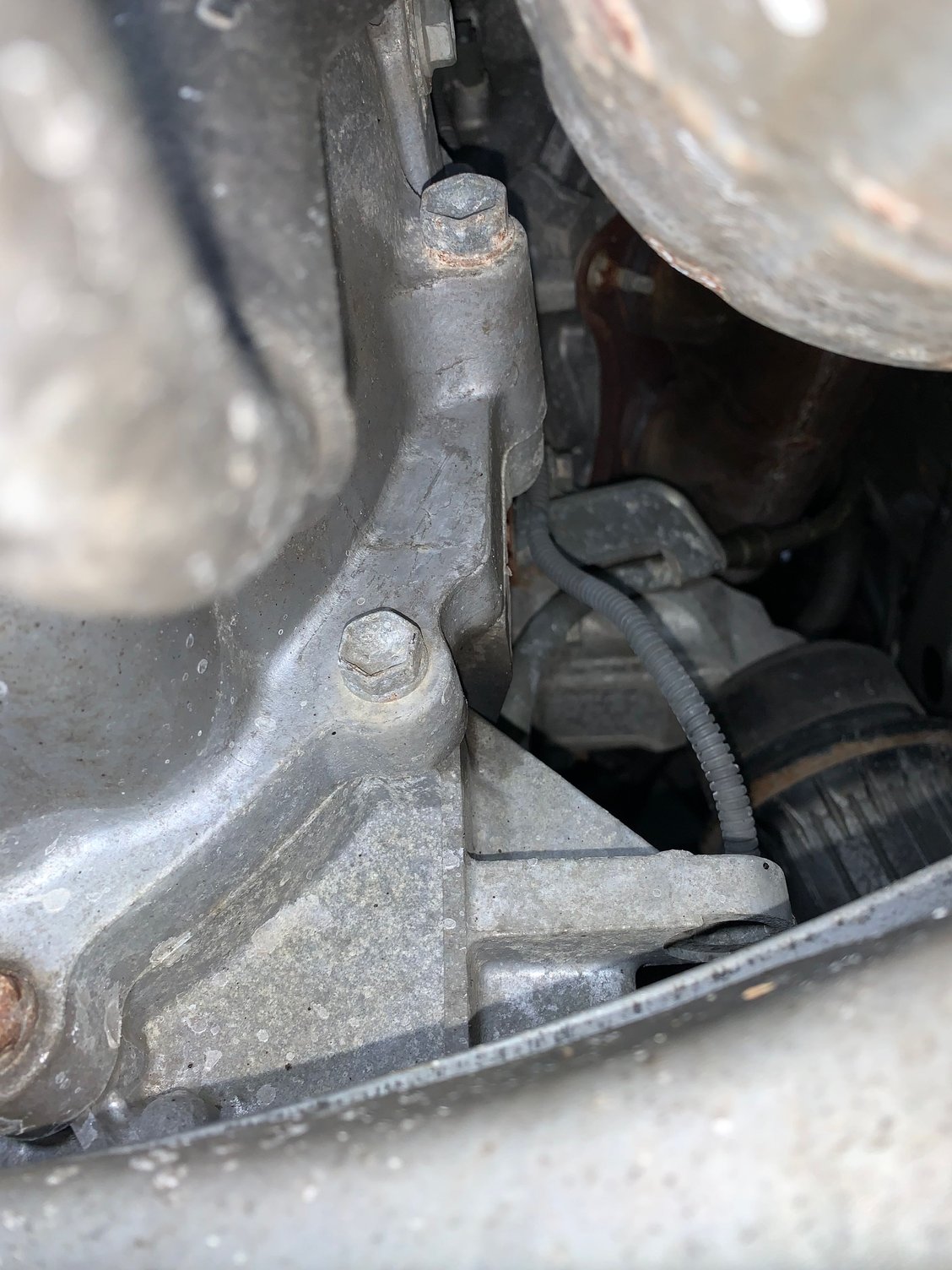

Left side of transmission bolts top one looks touched but others don’t IMO + fresh silicon on pan so definitely dropped the pan (Look at those little black marks or sprinkles and remember that for now)

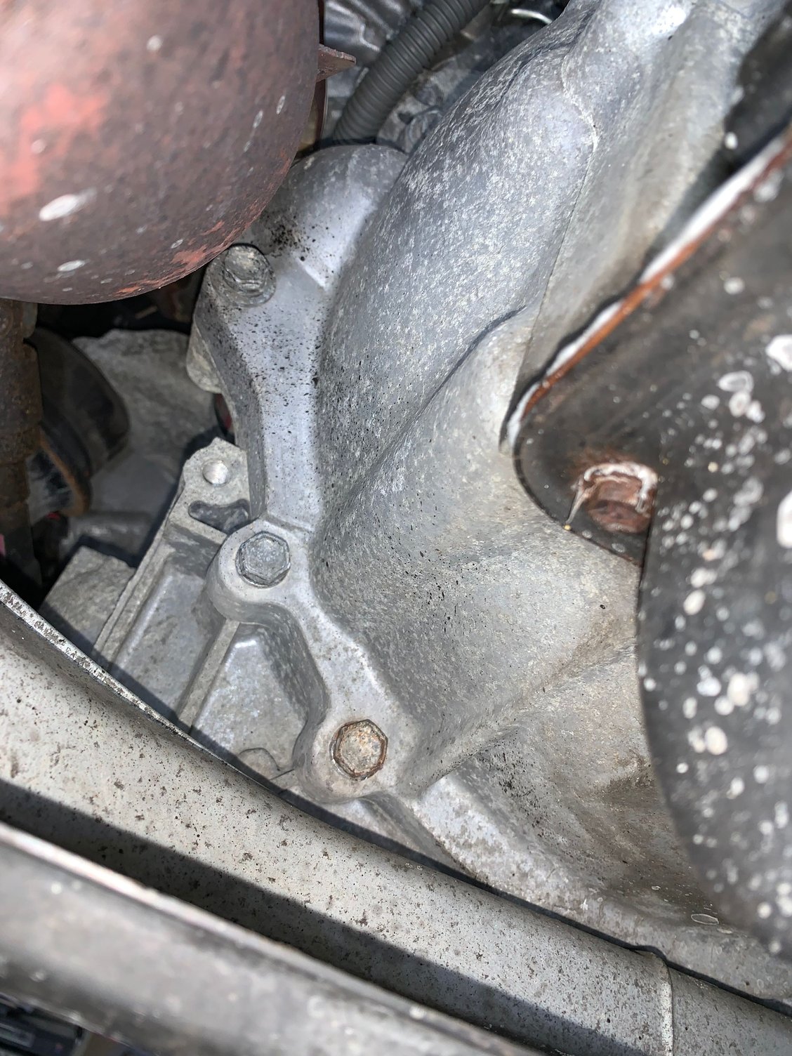

Right side of transmission bolts looks fairly untouched considering you would have to hit an impact causing marking usually? (Black dots a bit on the bottom side remember)

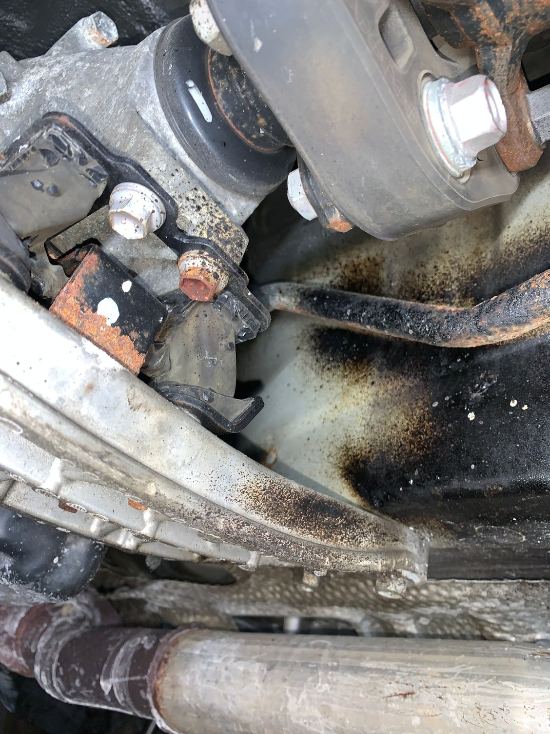

See the black stuff? Yeah I hit undercoating on my car when I first got it (around 13 months ago) see how it’s on the transmission by the 2 bolts? If you look back at the other photos you can see little sprinkles of undercoating that coincidently hit the trans… lucky me I guess. That’s what really convinced me this guy never did any work also see how it’s kind of peeling / chipping kinda shows that’s it’s not a fresh layer of undercoat
Black markings on transmission

I checked, I also got the factory build sheet but no luck, they only had the engine SN on there but not transmission unfortunately

I might have missed it, but don't major components (including transmissions) have a VIN plate on it to match it to the original chassis? Couldn't tell you if a 2IS trans has one though; so this is just talking out loud.
