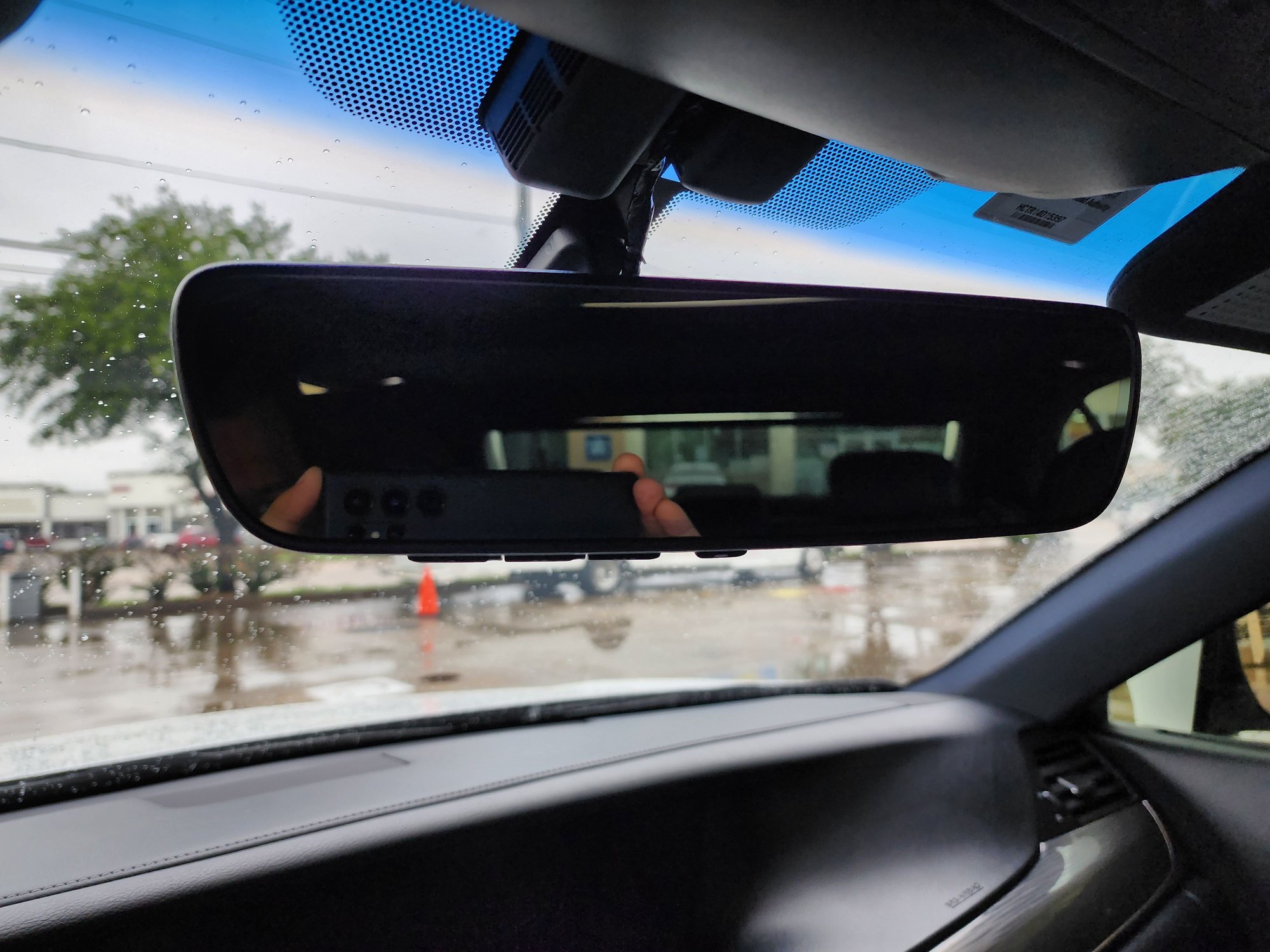

Has anyone installed a frame less Gentex on a 2IS from a 2015+ RC350? It seems to be a drop in. Though I think the rail it sits on might be slightly longer. So it will sit lower in the cabin.
Also I haven't looked at the schematics yet. Does the 2IS has 5 wires or 6?
I put a 2021 ES with compass on my 2013 GS with Nav that didn't have the compass back in October of 23. See pics below. It was the test run with just cut and taped wires. All has bern soldered to look like an oem wire with heat shrink afterwards. So there is no bulge of the wire itself.
Edit well its been done. I'll have to comb through some more threads.
