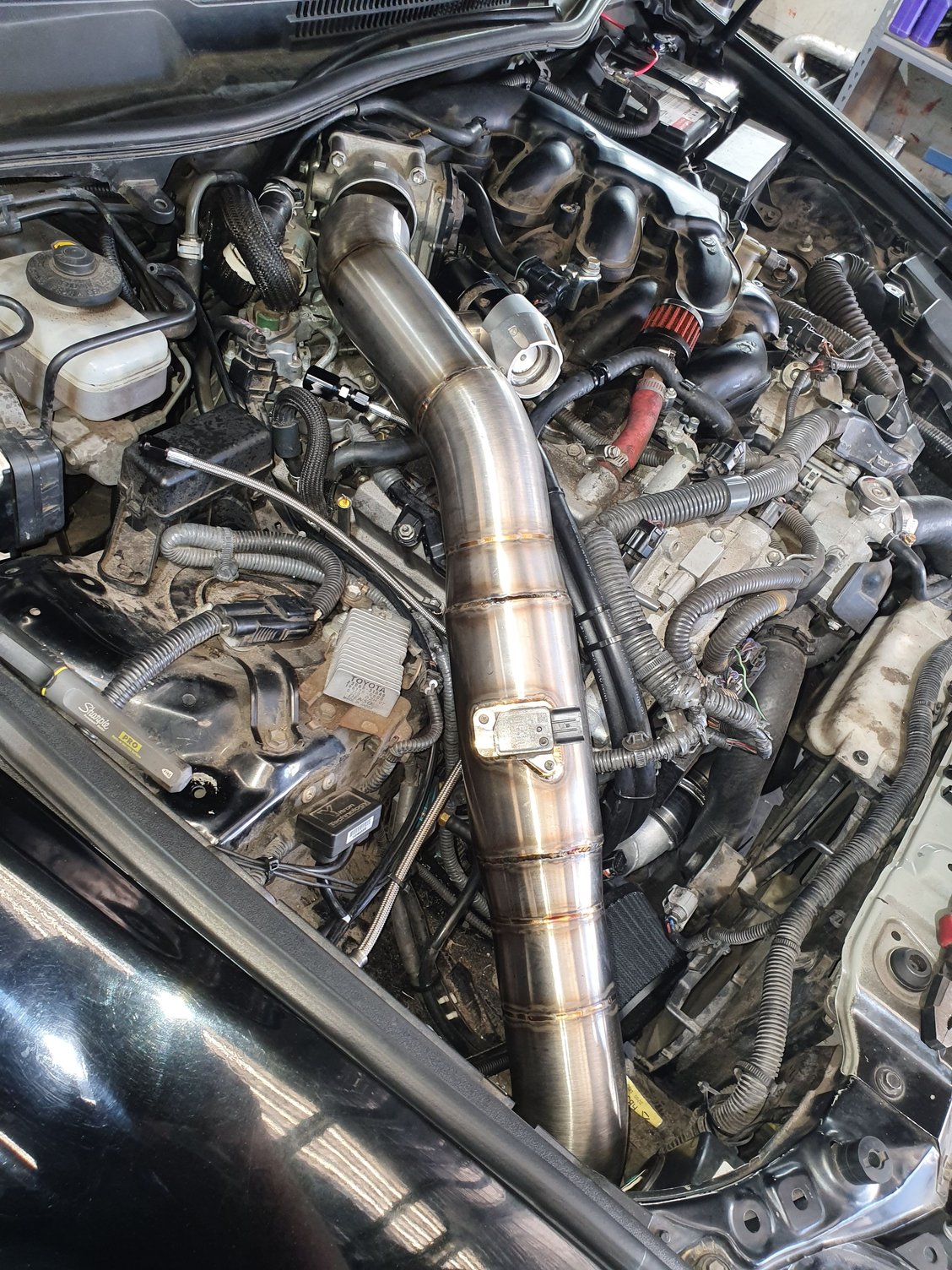

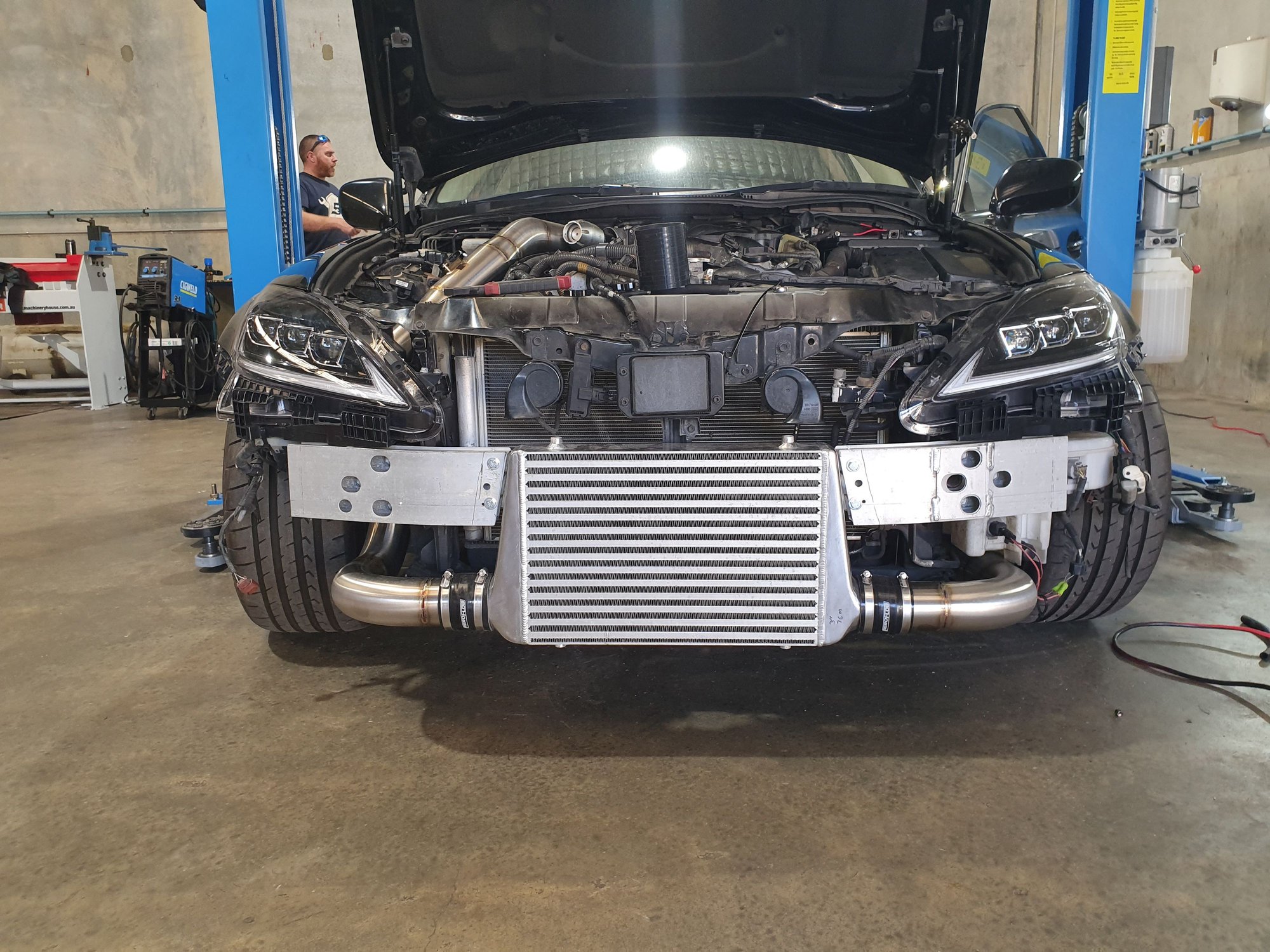

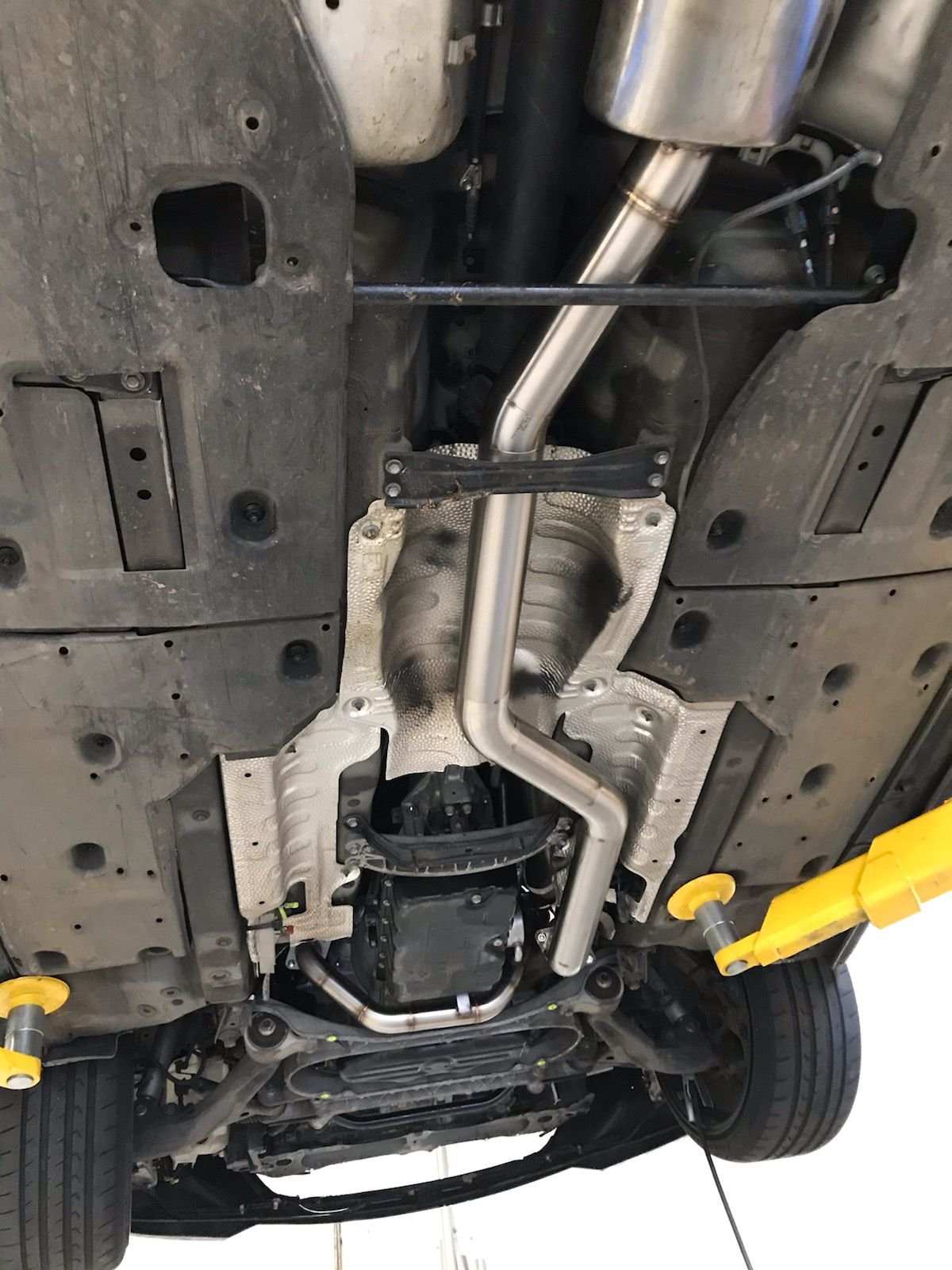

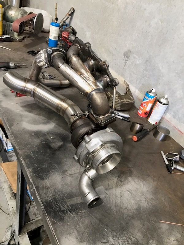

Originally Posted by 2013FSport
More please! ^^!!! Fab person did a pretty sweet stitch job! Very nice! How is fed? i.e. how are the two banks tied to spool the round thing? I'd like to see that!
I'll have a build log on here sooner or later but here's a few pictures
Still a lot of cleaning and up refining to do but as you can see it runs under the trans to join both banks. Unfortunately I don't have a good picture right now of the wastegate setup.
