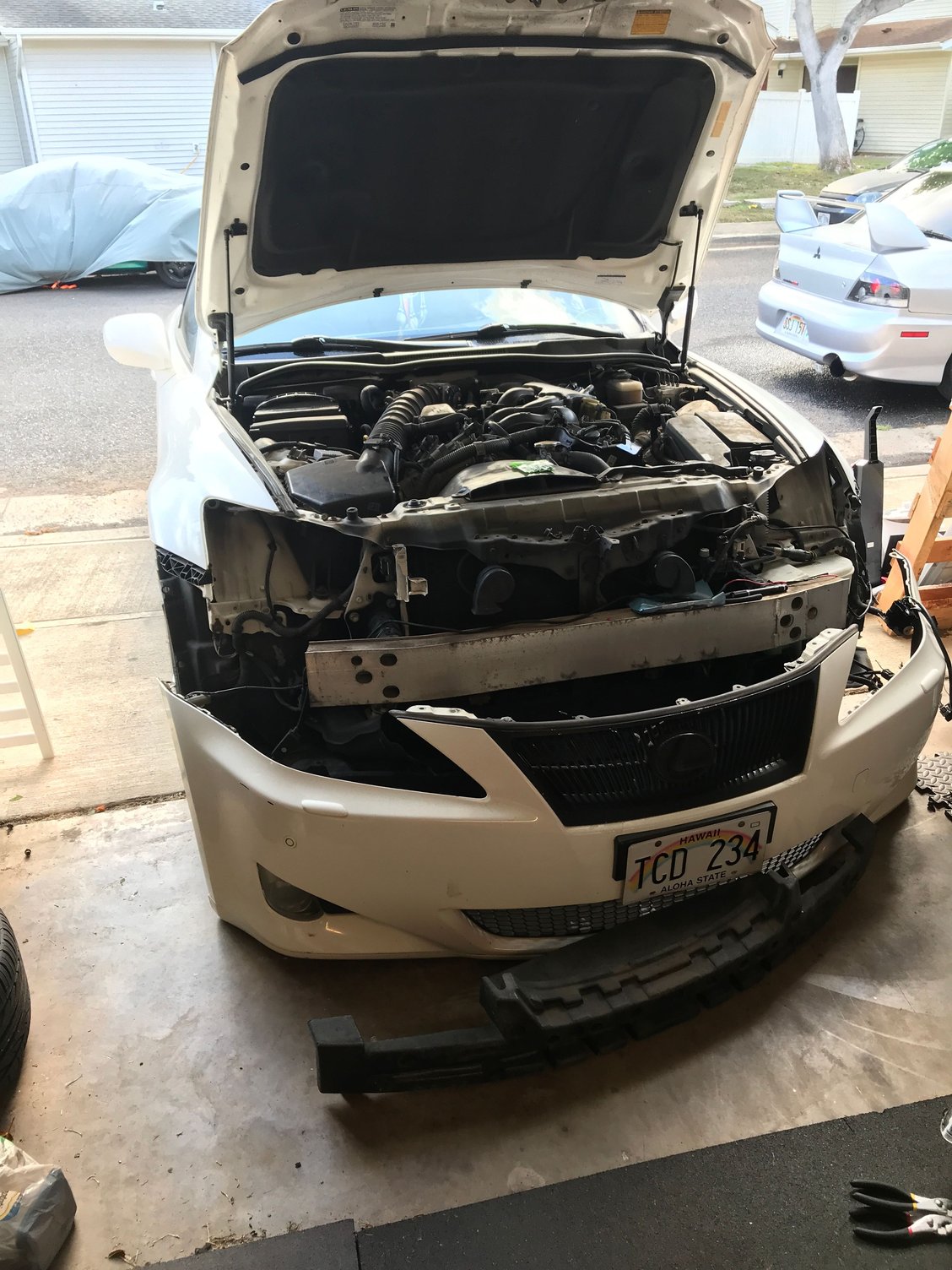

Oh, remove air box on right side. Done in 5 min tops. Left side unbolt the wiper fluid filler neck and there is enough room.

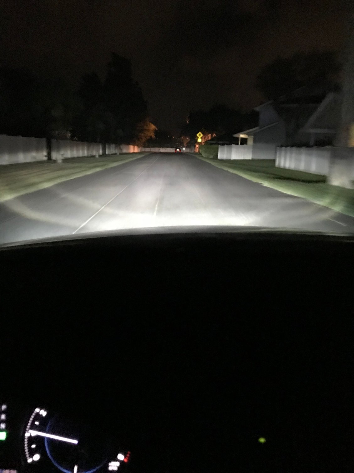

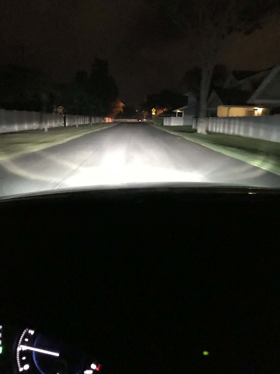

The output once aimed properly with an HID kit makes a big difference. You have to remove a metal cut off plate inside the projector first. Then you will get a non spotty light output on the road.
I thought I had mine dialed in. I may play with it once it dries up to bring the spacing of the beams closer at 25ft.
Right now in have it dialed in at 54.00 inches center to center. I think for the VIPMotoZ the sweet spot is around 50-52".
This set up leaves me with a small gap where the two patterns meet making one pattern on the road.

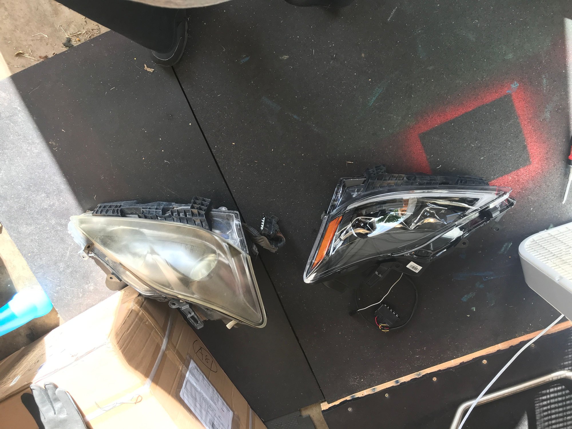

I just bought a set of VLANDs to tear down, inspect and review internal components, and reseal with butyl instead of permaseal.
I am currently stuck on the permaseal and waiting on more specialty tools so its easier to open.
First impressions are that the build quality (plastics, clarity of lens, and hardware) is pretty good. I've open and worked with many OEM and aftermarket headlights including the DEPO and VIPMotoZ and am impressed so far with the outside of these.
Others complain about leaks but the permaseal glue i've been messing with says otherwise, but there might be some gaps for water on a few units.
They come with an auto-level motor used in newer Toyota cars (Tundra LED OE headlights). For 2011+ HID guys, this will work and you retain autolevel (older HID AFS are SOL)

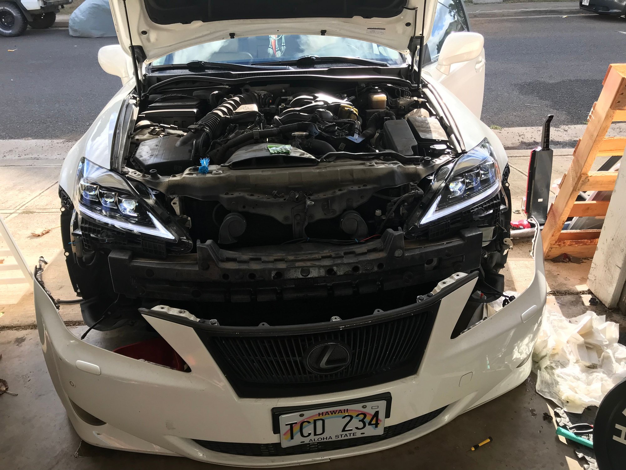

bought the Vland headlights for my 06 about 6 months back, so far so good. You’ll have to manually aim them which can be pretty tedious but output is decent, I only have done city driving and my only complaint is that the high beam is pretty weak compared to OEM but I haven’t been in a situation where I need to use high beams. But my ballasts were going which is why I decided to go with aftermarket in the first place. That, and the lens was basically yellow no matter what I did due to oxidation. I’ve got some pics of how they look but will need to take some more of light output.Originally Posted by gally1998
