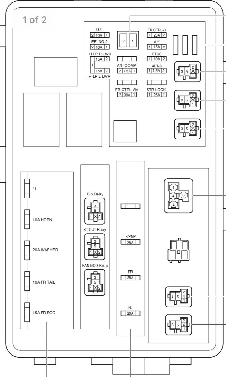

Default ETCS fuse
Hi Jeff
Am struggling to find the
  1. ETCS fuse
My fuse box doesn't correspond with the cover. Have tried to go in the internet for fuse lay out with no luck... See attached my fuse box

The ETCS fuse is in the other fuse box on the LH side of the engine bay.
Jeff

Default Found the bugger
He Jeff thanks a mill found second fuse box under one if the covers, the fuse was blown and manged 2 replace it.
