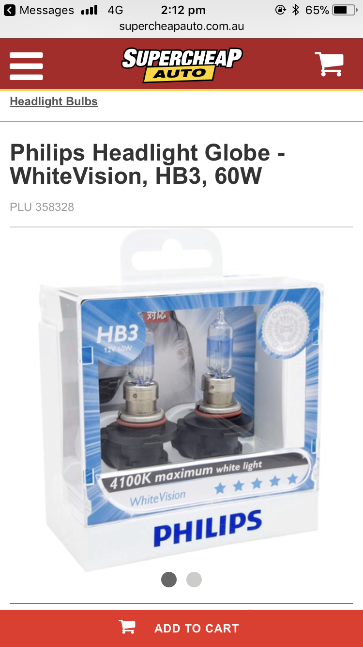

Hi everyone,
thanks for the responses much appreciated!
I might just order the halogens in a white light sounds to be alot easier than LED and gonna give me the look im after...
what do you think am I good to go if i order these two HB3 and H11 same specs?
thanks
