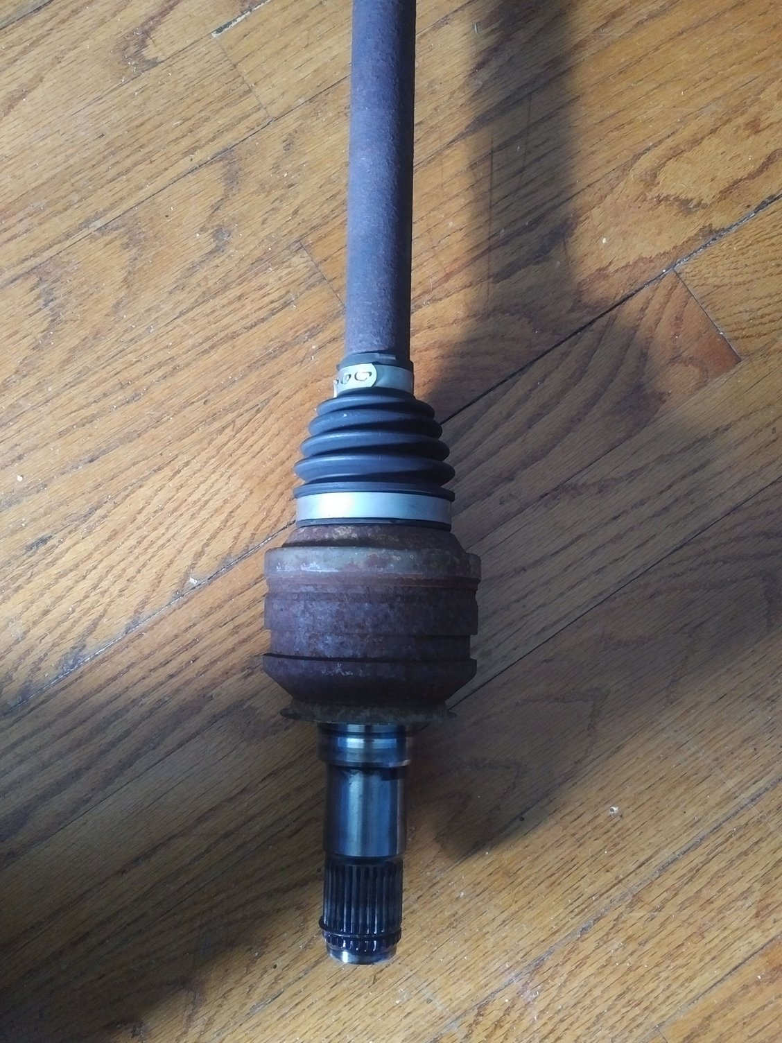

Boots are perfect as far as I can see. Where the bearings/gears are in the metal housing on the outer part seems to be separating. Which is my guess dirt and debris have gotten in.
Curious. Can you post a pic?

So I replaced the rear passenger axle because that was where the noise was coming from. It started out when I was turning right and then started to click when I was going straight so I said it was overdue. Axle has been replaced and all is well now. This was on a 06 IS250 RWD. Figured I would post the outcome as I was having trouble finding info on it
