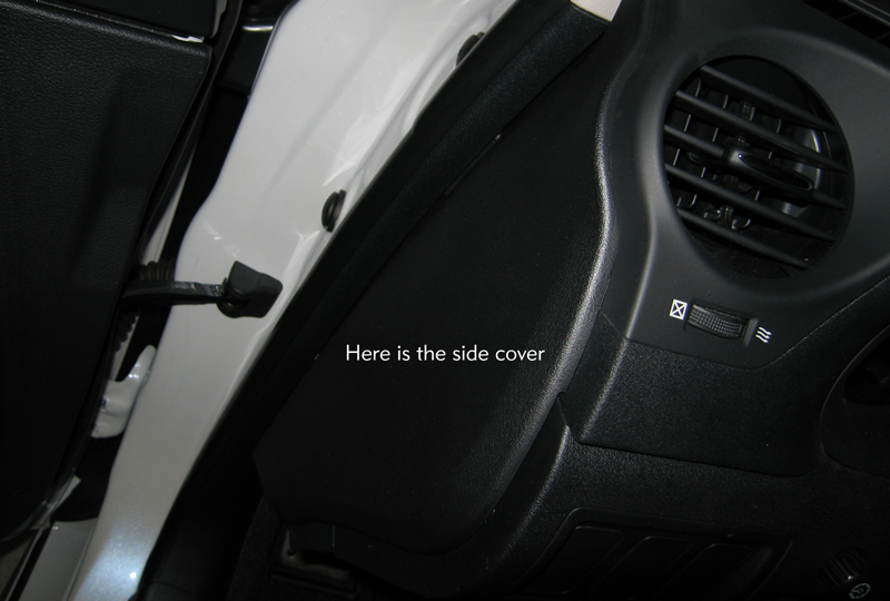

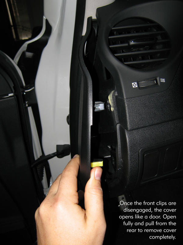

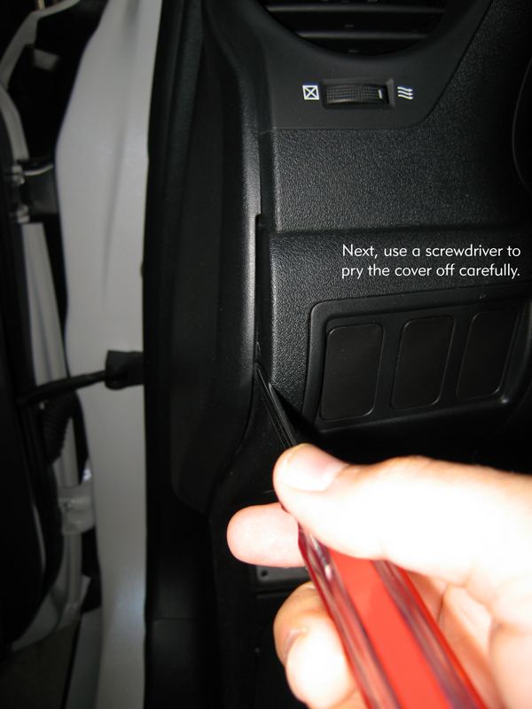

Originally Posted by myis
hi javy, can help elaborate further how to remove the side cover in steps? i m layman having problem doing this. thanks.
Here you go:
Hope this helps!
Javier

One suggestion - wrap the screwdriver tip with electrical tape to prevent scratches in the plastic. It's easy and if you have a cashmere interior, you'll be glad you did.

JavyLSU: Great pics man! I love those captions...
I second Lobux's comment about the black electrical tape on the screwdriver... Always do this... Or use a rubber pry-tool...

thanks javy, your pics is a crystal clear demo!
will also tape the screwdriver tip.
