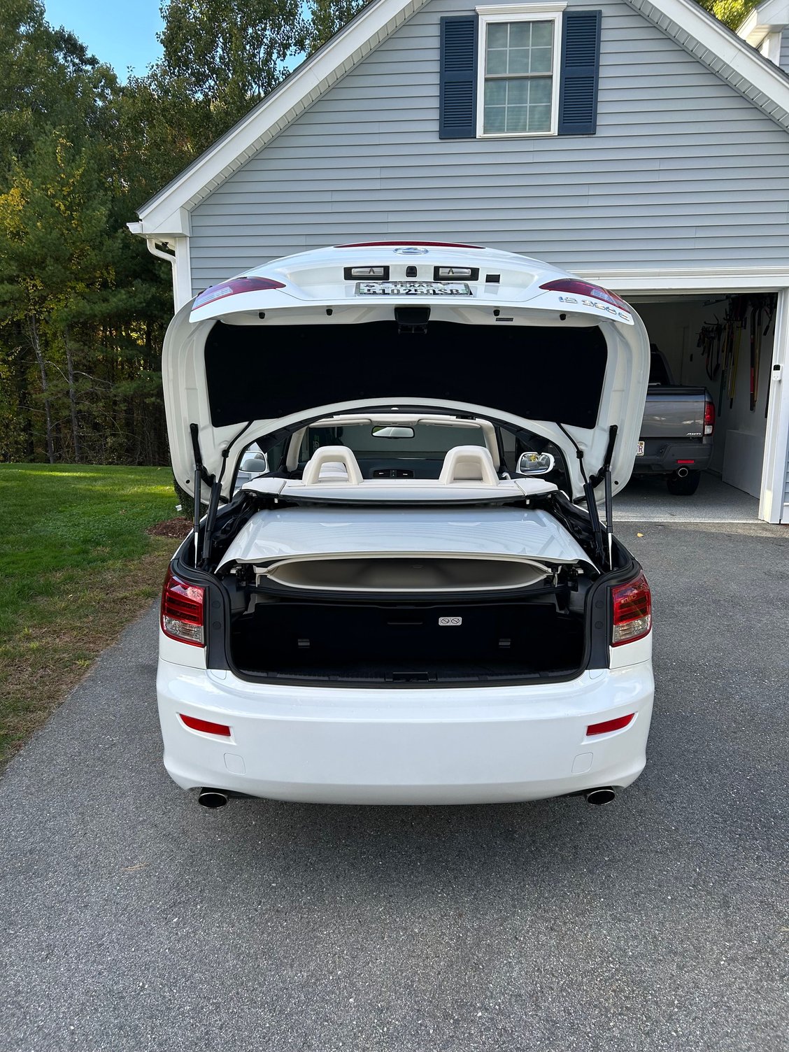

I just got a used IS350C and the trunk does not stay open. Is it supposed to open fully when the trunk open is pressed on the dash? Because it does not. The trunk button in the glove box is in the on position (depressed). When I open it manually (it is heavy!) it does not stay up, and falls closed. See video. Any idea what the problem is?

New lift struts maybe?

Yes , trunks struts but I would get the heavy duty ones that will open the trunk and lift fully open without lifting. Don’t have the brand but I would suggest those. I plan installing a pair on my 07’ IS350 next month, check them out , there should be a few brands to choose from.

Replaced trunk stays
Thanks all for the replies.
Dealer used two oem parts. I assume each side different part number
64530-53032 and
64540-53012
working great now
