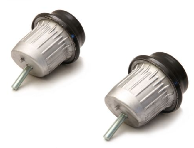

Megan Racing mounts part MRS-LX-0341 (1 Set 2 pieces). - Harden Rubber utilized rated at 70A durometer rating.
APPLICATION:- Lexus 2006-2013 Lexus IS350 RWD Model Only
https://meganracing.com/suspension/t...mrs-lx-0341-ii

Interested if a member has installed the Megan Racing mounts part MRS-LX-0341 (1 Set 2 pieces). - Harden Rubber utilized rated at 70A durometer rating.

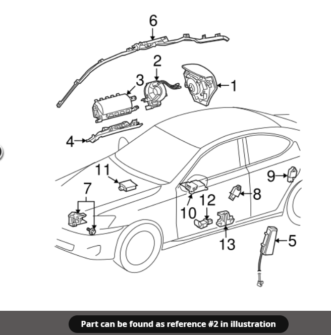

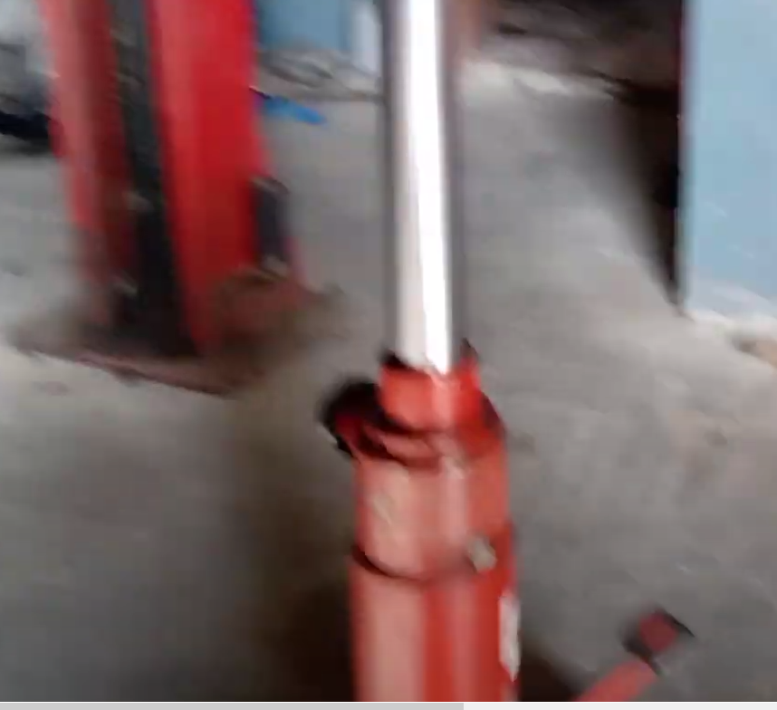

To confirm, replacing the mounts would not require removing the subframe, steering rack or any accessories. If unable to accomplish the removal / installation of the mounts with use of ramps / jacks, the same procedure can be accomplished with vehicle on lift, and using a jack to lift engine as you stated. Came across the following video showing engine mount removal / install for GS350 (year not specified and believe it to be non-US market). Does the IS350 have the same structural parts removed from the GS350 per PHOTO 1 below? I didn't see those parts removed from the IS250 per Lexus 2006 - 2013 IS250 RWD (2.5L engine) video in reply#1. It appears jack was placed on edge of oil pan to lift the GS350 engine slightly to access the 17mm mount bolt in PHOTO 2 (Yellow arrow references the jack and Black arrow references the engine mount location). Jack seen at 3:35 then again at 4:17.

Our cars don't have the extra braces like the IS-F, IS-C, and GS.
As for the rack and anti-sway bar, extra work but likely pays off for esse of access. The AC compressor would be tight so, pulling the rack might be a must. Do NOT rotate the steering wheel or by by clock spring.
Looking at those mounts I figured the engine had to go up further, but that wasnt far. No way id jack on the corner of the pan like that. Apparently not necessary to pull the engine brackets. Any jack would do. It doesn't have to be that. Just get some wood on the pan and move it up.

Understood, thank you 2013FSport (Our cars don't have the extra braces like the IS-F, IS-C, and GS). I was inquiring so I'm aware before hand what is needed to remove / install the mounts, if vehicle is brought to a service shop, so the installation is done correctly.
Is the "Clock Spring" (part 84306-0E010) part of the steering wheel assembly? (pulling the rack might be a must. Do NOT rotate the steering wheel or by by clock spring).
