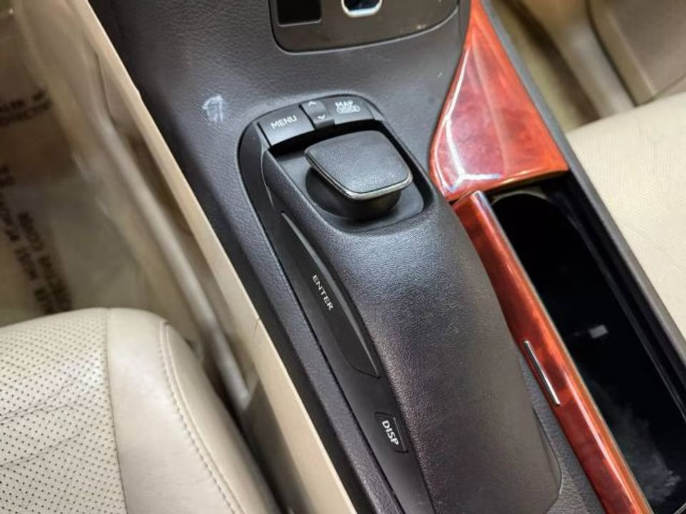

It also had this thing - a "mouse":
Do people find this oddity useful?
