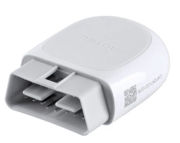

Good news is that the AP200 arrived this morning.
Better news, for the moment anyway, is that after a full 24 hrs of drying out, the P0AAA6 has not reappeared.
Unfortunately there are no DTC's in memory - so I cannot get the INF code - quite annoying.
The bad news is now the AP200 unit is stuck on the OBD2 connector and won't come off.
The unit has a window on the molded shield protecting the male pins, and it has latched onto the female connector on the vehicle, and won't let go.

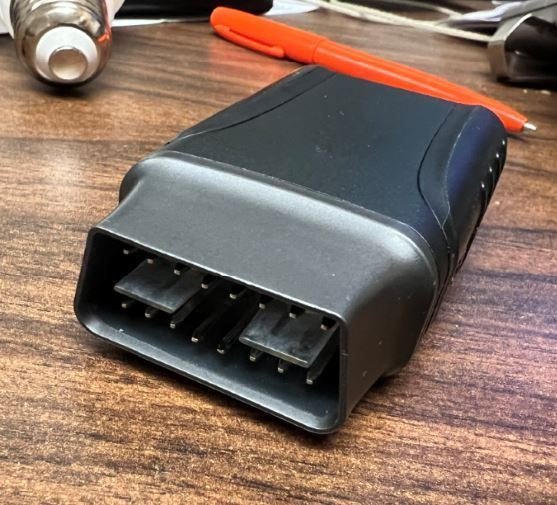

For comparison, here is the XTool A30M

A couple of these tools should release the OBD reader from the OBD connector.

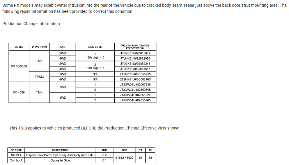

@mafogle The fault code P0AA6 not reappearing sounds promising but you are not out of the woods yet!

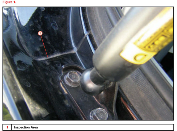

Indeed, there was a TSB regarding water leaks at the liftgate area affecting 2004 - 2009 Lexus RX 330, 350 and 400H. Check your VIN.
You need to water the back of the SUV and observe the seam above the upper back door strut mounting bracket (on both sides of the vehicle) for water. I have attached all the images.
If water is present, send the vehicle to a body shop (per Lexus TSB)
I'm sure you can try to DIY at home. You can apply some type of silicone to the area, wait until it is properly cured, then try the watering method again to see if that stops the water intrusion.
Also remove both rear quarter panel to see if there are any signs of water intrusion, and what damage has been done.
You still might have to access the HV battery area and determine if there is any water damage to the battery itself.

Hey thanks, this is some good info. It looks like my vehicle is one of those effected.
I take it that the spot weld in figure 3 is a corrective action - I don't see any sign of a spot weld on my RX. There is some kind of sealant in the seam, it looks intact, no sign of cracks, but never can tell. when things warm up again I will perform the leak test as suggested.
In the meantime, I got the Autel OBB2 off of the connector using a plastic pry tool, the kind used to open cell phones.
