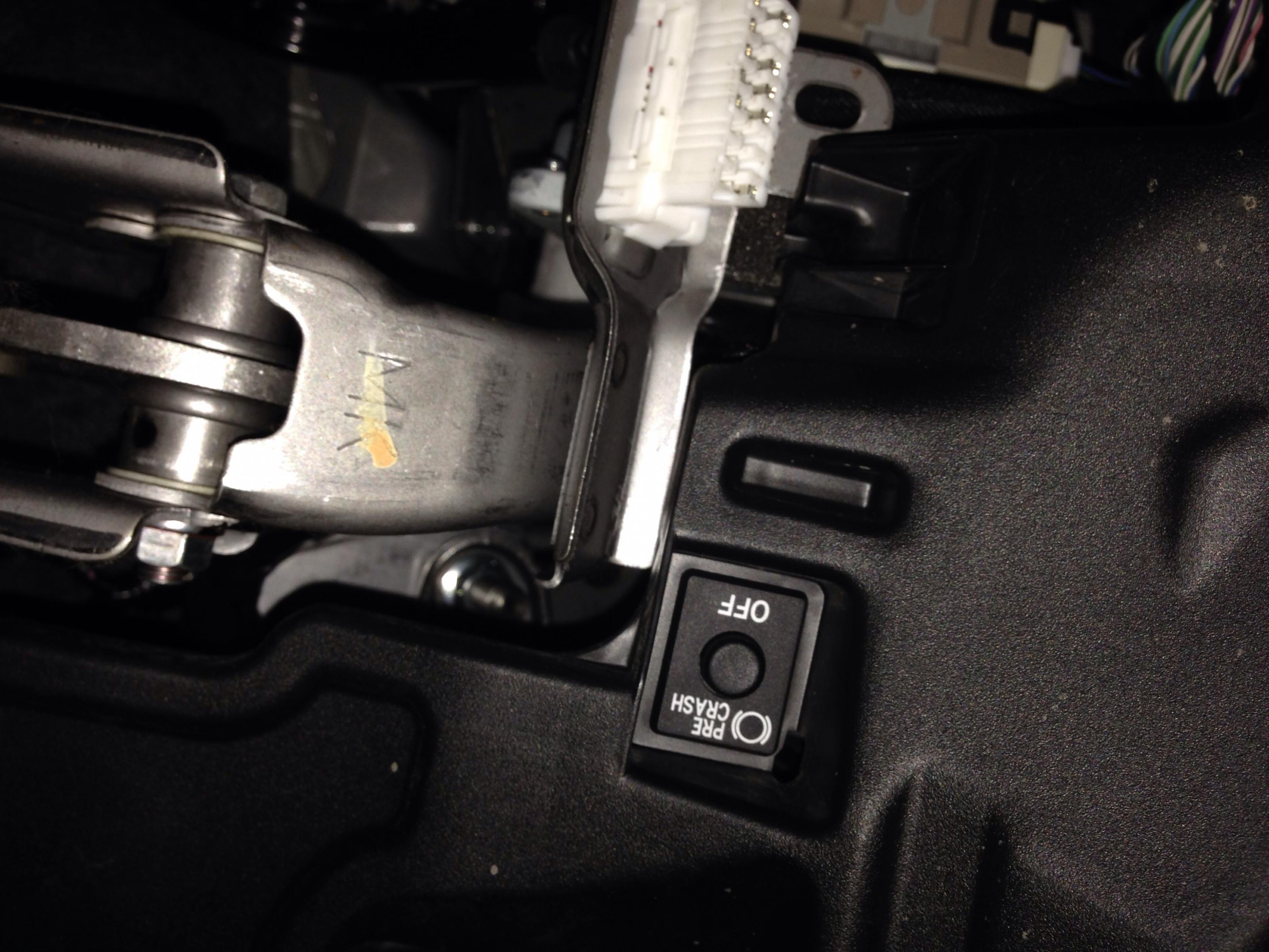

That's right!!! You just reminded me, I took a picture for you. It's in the drivers side front footwell under the dash kinda in the middle. Here is what the switch looks like

thanks. i will look for it tomorrow.
so PCS is always on and nothing shows up on dash like PA, BSM, LDA, etc...?

I found the PCS button. Wasnt turned on, and very very hard to see.
I pushed button in, and now PCS light is showing up on cluster.

If the PCS light is on, the system is OFF. If the PCS light is off, PCS is ON. I think that is why its so hidden so it doesn't get accidentally deactivated.

very confusing. So button is not pushed in now.
indeed it is backwards. I read manual again..."The "PCS" warning light turns ON when pre-collision braking is DISABLED."
