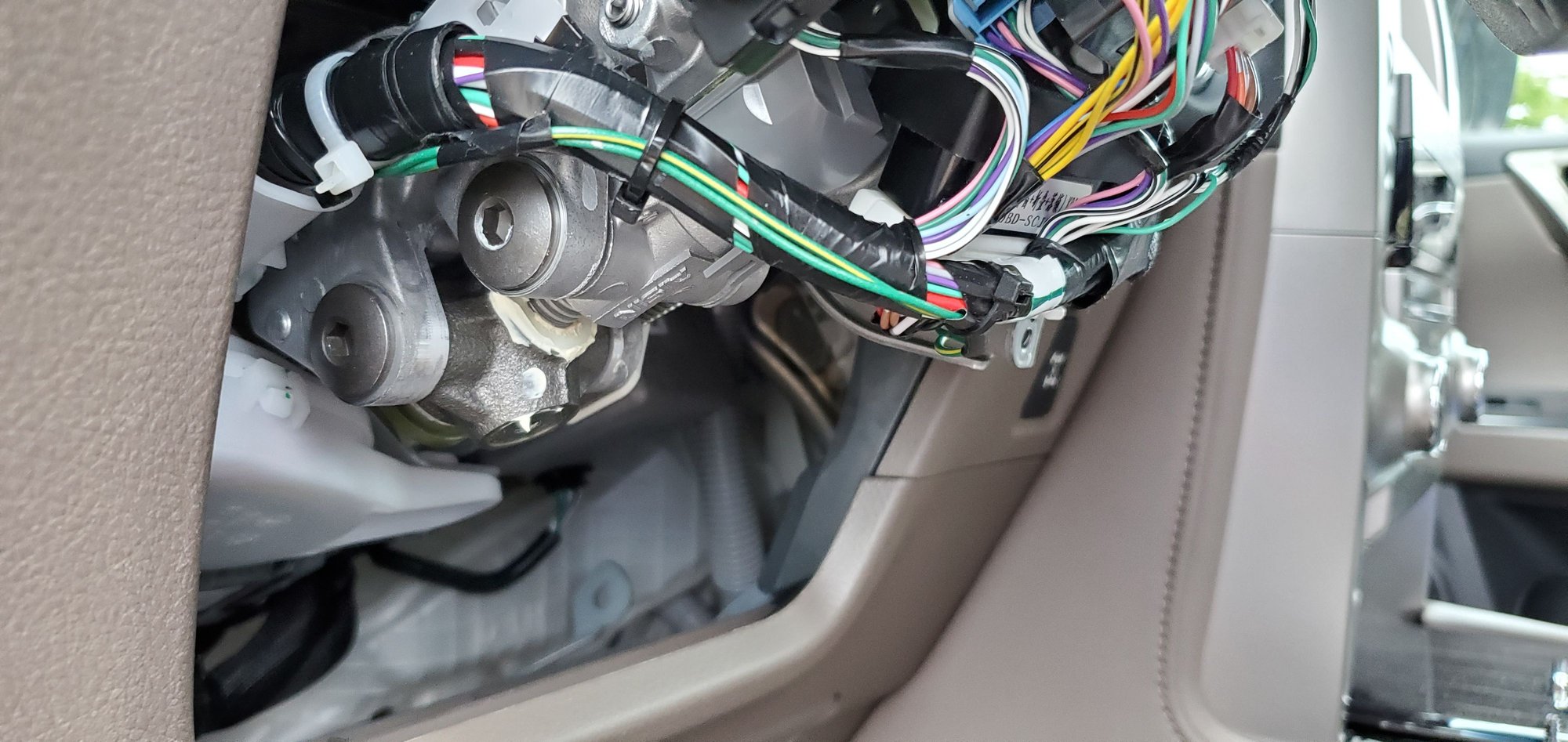

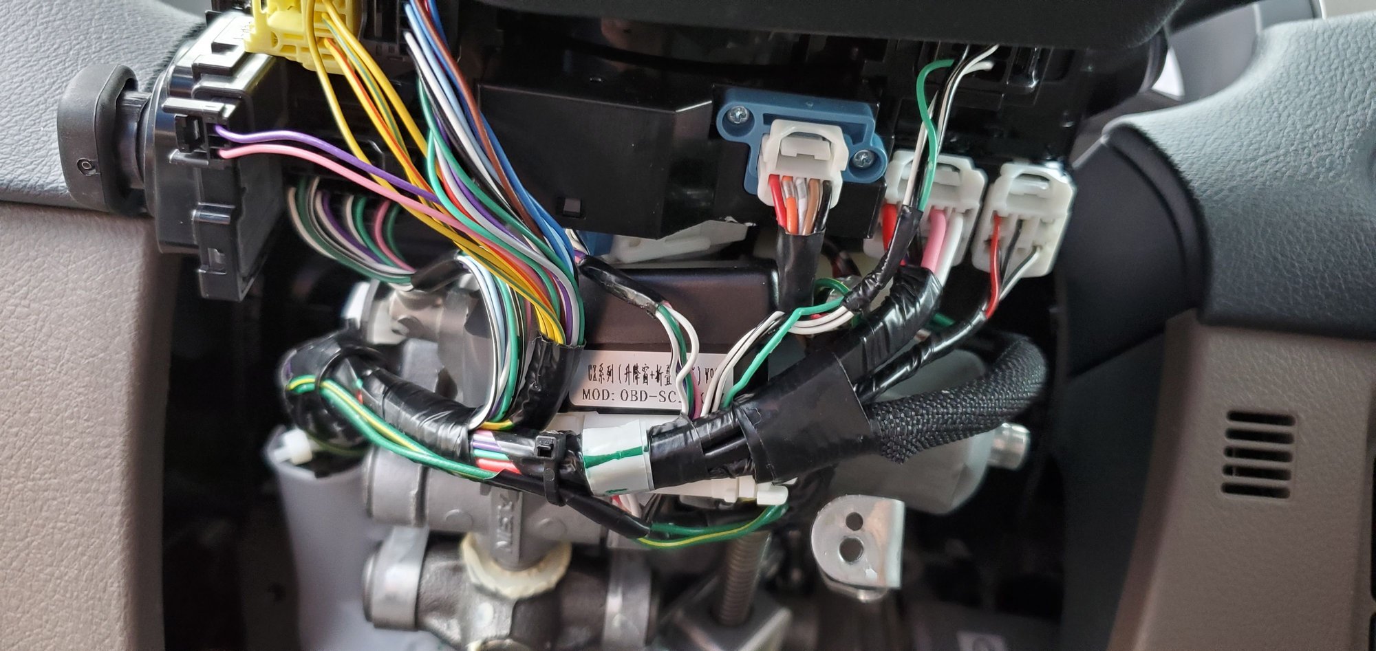

Default Works on 2021 - Instructions (and pictures) included
I just installed the Alibaba version on my 2021, it's slightly different than the older versions. It doesn't plug into the cars OBD port like the older version and you'll need the additional plug that comes with this one.
1. You need to take apart you steering column, 3 screws and a bunch of clips/tabs.
2. One screw is visible underneath the steering column
3. Two screws are on the outside, under the steering wheel (you'll need to turn the wheel to expose them)
4. Use a plastic pry tool to kind of pry apart the housing.
5. I had good luck squeezing the bottom together in order to help loosen up the tabs.
6. Once the screws and tabs are removed, you'll have to stretch the bottom housing over the steering wheel adjustment lever.
7. Now you can see all of the wiring (image 1) in the steering column.
8. Unplug the blue harness (see in image 1)
9. Plug one side of the Alibaba OBD harness where you just removed the blue one from
10. Plug the blue harness you removed into the other empty white harness on your OBD harness
11. Plug the black OBD plug into the big white plug (3rd tail of included harness) (image 2)
12. Test it out and it should work.
13. Do the reverse of everything to put back together.
Image 1: https://imgur.com/RPp4kUh
Image 2: https://imgur.com/QEpAYUS

Can you check if you have a warning sign on the reverse camera screen and if your yellow steering lines still work after this install?
Old May 9, 2021 | 11:42 AM
  #283
PT79's Avatar
PT79
Joined: Apr 2021
Posts: 2
No issues, no warnings and backup guide lines still work like OEM.

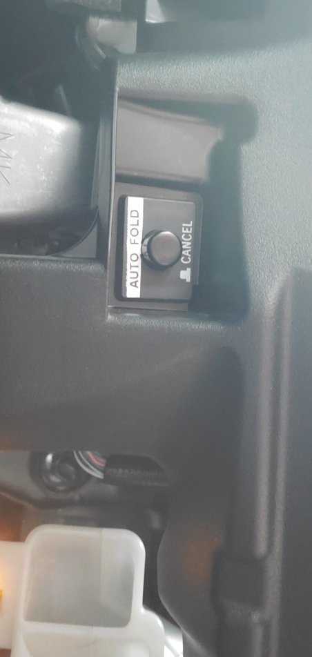

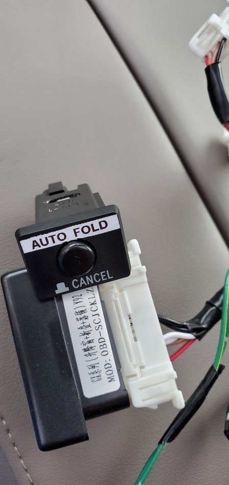

I installed this device with a few MODS.
1. I Intercepted the Positive line and put it through a Switch to be able to turn it off
2. Used a Toyota switch that mounts under the dash, see below...
