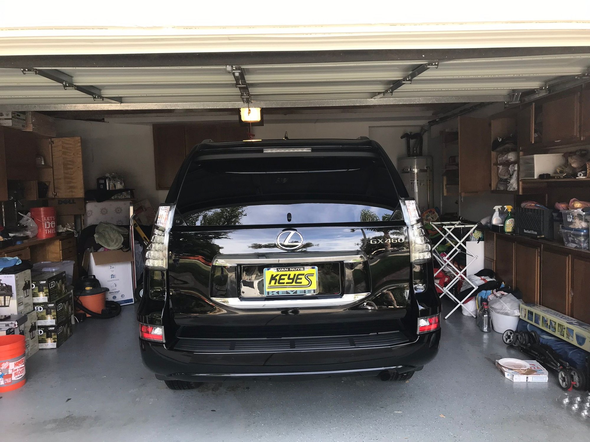

Default Right Lean
After today's wash - I realized looking at the car in the driveway, it leans pretty bad (to its right). I know my driveway isn't leveled - but just looking at the pictures, it seems pretty obvious. I thought this issue was long resolved (my GX is built 07/18 w/no air suspension).
Here are a couple of pics - what do you guys thing?
Old Nov 4, 2018 | 01:08 PM
  #217
jkonquer's Avatar
jkonquer
Joined: Jul 2014
Posts: 974
Likes: 79
the 2nd picture looks pretty leveled.
Old Nov 4, 2018 | 01:22 PM
  #218
tecman's Avatar
tecman
Joined: Aug 2013
Posts: 4,873
Likes: 1,432
Hard to tell with the pics.
