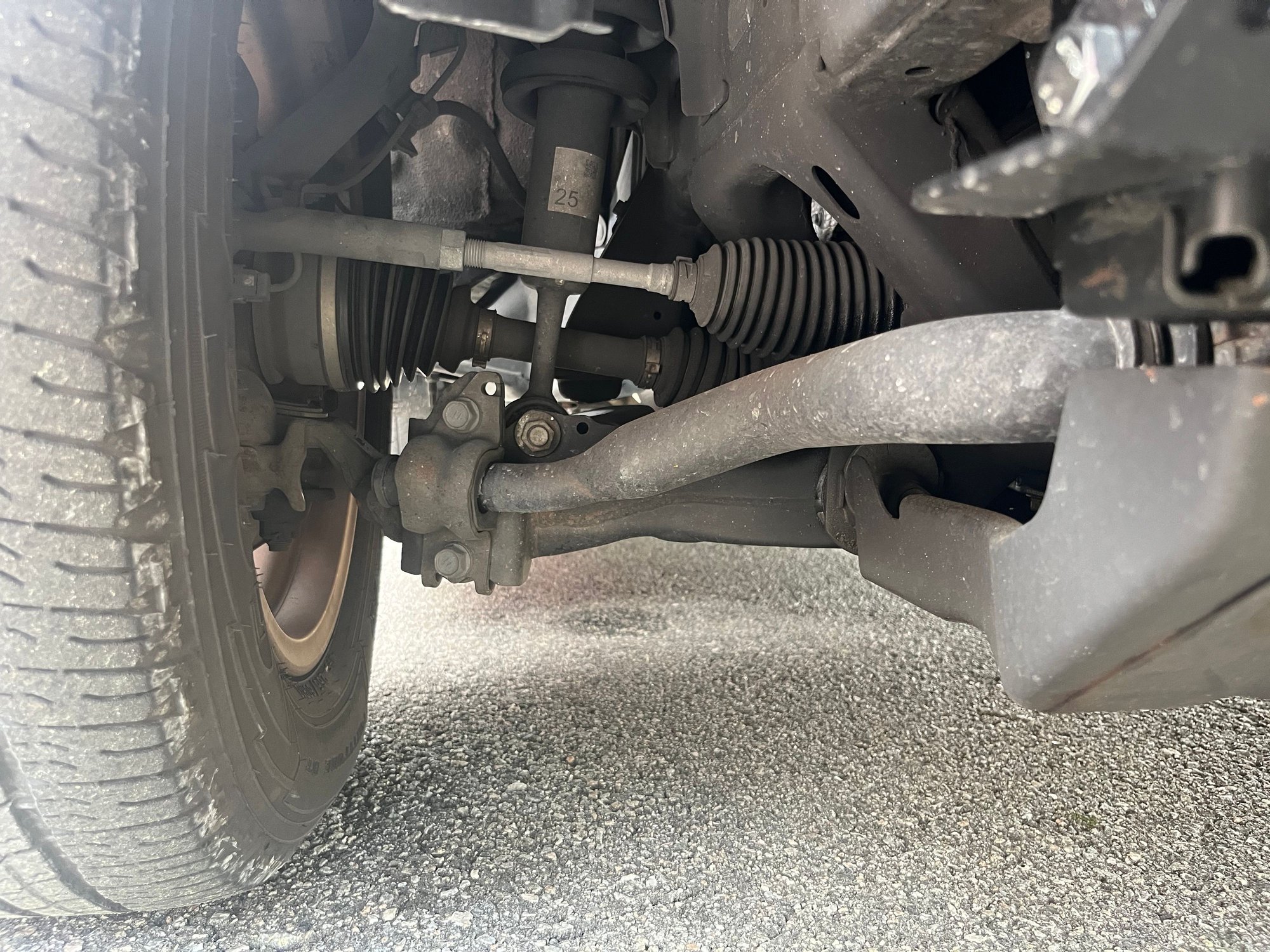

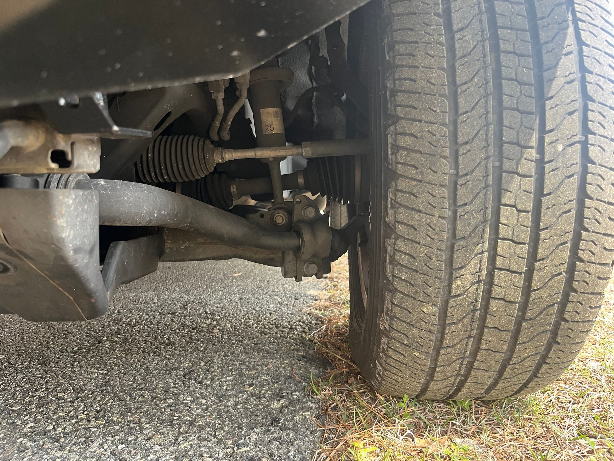

2012 KDSS 176k stock everything suspension. Ironman off-road bumper. (Condition existed before bumper)
I’ve got the lean and the KDSS trick doesn’t do anything. I also noticed my CV axles have some negative pitch in them (slope up toward the wheel. So does that mean I have sagging springs also? I was thinking of installing the new front left spring from the service bulletin but now I’m worried I need to replace both. Maybe just replace with aftermarket?
thoughts?
thoughts?
How many miles on the GX and what year?, apologize in advance if I missed it form earlier post.
No. Also the service manual provides correct ride height measurements so you can see if it is in spec.
Well if you want to lift it, then there are aftermarket options, search the forum.
