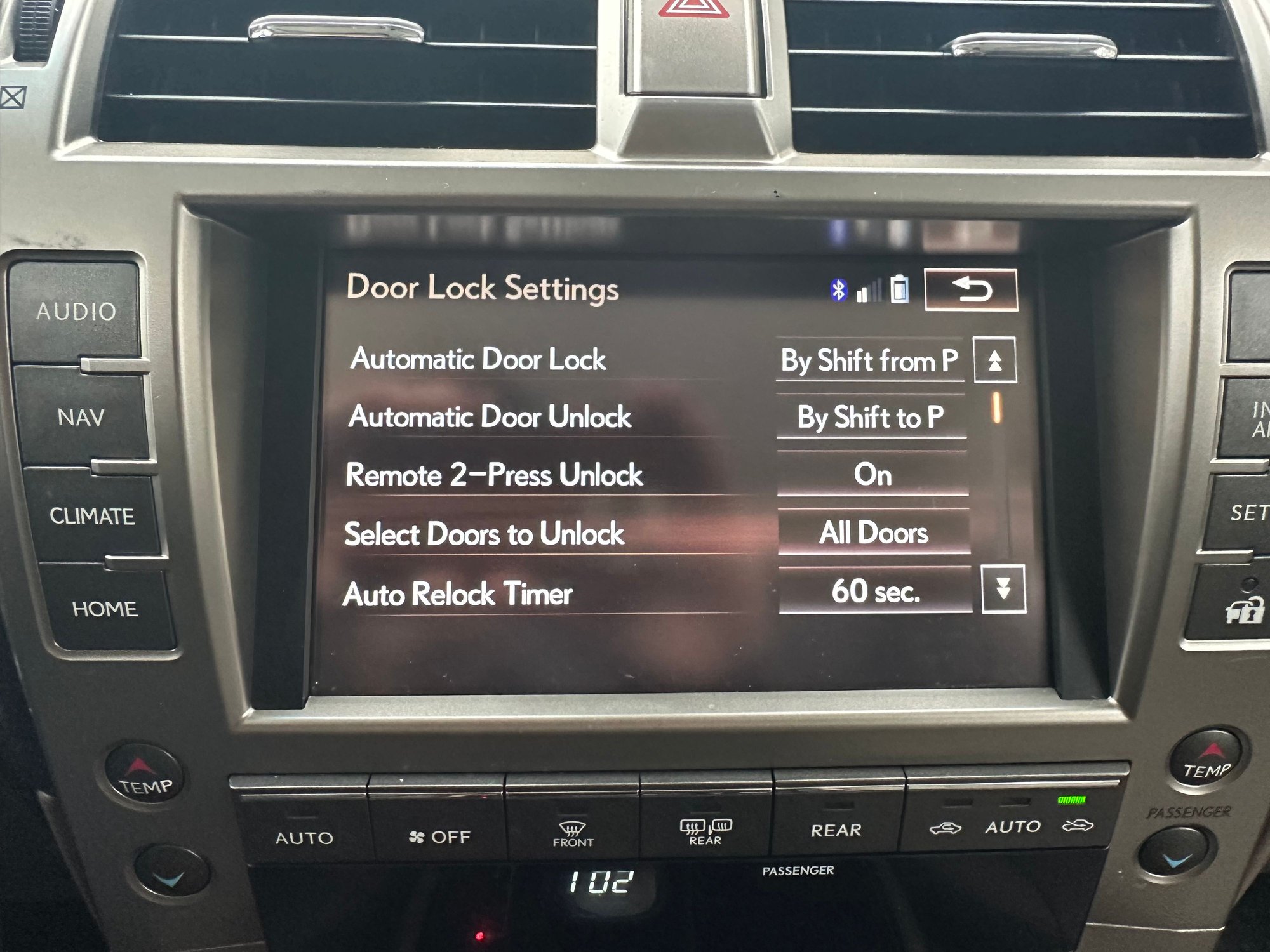

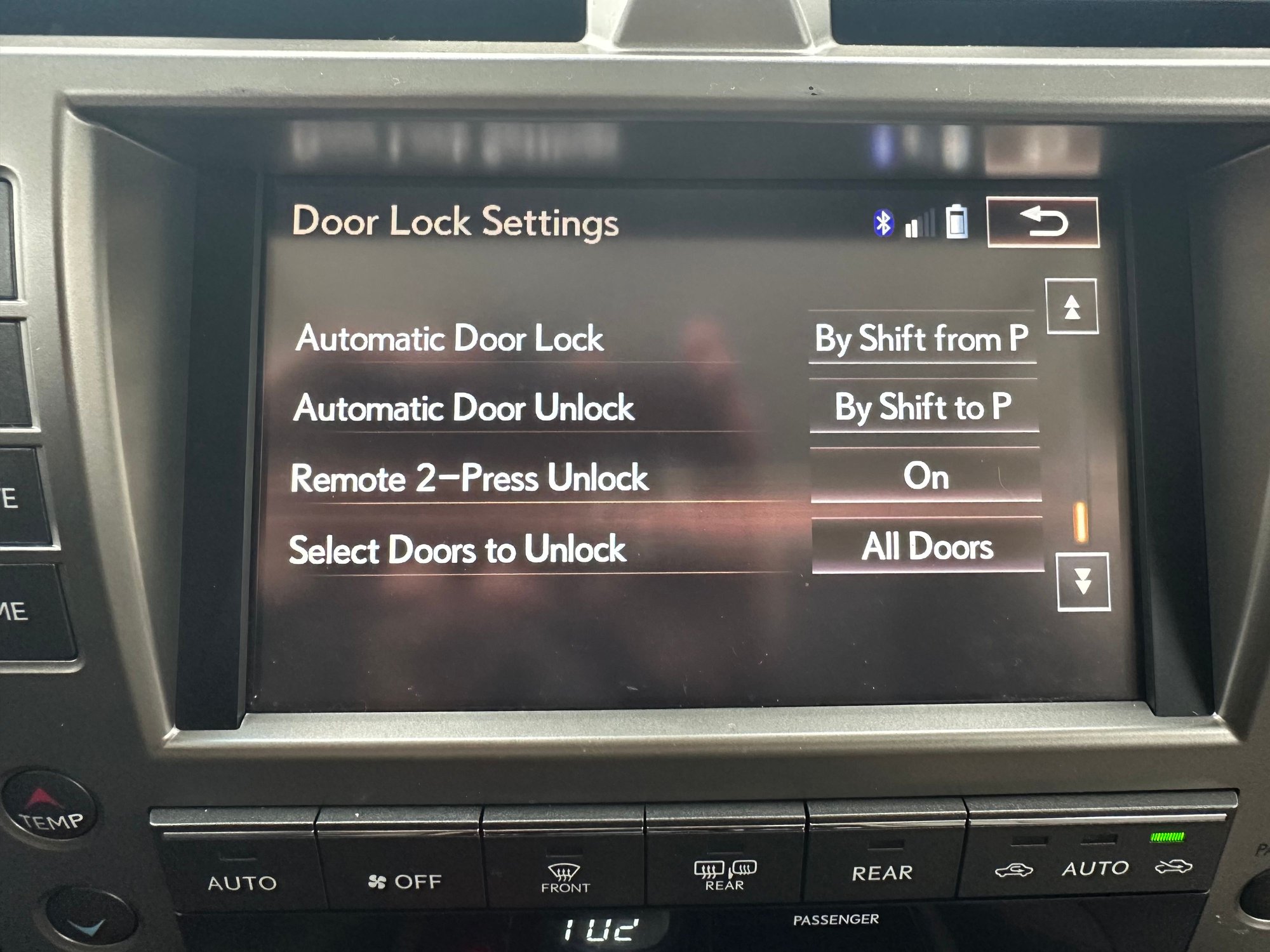

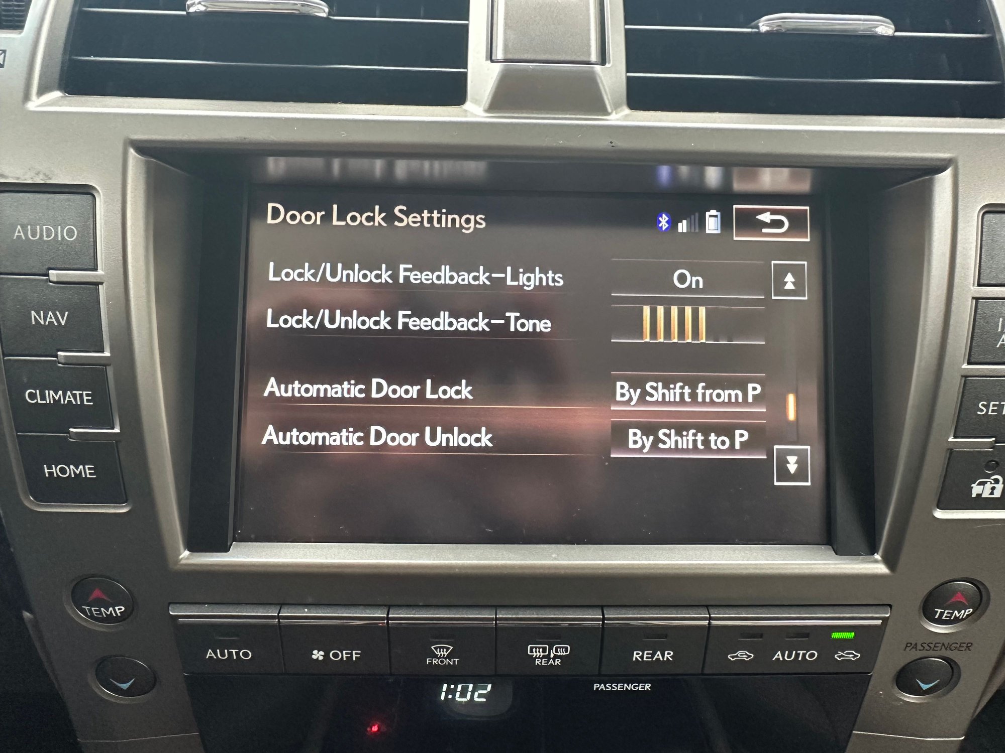

thanks these are the options I have in that menu:

Interesting as they do show option there for 2021 in the LPS document for 2021 at #7 but 2022+ (#16) they made it dealer only
https://lexusgxor.com/_media/general:22_gx_lps_cst.pdf
https://lexusgxor.com/_media/general...r_lps_form.pdf
https://www.clublexus.com/forums/gx-...tings-lps.html
