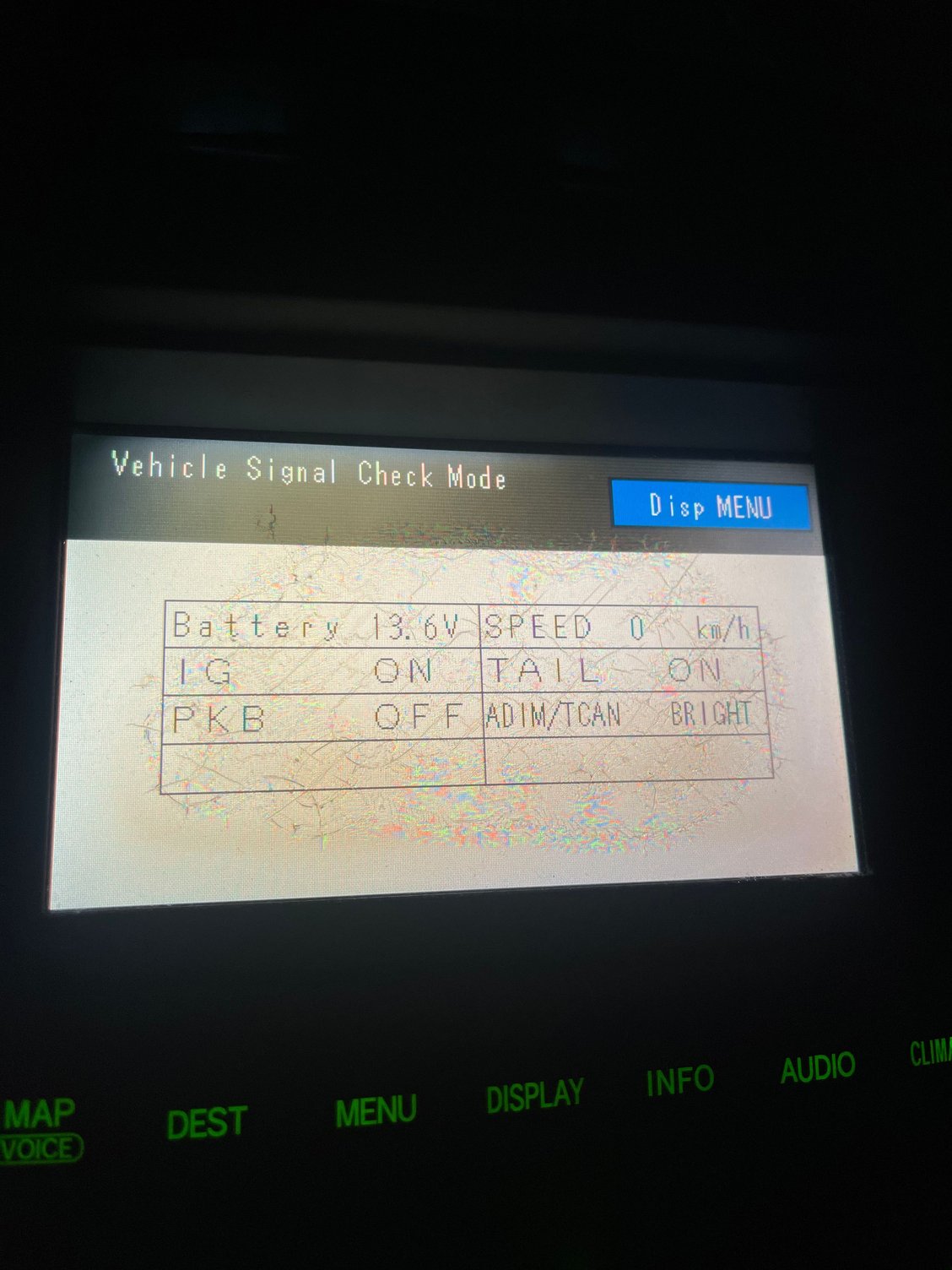

What do you mean ran diagnostics- You took it somewhere to load test? Also how old is your battery?
There is a self diagnostic test you can run if you hold the info button down and flash the lights 3 times and the battery was recently replaced a little over a year ago.

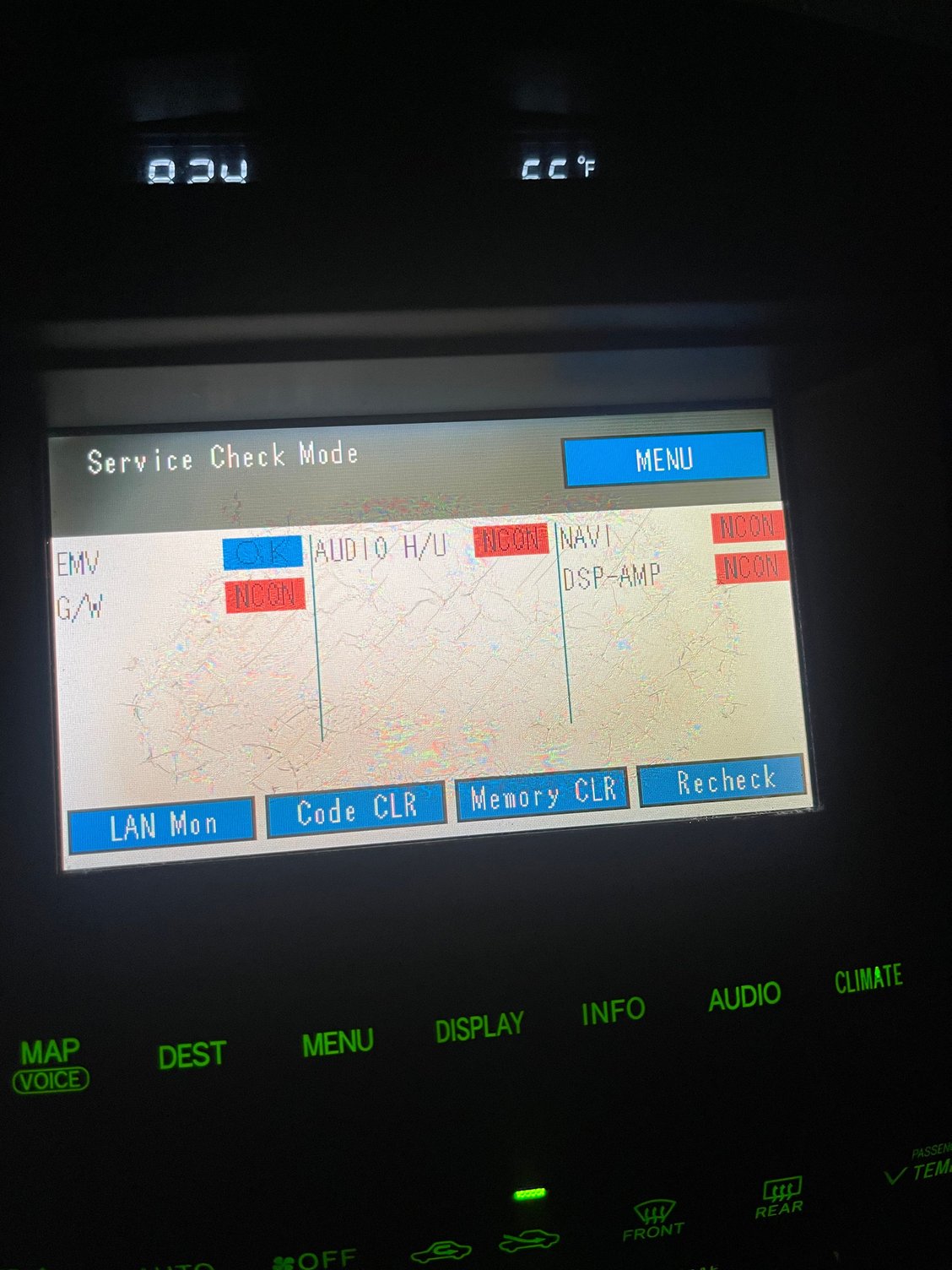

The first two pictures are when the engine isn’t on the second two are when key is turned over

Battery looks good, I would suggest swapping navi's if possible to see if its the unit itself.
