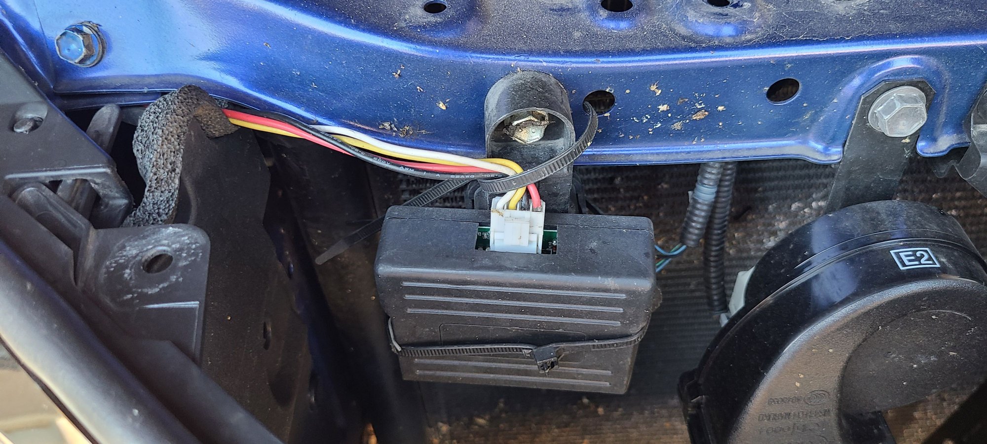

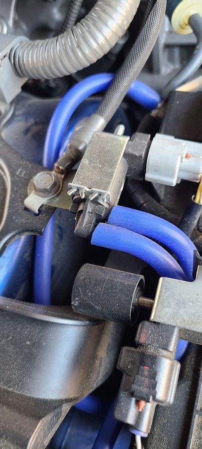

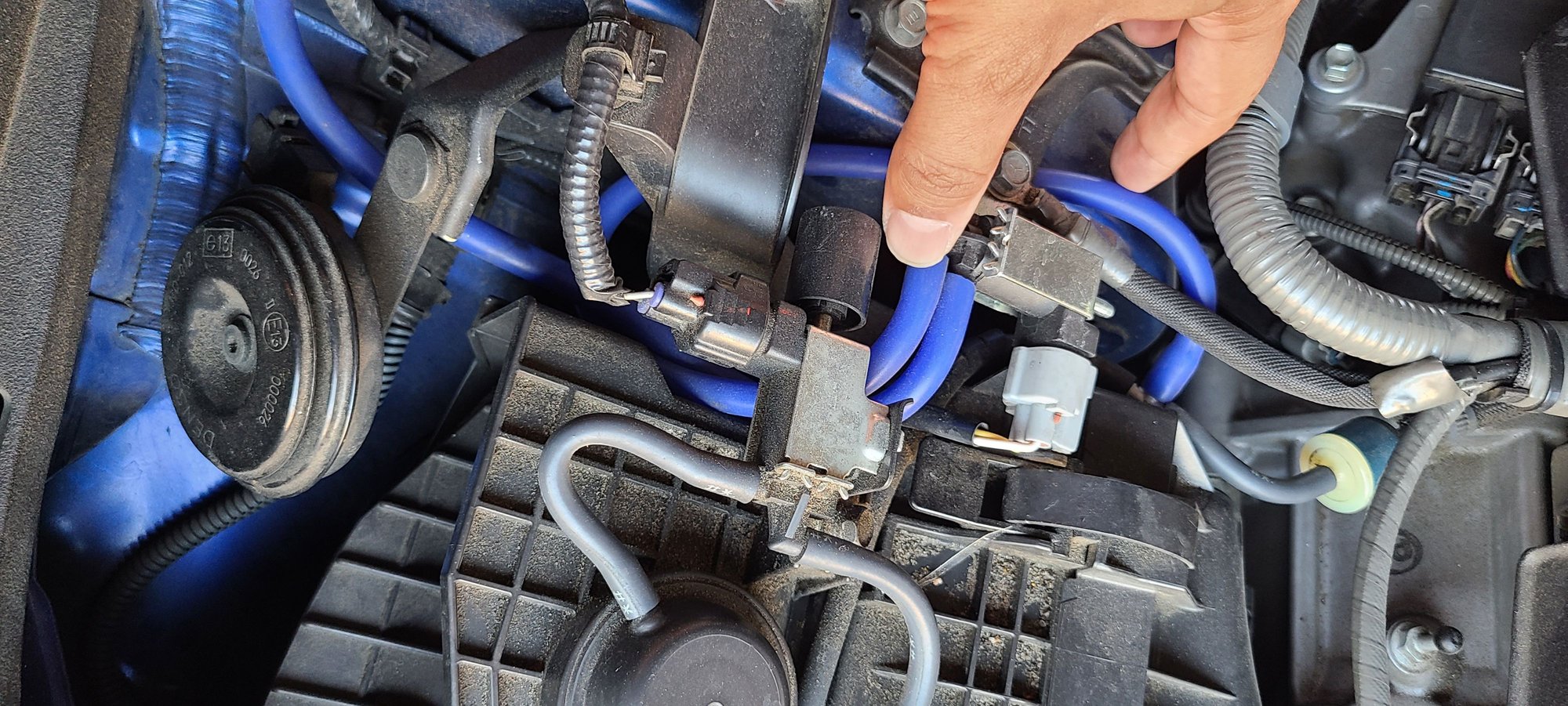

I ordered this kit from Amazon. Super easy to install. I control the valves via remote control.

Fantastic thanks very much for the detailed photos, looks like neat install! I think I will just go the direct plumb in like you did!
The GTHaus remote controller unit is identical to the one you purchased except yours has much better looking remote controls!

Thanks for the photos NotnFsport, I installed as per your guide and all worked well. Only problem I had was the GTHaus valves are normally open and only close when exposed to vacuum which makes the start up very loud!
I ended up installing a Dorman Vacuum canister which has enough reserve to close the valves when the ignition is turned on and before the engine cranks which makes it much quieter. (https://www.dormanproducts.com/p-5919-47076.aspx). This units fits perfectly behind the grill just next to the control unit.
